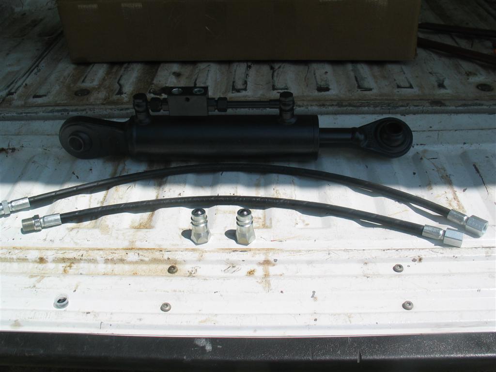

/ M5040 Hyd Top Link ?
#14
Standard Pioneer fittings will fit! They might have sent you Deere fittings instead. Go to Tractor Supply....
Ok... I think based on what you guys have said that I can get this remote installed.
Here are some pics of the rear remote, and also the kit that I was sent from CC&M.
I think I need the correct remote fittings, which I hope are the one in the TSC link below, and then all I should need are some 90deg fitting to connect the hose's to the top link.
Let me know what you guys think.
Stu
Pioneer 1/2 in. Standard ISO Tip, 3/4 In., 16 ORB, Fits All Current Models, Poppet - 1824180 | Tractor Supply Company
/ M5040 Hyd Top Link ? #15
Guess I'm a little confused. I thought your Kubota factor female remotes were not pioneer so I don't follow how buying the male pioneer fittings from TSC will work with them. If you replaced the rear factory remotes with female pioneer of the same size, that should work Then all you'd need is a male to male coupler to go between the top link and hoses, or between the hoses and the pioneer male QC's. I looks like the male side of the hoses CC&M sent you would thread right into the Top link block.
What I was trying to spec for you is the male QC's compatible with your factory female QC's but given the M set up is different than the BX, the one's I linked to at discount hydraulic hose might not work for you. If the female factory QCs have Snap Tite 72 Series embossed on them, then the one's I linked to would work.

It's become apparent to me that the factory rear remotes are not Pioneer.
The only marking on them is "Parker 0312-001"
I guess I will just have to see what my dealer can set me up with.

the rear remotes on my m8540 accept 1/2" male pioneer fittings.

It's WORKING!
Just wanted to thank everyone who stated that the Pioneer fittings should work..... they did!
I went to the dealer this morning and took what I had and asked the service guys if this was what I needed.......they said it sure was..... I said OK.... show me on one of these M Models how to connect the Pioneer fittings.... they grabbed'em..... and popped them right into the rear remotes......... DANG........why doesn't it do that on my tractor???? I noticed on the tractor at the dealer that the couplings were springing free when they pushed the couplings in......hmmmmm.
I got home and saw that my couplings did not spring free like at the dealer........found my rubber mallet.... a few taps on the end of the couplings........and they were free.......then my Pioneer couplings popped right in place!
I went ahead and picked up some 3/8" double male hyd fittings to connect the hoses to the top link and got them connected.
I did have to grind a little bit on the top link so it would fit into where the top link pin is, and also had to use the middle hole on the tractor top link connection instead of the top one because the Hyd Top Link end is so much larger then the threaded top link.
Got everything hooked up and even though it was somewhat frustarting I'm glad it all worked out.
