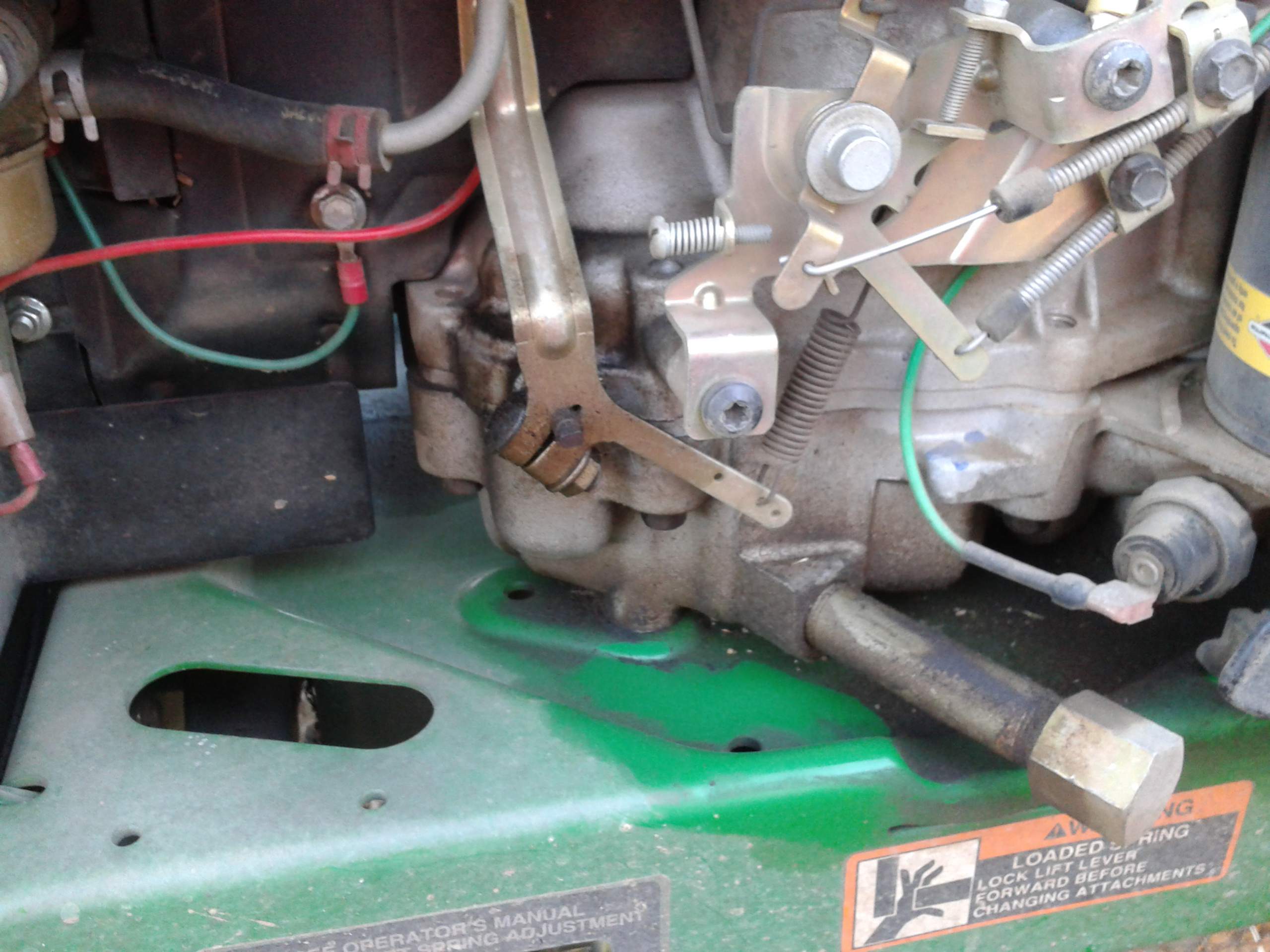

OK, number one, the mower sits outside under an aluminum awning type thing, not worried about fire risk at this stage.
Number two, I think I'm MUCH closer to figuring this out (I'm kinda slow at times).
I've benn checking out the suggestions made and it does NOT seem to be coming from the rear where the fuel tank is. I think it is a very slow seeping and the enclosed picture shows the "wet spot"... I had suspected this spot, so I wiped it and it came back over time.
Now I cannot seem to figure out WHERE it is seeping from yet...
Also, it seems to have developed a sharp left veer when I let go of the wheel...
Any ideas on either?
Thanks in advance,
David

I would not suspect a wet spot from gas, unless it is actively leaking. (It evaporates too quickly) I see fuel hoses, and the apparent carburetor float bowl, but they appear to be dry. Check your engine oil for any fuel contamination, or if it is becoming overfilled. That would indicate a leaky fuel pump. (If it is a mechanical pump, driven by the camshaft.) Mechanical pumps can leak into the engine oil, and also leak out the vent hole. (On the pump)
/ LX266 Mower smells like gas? #9
try spraying a little talcum powder (like foot spray powder) in the area you suspect and see if it shows any traces of liquid.
ba

Well I moved the mower to the carport and NOW I have found a tiny wet spot underneath and there is clearly some sort of leak in the fuel line or similar. There is gas seepage on the undercarriage of the mower and it would be leaking ontop of the mower deck if it was still attached.
I'm ging to have to take the seat, body, etc off and try to find where the fuel line is damaged...

With the help of a buddy (I needed at least 3 hands) I fixed the gas leak on Sunday.
The problem was the fuel line had cracked under the body, near the seat. It had dried out and about a 12" section in the middle was cracked like a desert mud flat...
So we replace the entire 5.5' of fuel line from the tank to the carb.
We also replaced the drive belt while we had the mower apart anyway.
Thanks for all the advice.
This one got fixed finally.
