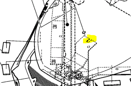

I can't really see in at all. I've got it up a little more, maybe another 2 inches by rocking it back and forth by something is certainly catching. I just can't get the hood up. Are there any help diagrams that I can look at??
Edit: I found this.
I'm not sure if it's 130, or 140 or A. There's a bar, highlighted in yellow. Not sure if it's that or not. Are those side grills removable?

The hood latch on my LX3310 hood is actuated by the 'Mascot' emblem on the hood via a round bar that engages the solid-mounted pin I circled in red. The actual latch (which I dont see a good picture of in that drawing) is like 2 opposing J's that once pushed over the pin spring together and lock the hood down. The (2) side panels on the hood front are removable, however the clips are accessible from the inside

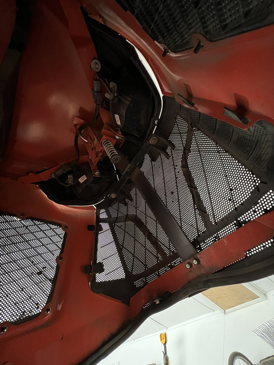

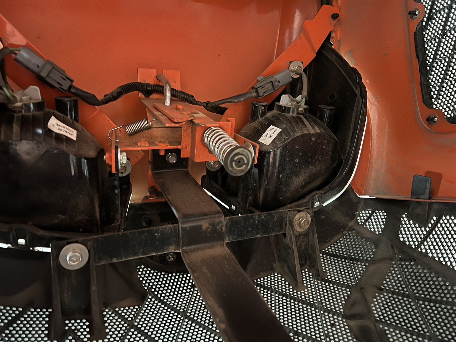

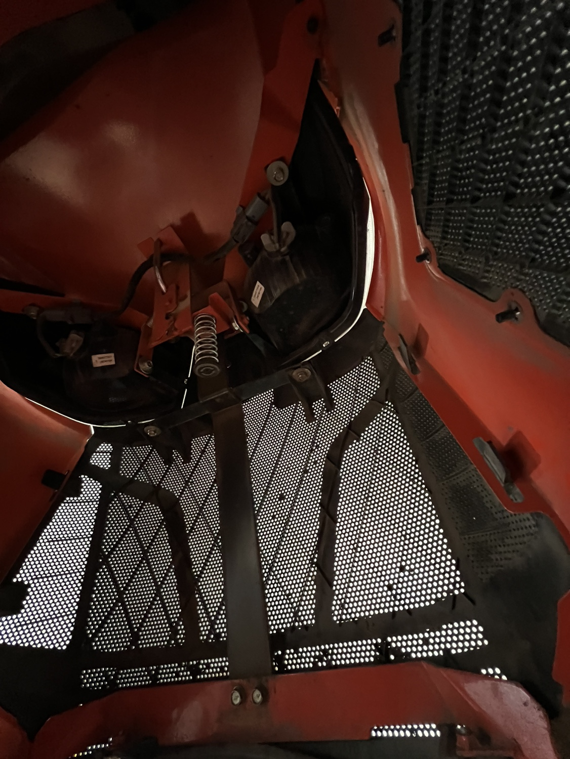

worst case, you sacrifice one of the front side vents by prying it off. It has ~6 pins on the back side that are retained by small speed clips. It you pry it off carefully you may break a few of the pins but may still have enough to retain the panel in the future. Worst case is you buy a new small plastic panel. With a panel removed you can view and reach the catch mechanism that engages the pin I circled in red above. My guess is that something has caused it to not fully release.
/ LX2610 Hood will not open #12
if it goes up a couple inches I doubt it is the clamp holding the pin. most likely it is the linkage that articulates and over centers to keep the hood up catching on something. Can you prop it open and get the side panels off to get more access.

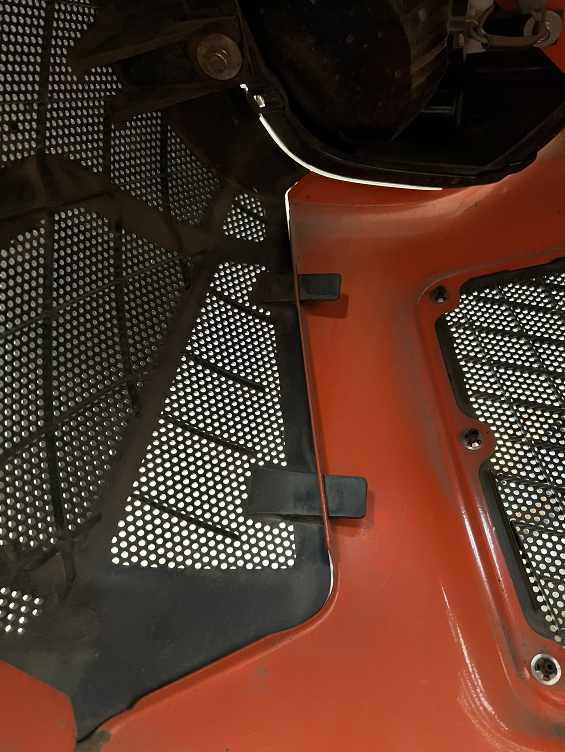

It may be catching on the cowling, or the firewall. Try pulling slightly forward as you lift. this may provide enough clearance to allow the pivot.

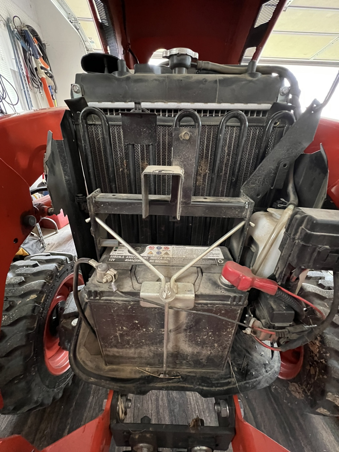

nice pictures, can you get a few shots of the linkage that holds the hood up. I think that may be where the problem is since he said the hood opens a few inches then blocks

Guys- thank you for your suggestions, all are were good as well as the photos. My friend just left, it was a simple fix and a foolish mistake on my part. I must have not attached the hood prop as it was catching in the lip of the bottom side of the hood. We were able to reach in and clear it.
