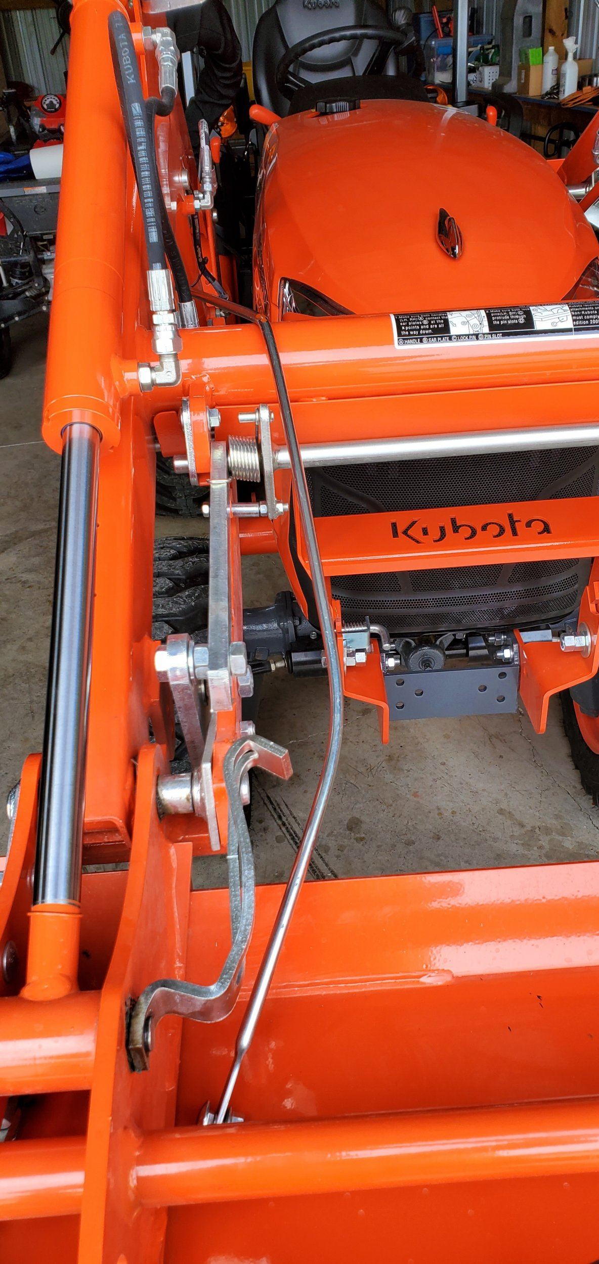

Purchased New, brought it home within 15 hours oil pan started leaking, dealer fixed.......within 25 hours FEL compression fitting sprung a leak, dealer fixed. Last week wife found a nut on floor in the barn (didn't think anything about it), Friday found a new 1.5" carriage bolt near the barn door, did a quick look around the tractor nothing. Today, 1st time actually loading material (gravel) other than mulch, FEL level indicator bar came flying off and here's the result and I know now where the nut and bolt came from😡.......I never had any problems with my BX beginning to wonder if I made the right move

Interesting.
I also noticed your dust seal on the cylinder came off.

Not a dust seal. It's a protector to keep paint chips from getting under the dust wiper that's still firmly in place in the cylinder gland. Thinking this is a problem is a common error.

Other than the oil pan leak I believe your other problems have all been dealer set up problems. The dealer should probably address them with his set up crew. You could try having them go over their setup procedure with your tractor. They may have missed a few other things. If they're unwilling check the torques on your wheels, loader, and any other critical locations.

I just blew up the picture and saw the hood and cowling damage! That one improperly tightened bolt on the level indicator that was lost caused all that!?! Would not be surprised at $1,000 damage.

Luckily no other damage......I think you might be seeing reflections, I hope anyways!!
