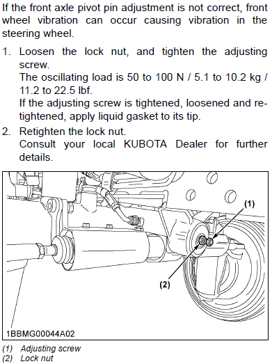

Do it anyway. Once the front pivot becomes sloppy, it will impact steering and the life of the pivot and you don't want to replace that, it's quite expensive.
Simple to do actually, you need to lift the front of the tractor with a jack so the front axle swings free and then loosen the nut on the bolt that is sticking out the front and run the bolt in until it's hand tight and back it off 1/4 turn and tighten the locking nut.
if you have an owners manual it should tell you that procedure. If you have a front end loader on the tractor, you can use the FEL to lift the front axle off the ground and then adjust the freeplay. What I do, only takes a minute to adjust.

What you typed looks easy, reading the manual it is a little confusing...
Adjusting front axle pivot (4WD)

Disregard the 'liquid gasket' entirely, it's not germane to the adjustment so long as you don't completely remove the bolt. Takes me about 2 minutes to check and adjust mine actually and I would be surprised if there weren't any blanking plugs in the pivot casting or grease fittings. Never seen one without but then again, mine are a lot bigger than yours is.
