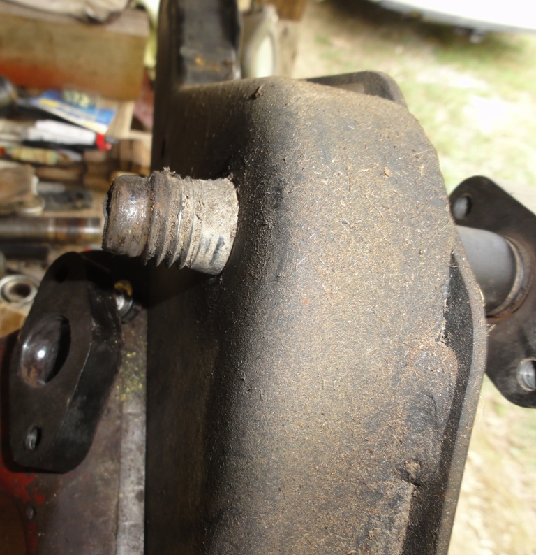

This is what happens if you never grease the spindles at all and they get frozen up.
This is the old style axle with no spindle bushings at all and uses the straight tie rod.

I sure hope this comes with the 2 supports because my are shot, especially the front one...
When you turned the wheels you could see the axle loose end play in all directions.
For any that does dot know the axle is supposed to pivot up and down, but no other direction.

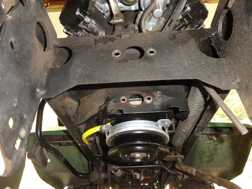

With the muffler off and looking back underneath this is what the front end mount looks like.
The two bolts right next to the PTO clutch are hard to get to. And these 4 flanged bolts are not metric. (5/16-18 x 3/4" grade 8.)

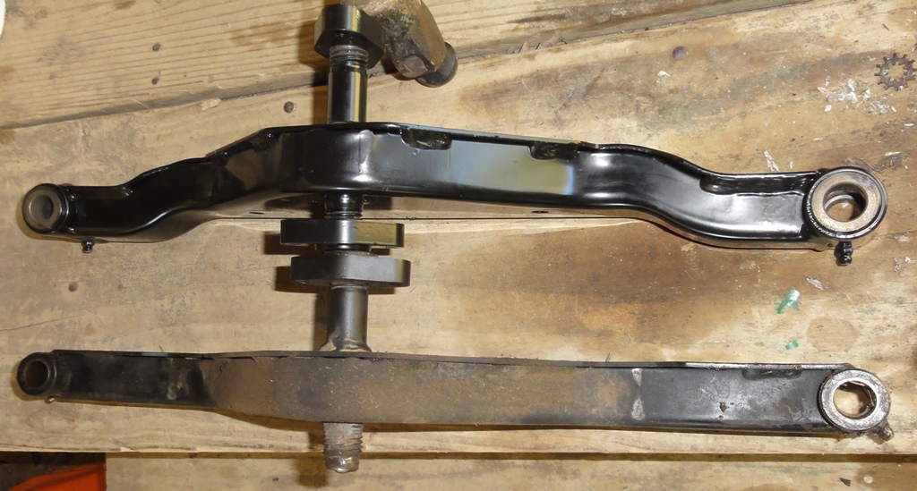

The new style will indeed fit but it is made different.
You can see why the new style needs the crooked tie rod, because the axle is formed to offset forward.
The wheels actually sit about 1" farther towards the front.
I did have to readjust the drag link out to compensate for this offset.
If you jack your front up and wiggle the axle sideways you can see if your supports are worn out.
The problem is that it wears the shaft worse than the supports.
This is not a good design IMO.
The new one here is a # AM119108 and it did come with both supports, 4 spindle bushings and grease fittings.
