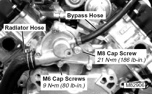

Can anyone tell me the torque required for the bolts on the water pump? The tractor is a John Deere LX178 garden tractor, engine number FD440V004089. The bolts are (JD part number) M6 X 45 (19M7834), M8 X 12(19M7864), M6 X 80 (19M8145) Thank you for any help provided. Scruffy

This should help.

Great thanks, that's what the dealer told me also but the 186in/Lbs seems too much thought they were wrong but I guess not.
/ LX178 Water Pump #4
Remember the spec. is given in INCH pounds, NOT foot pounds.
Ken
/ LX178 Water Pump #6
You don't really need a conversion calculator. 12 inches in a foot so divide in-lbs by 12 and you have ft-lbs. Pretty easy. Not trying to be a smart-arse here...just trying to keep it simple.
