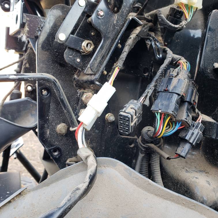

There is an obd2 on the right side by the throttle pedal. The dealer told me that use a specific plug for there diagnostic tool and not the obd2.
Are you sure that you understood him correctly? The one in the cab is diagnostic and programming. They do use a specific interface between the obd and the laptop.

On new holland models the plug is used for both but on the ls it is a obd2 with only can communications.

On your boomer how many wires go to your diagnostic port. I assume you have the standard 9 pin connector but wonder how many pins are used
   / Ls xr3135 diagnostic port? #14
4 pins are used.

Which 4 are used?

Is this the one you are looking for? Lower right side console.20191225_093254.jpeg

CAN high and CAN low is what is used for diagnostic and programming.
As far as pins, it is A, B, C, D.

I am asking because I have access to a new holland dealer scan tool. Ls and new holland use different plugs and when I asked the ls dealer that told me there is a different plug thay thay use and not the obd2. Thay said obd2 was just thare because it was mandatory.
