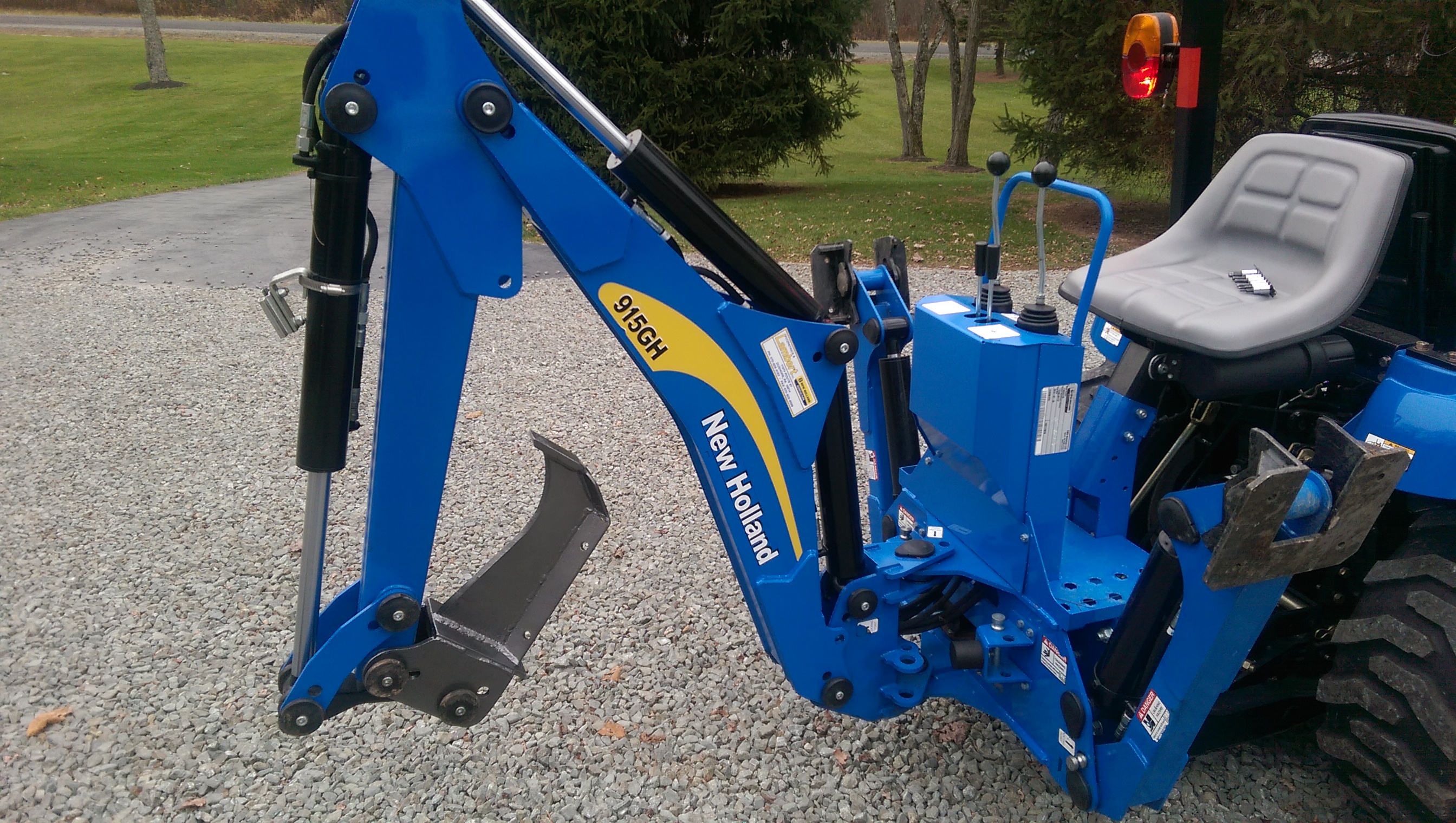

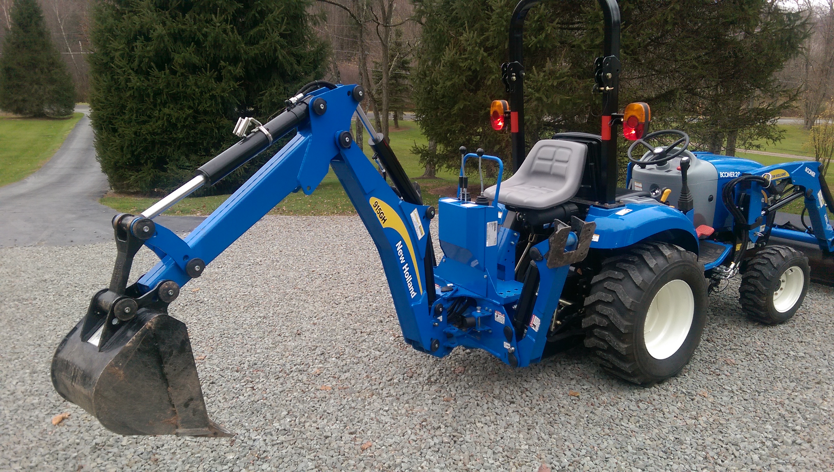

Brotek probably has a ripper tooth that will fit. If not they will make one for you. They didn't list a ripper tooth for my Boomer 20 but it is the same backhoe as a MF CB65 (which they make a ripper for) so it fit perfectly. I used the ripper for trenching 250 feet to lay some cable and it worked great. I know that the boomer 20,24,and 25 are the same tractor as the LS so possibly the backhoes are the same as well.

Nice looking ripper. How big of a mess does it make? Can it actually make a narrow trench or does it close back up like using a sub-soiler?
I only trenched about 8 to 10 inches deep. I dug down with the hook to loosen the soil then while the ripper was still in the ground I curled the ripper till it was perpendicular with the ground and used a lifting and sideways motion to clean out the trench. It worked very well but is kinda hard to describe. They also make trencher wings that bolt onto the ripper to clear a wider path but I did not buy them. I actually got this ripper for tearing out roots when removing stumps.
/ LS XJ2025 backhoe bucket. #10
Thanks. I need trenches on occasion but also want to cut the roots on tree stumps. Sounds like good choice for a multi-tool.
View attachment 551153View attachment 551154
Great idea, I'll look them up. Thanks!
