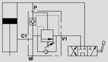

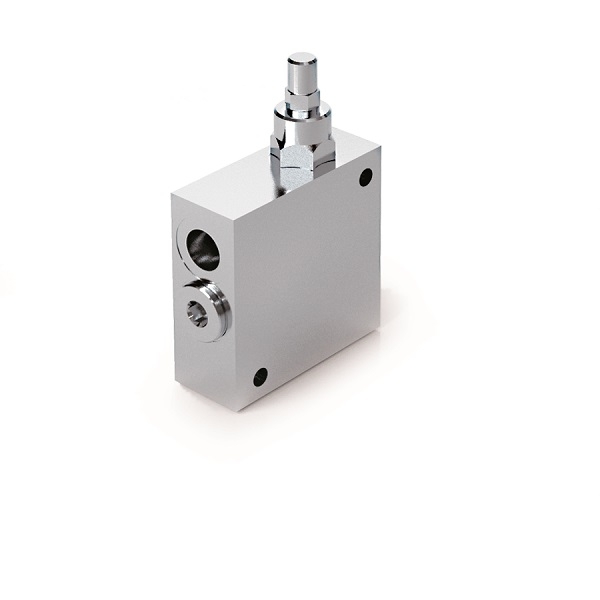

Has anyone added a flow restrictor valve to cure this problem?
Would you recommend the valve you used and was one needed on each bucket curl cylinder?
Thanks.
/ Solving the “Floppy Bucket” by adding a flow restriction #2
/ Solving the “Floppy Bucket” by adding a flow restriction #3
That is correct, you only need one on the hose from the valve, and it does help floppy bucket syndrome. The one recommended above is good because it is adjustable so you can dial in the amount of restriction you need, instead of having a fixed non-adjustable orifice, and is one way so it does not affect flow in the other direction. Changing the hydraulic filter regularly and running at full throttle helps also so you will have maximum hydraulic flow. The problem is caused by cavitation in the bucket cylinders when hydraulic flow does not keep up with demand when dumping the bucket. The restrictor prevents dumping too fast so that it does not cavitate.
