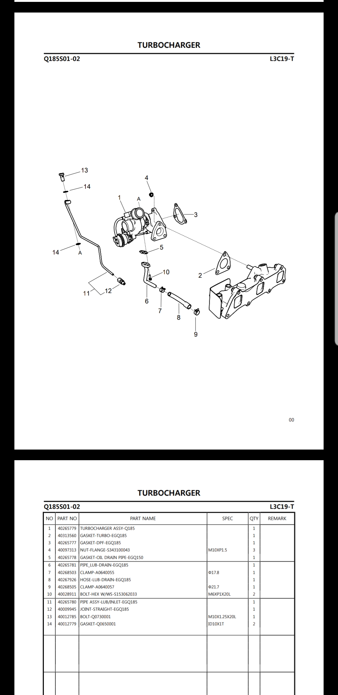

Does anyone know if adding a turbocharger is an option on these three cylinder diesels?
They've already got one. The cutest little baby turbo I've ever seen. Did you miss it? I wouldn't hold it against you if you did. Or do you mean add an additional turbo?
