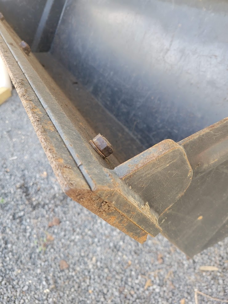

yes, 66" bucket, yes factory holes
In 2020, the PN was 40381448 and the cost was $246
it's mounted in this pic, been on since day 1.
Ok. I see most tooth bars and cutting edges have pre drilled holes, but wasn't sure if the hole spacing is universal or what. I am just looking to strengthen the bucket. I've read that they are kinda flimsy and easy to bend without reinforcement. Thanks again.
/ LS MT240E #12

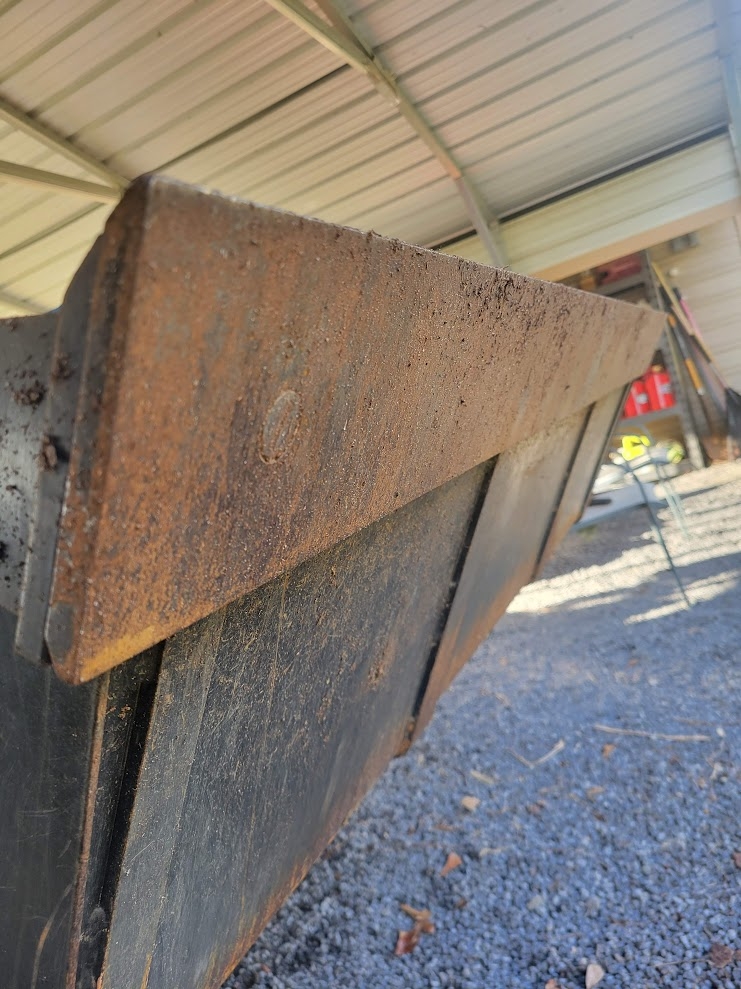

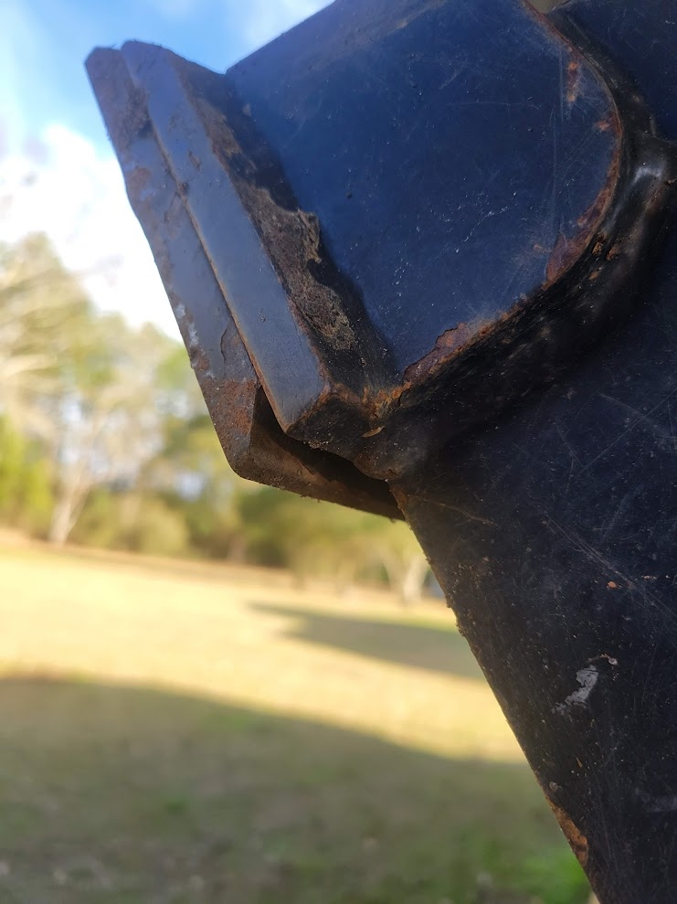

Went and took a few specific pics. This is an LS part, as far as I know the different tractor manufacturer bucket holes aren't universal. If they were, Piranha, EA, etc, wouldn't need to ask for precise measurements. This LS part is also reversible, with a new cutting edge on the back side, so it can be flipped if you ever need it. I'd say this really strengthens the bucket in my opinion. It doubles the thickness.
