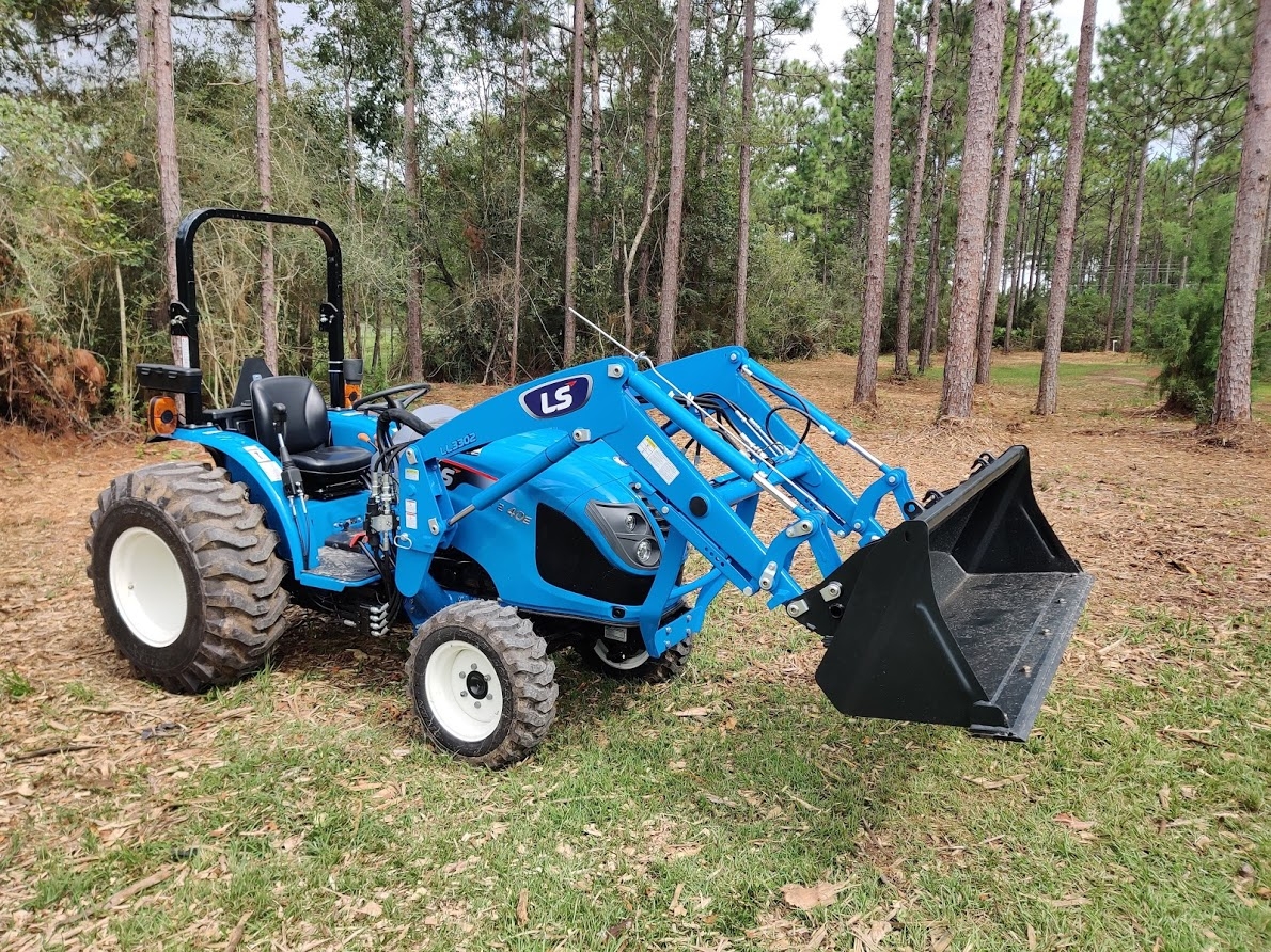

yes, 66" bucket, yes factory holes
In 2020, the PN was 40381448 and the cost was $246
it's mounted in this pic, been on since day 1.

Ok great. Thanks. I greatly appreciate it. Bolts included as well?

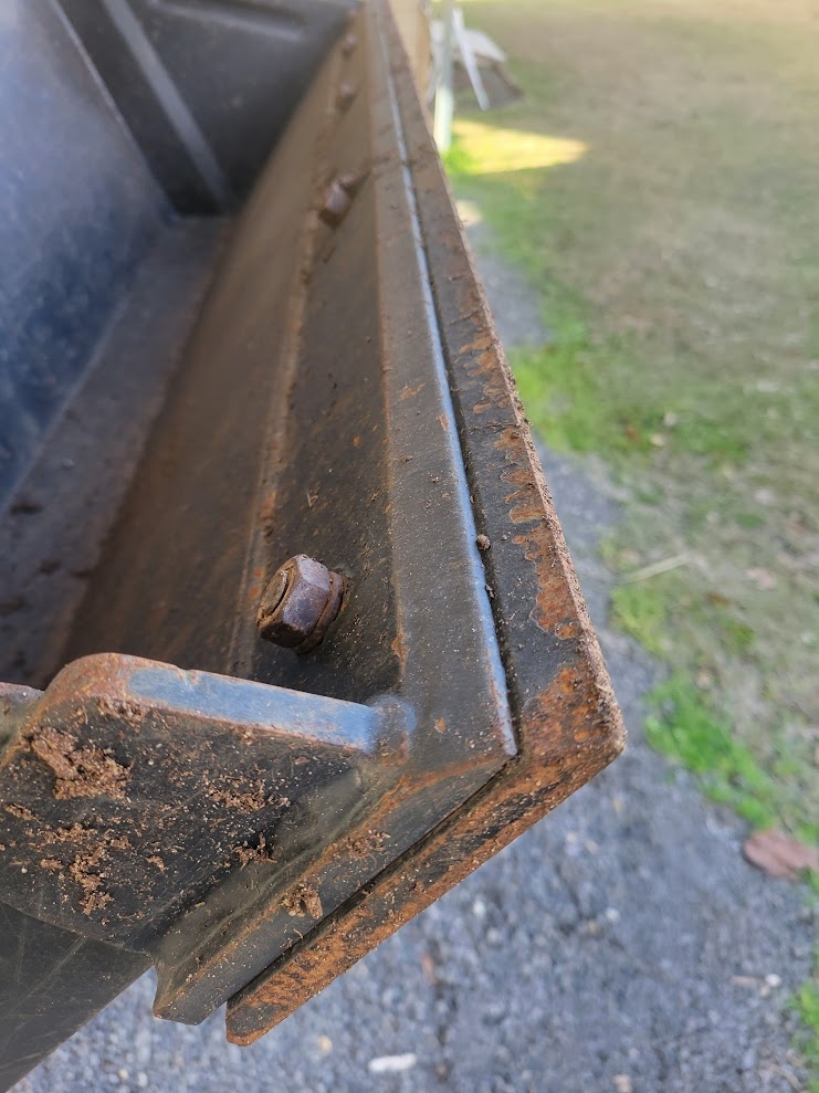

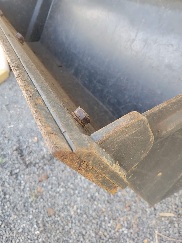

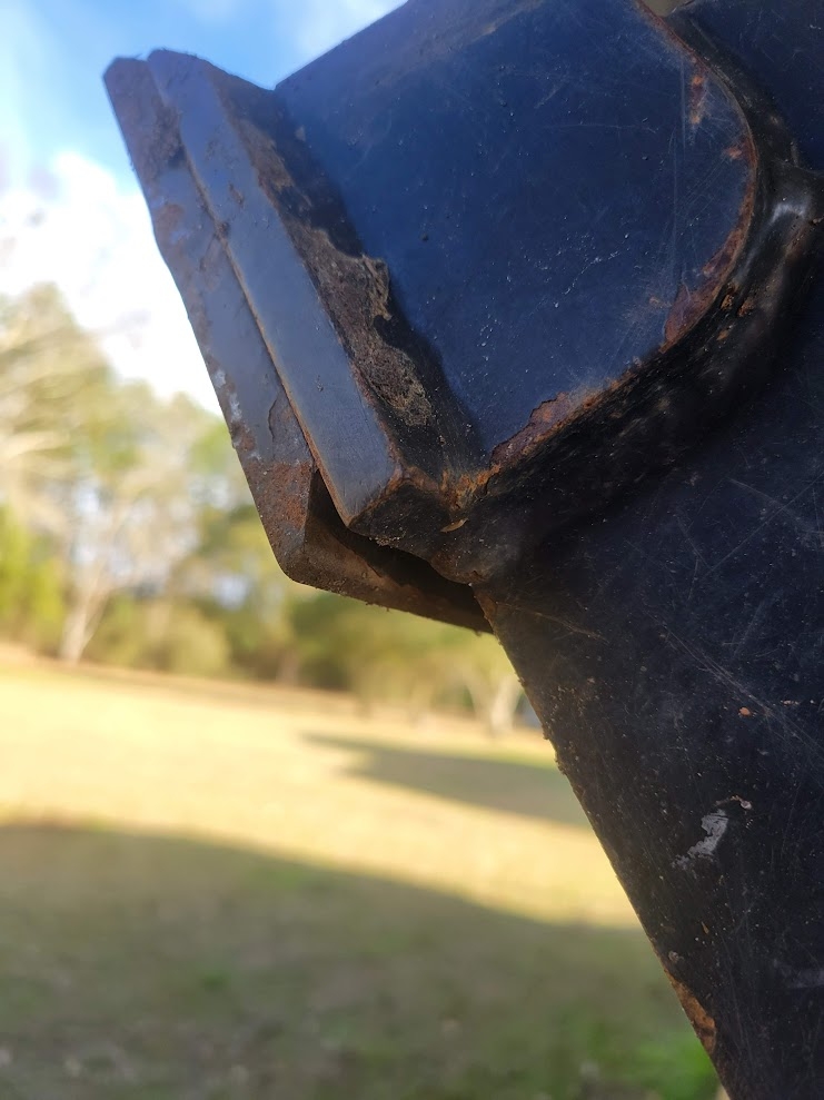

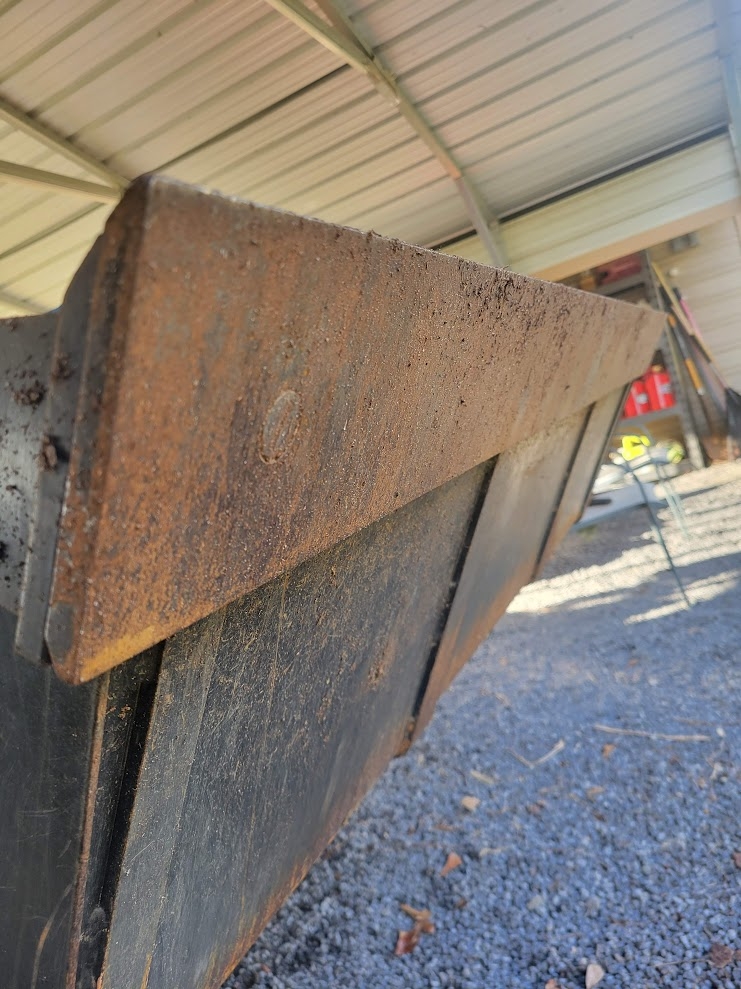

Went and took a few specific pics. This is an LS part, as far as I know the different tractor manufacturer bucket holes aren't universal. If they were, Piranha, EA, etc, wouldn't need to ask for precise measurements. This LS part is also reversible, with a new cutting edge on the back side, so it can be flipped if you ever need it. I'd say this really strengthens the bucket in my opinion. It doubles the thickness.

Awesome, I greatly appreciate it. I will have to ask my dealer if it's in stock. I would like to get it on before I use the bucket. I would hate to bend it or something before I got it reinforced. Thanks again.
