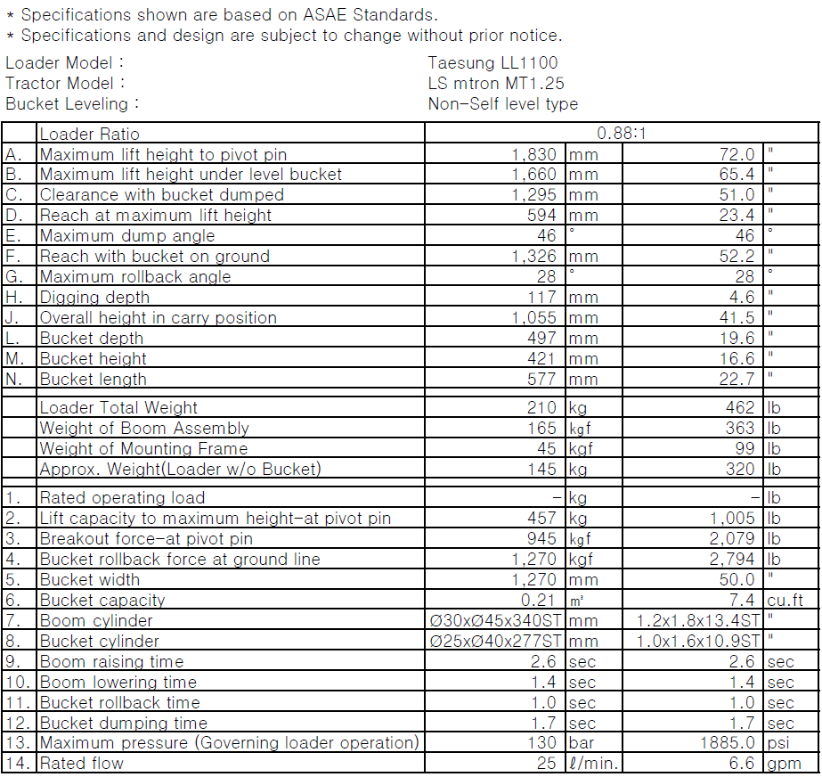

I looked at the LS MT125 last night, and the lifting power wasn't that much more. One thing I noticed is when they did the lifting power of the FEL, they didn't say at what height that is. If that is at the ground level, 5 feet or max height. Kubota is pretty open about that. I have attached a PDF that shows the lifting stats and the second page is the lifting curve on a graph. The lower it is, the more power it has. FYI - it is in kilograms, not pounds. :)

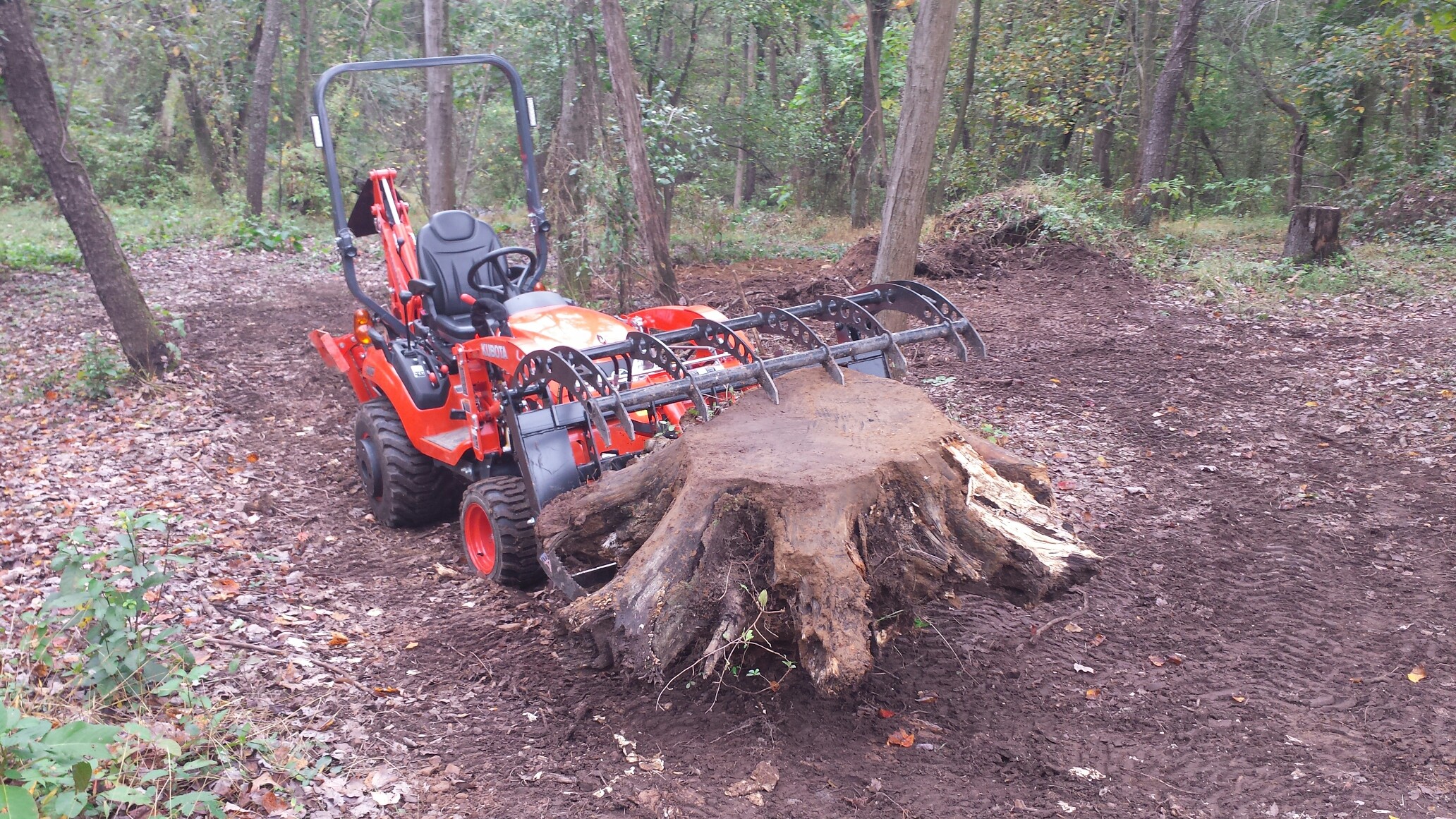

Here is a pic of a stump I moved today. It is a giant poplar tree stump. It was the max my BX could do, and that is as high as I could lift it. There were a few other stumps (oak trees) that I could not lift, but I clamped onto them with the grapple and drug and pushed them to where I wanted to. If you are patient, you can pretty much do whatever you want. :)
The LL1100 loader for the MT125 manual says 1,005 lbs at max height (72") at pivot pins. That is 457kg.
Thanks for that. I didn't notice that on the website last night, unless I just plain missed it. :)
Makes a bit of sense since the Kubota has a 1.57" bore and 12.8" inch stroke, and the LS has a 1.8" bore, and 13.4" stroke. Bore allows more force for the same pressure.
