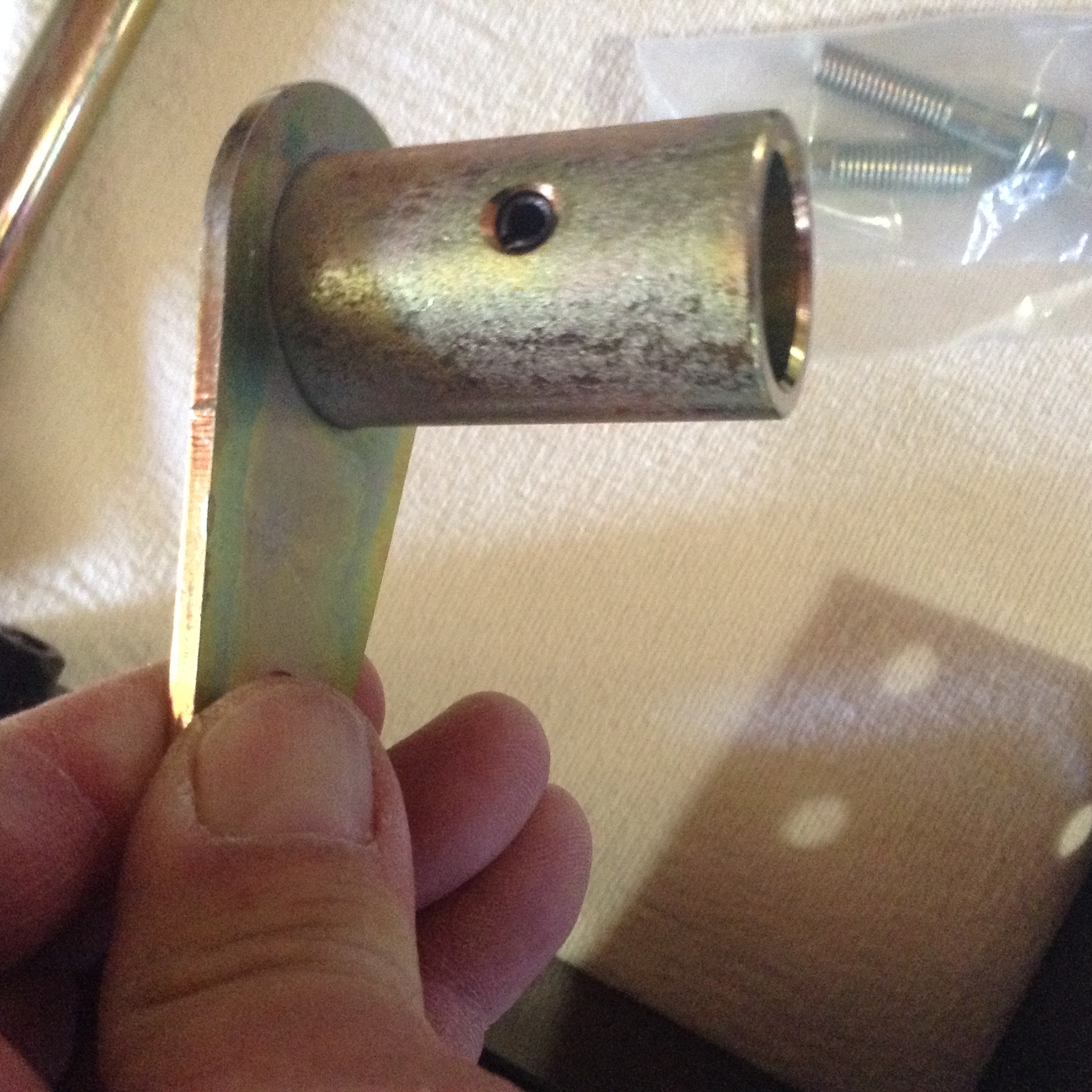

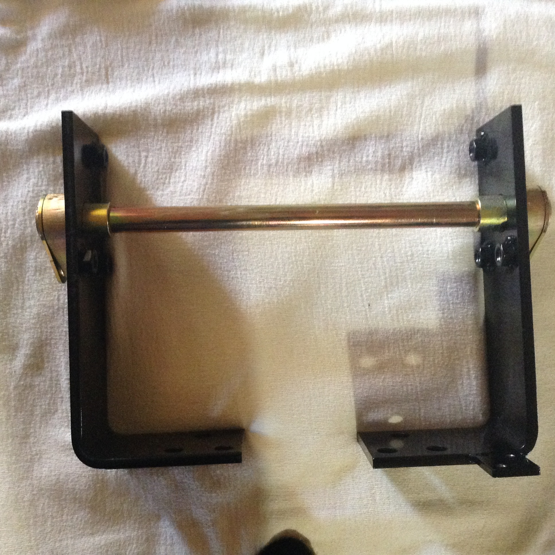

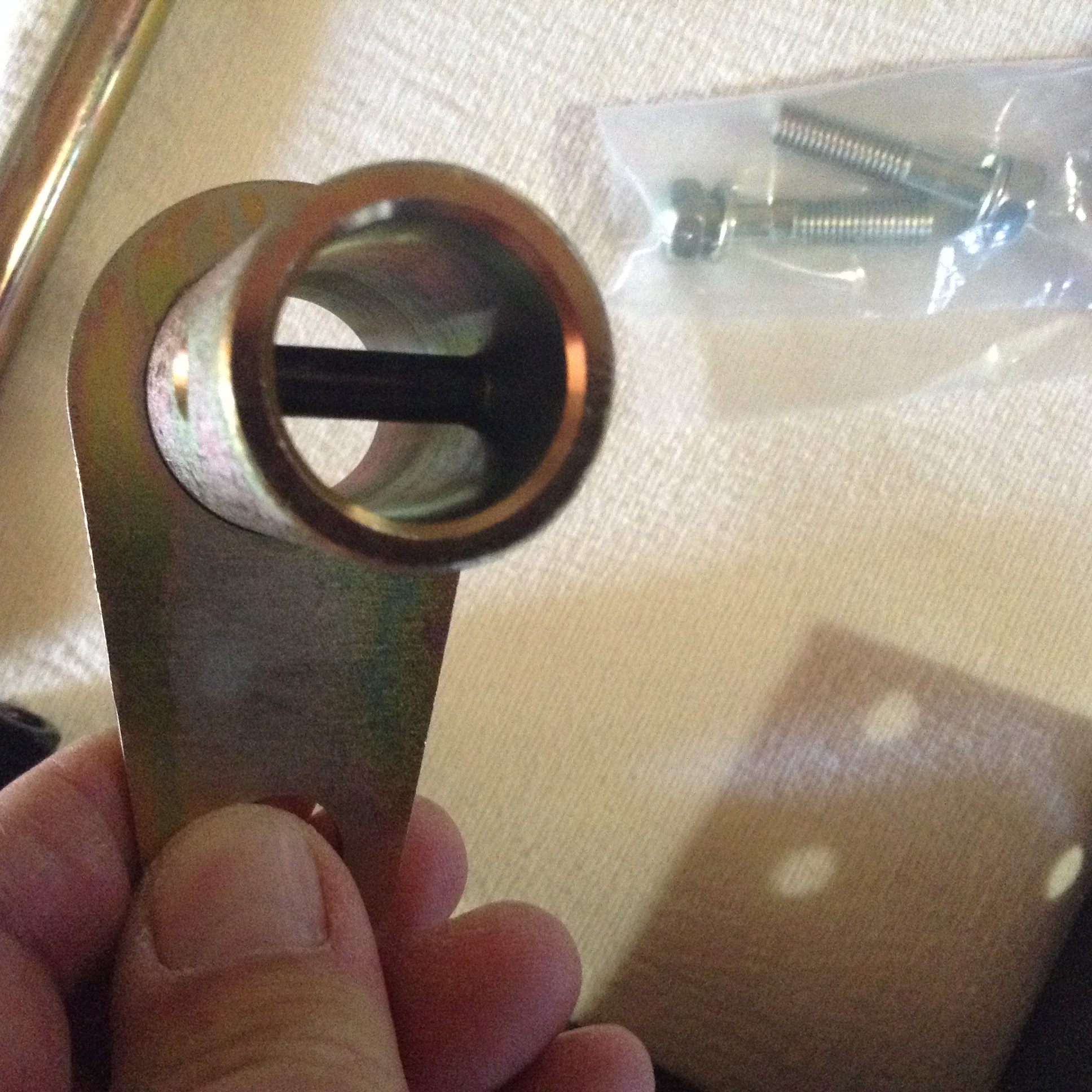

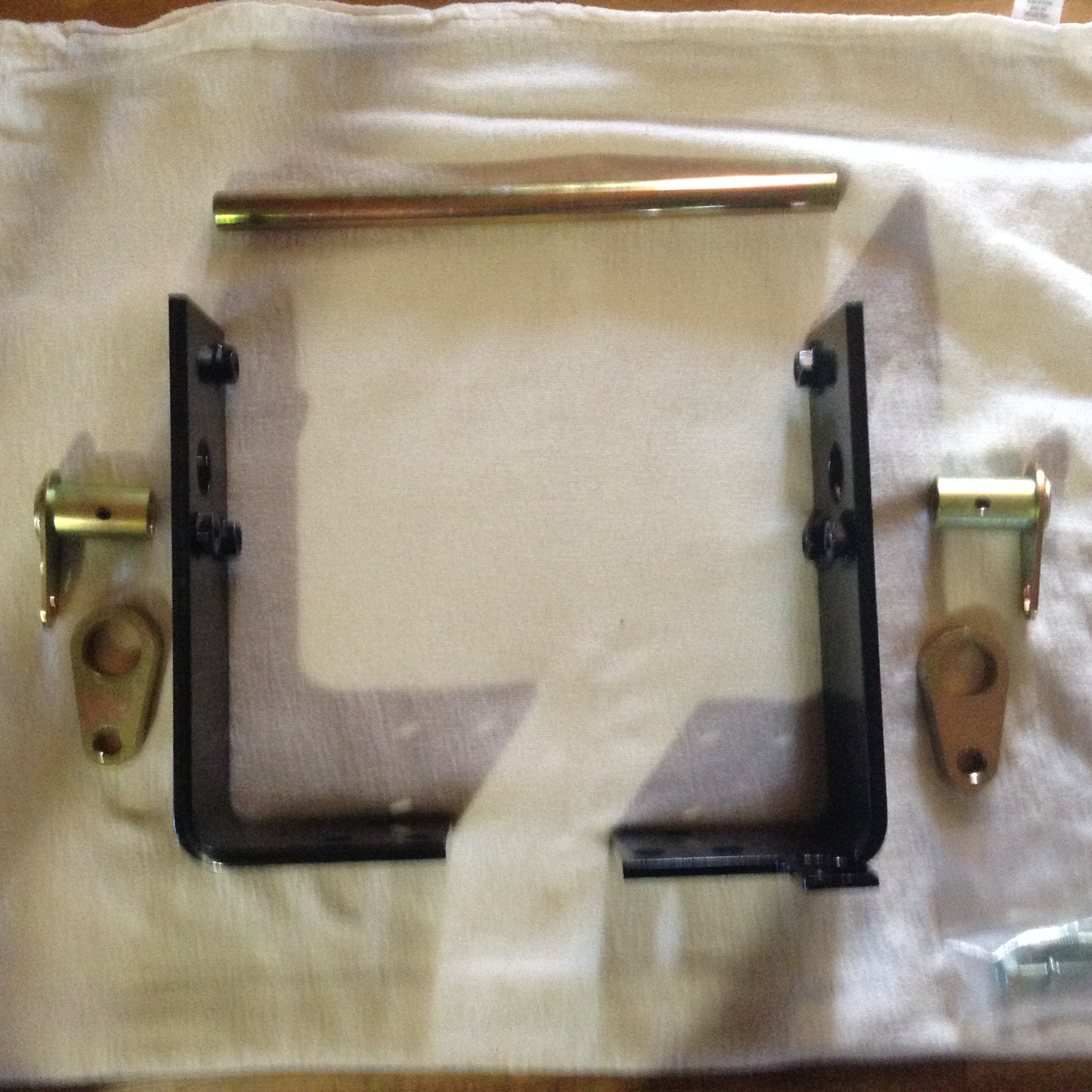

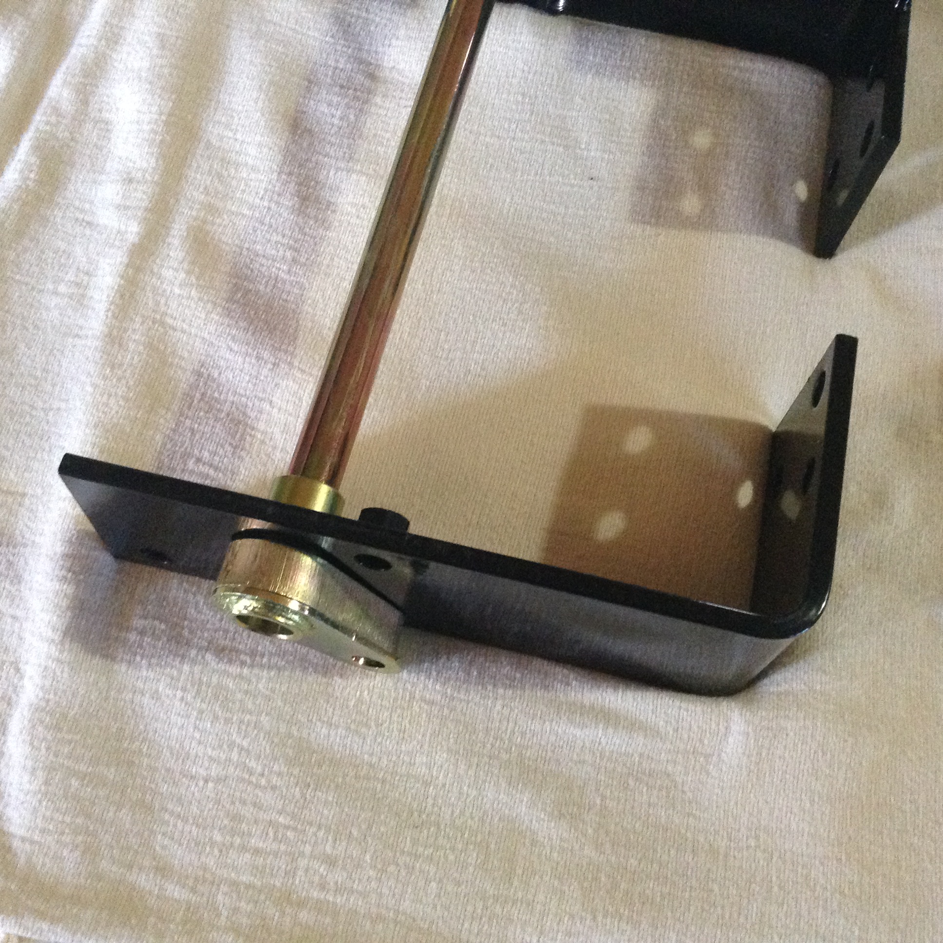

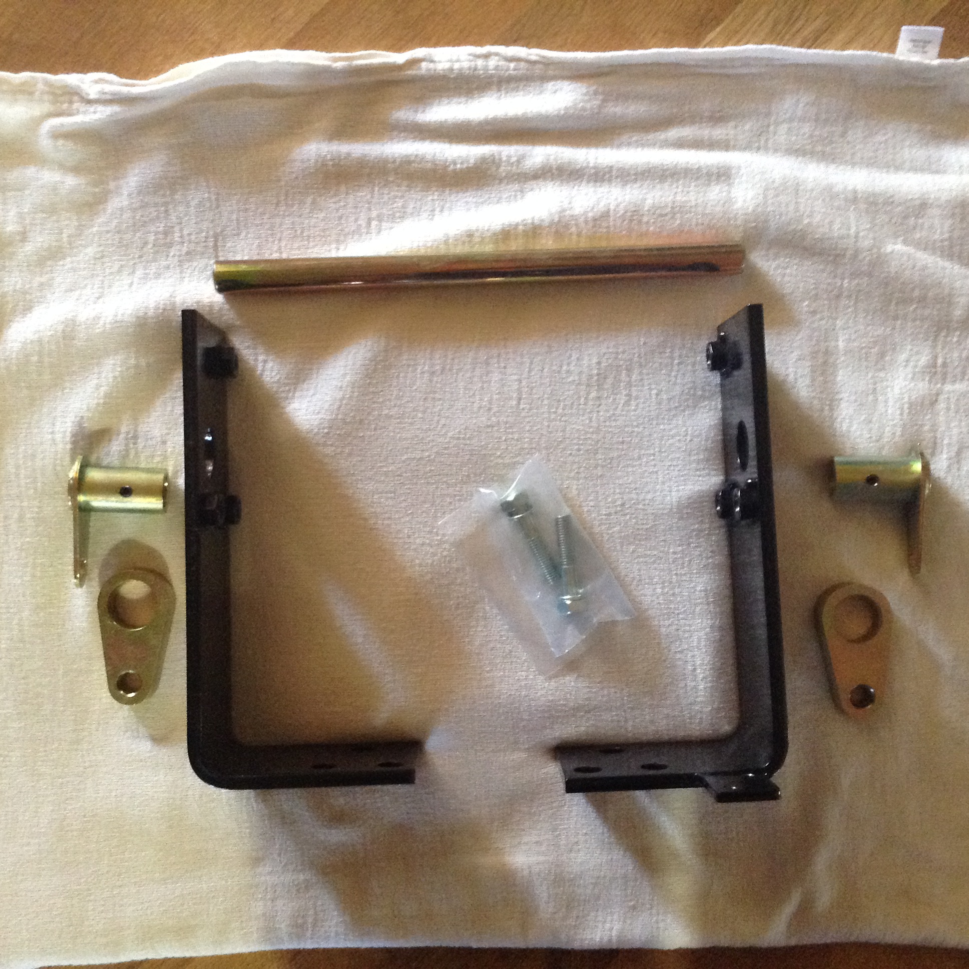

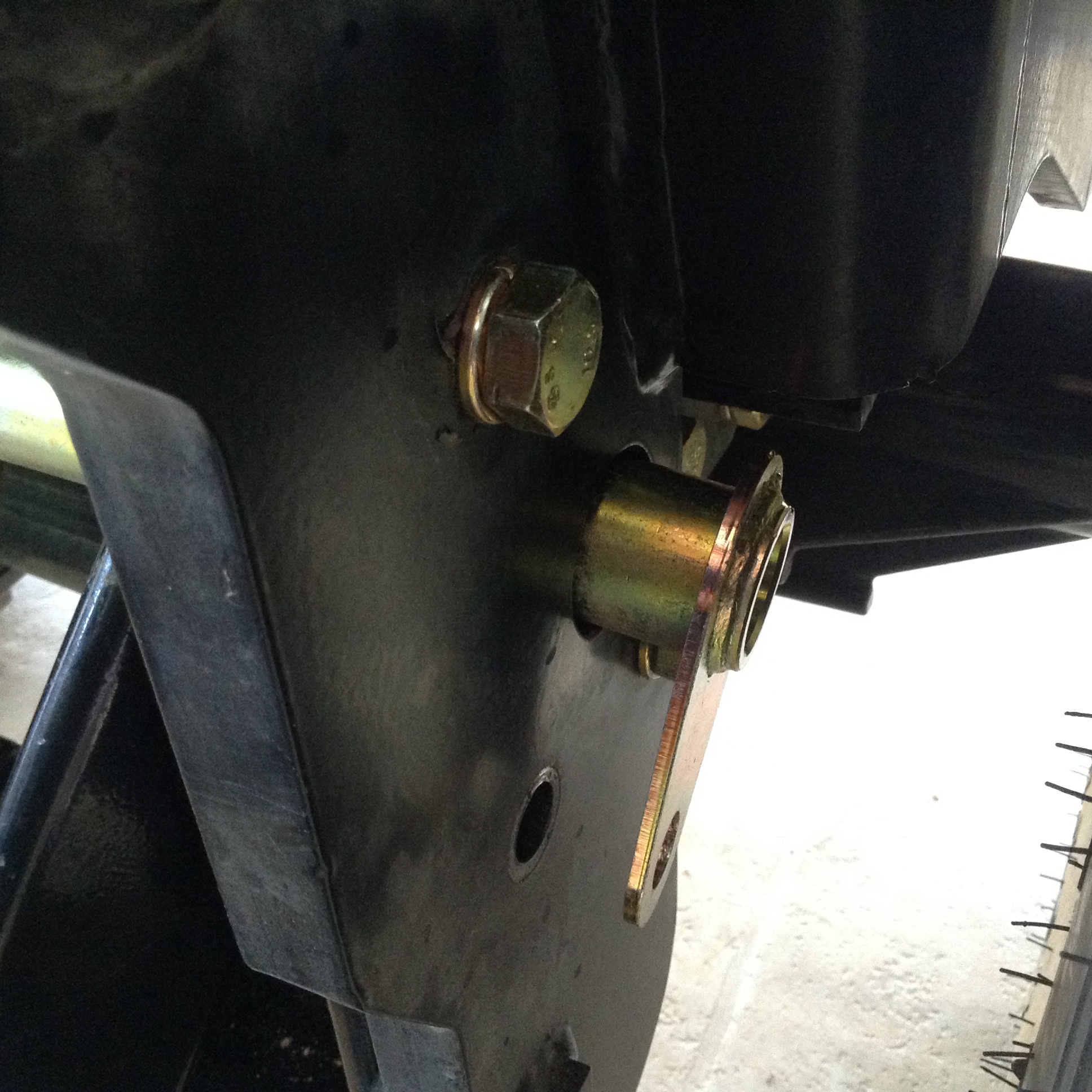

Well, finally received the LS factory fix :thumbsup:for the 3 point issue (having to remove rear tire). Attached are pics of the parts. They allow the lower link / stabilizer bar to be easily removed or installed by loosening and / or removing 1 bolt. :cool2:
The stock lower brackets (drawbar) are removed and replaced. There are 2 spacers, and 2 "pins" (bar holder), and a new bar. The "pins", spacers, and bar are held in place with 1 bold on each side. There is a roll pin in each side of the "pins" to center the bar.
I have not been able to install it yet due to having knee surgery just 3 days ago. (Parts came day of surgery :mad:) I will update with pics of the install when I can get to do it, hopefully in a couple of weeks.
There are individual part numbers as well as the "kit" number:
Kit: 20147916 Lower Link Kit - hinge - MT 1
Shaft-lower link- TRG896. #40369512
Spacer-lower link- TRG896. #40369430
Pin-lower link- TRG896. #40369516
There was no part numbers on the brackets
My dealer told me that LS is not considering this kit as a "fix" or "update", there is no "service bulletin" issued. The kit is listed as an "upgrade", available for purchase. He said LS initially wanted to charge $150, but lowered the price to $75. He wasn't sure what other dealers may charge for it. My dealer said they paid for it "because it was the right thing to do" and didn't charge me a thing.

They replace the existing "L" brackets that drop below where the 3 point is, they drop down and another piece (existing) is bolted across side to side horizontal, where you could mount a trailer ball. A big U mounted to the sides of the BH subframe.

This is a specific fix for th MT 125. In order to put on the 3 point arm and stabilizer brackets, you had to remove a tire in order to have enough clearance to slide the bar out enough to put the bars / brackets on. Same if you had to take them off in order to put the BH back on. This setup allows the 3 point hardware (arms, brackets) to be put on / off in a similar manner as your XJ. Instead of cotter pins on the bar, this has "cups" that are bolted to the side of the frame.

You don't need the spacers if you have the backhoe subframe in place. You would only need the lower link rod (I can't see why the original could not be cut down and made shorter) and the 2 "pins". I am going to be installing the kit today and post the results later today or tomorrow.
/ LS mt125 3 point "update"
#19

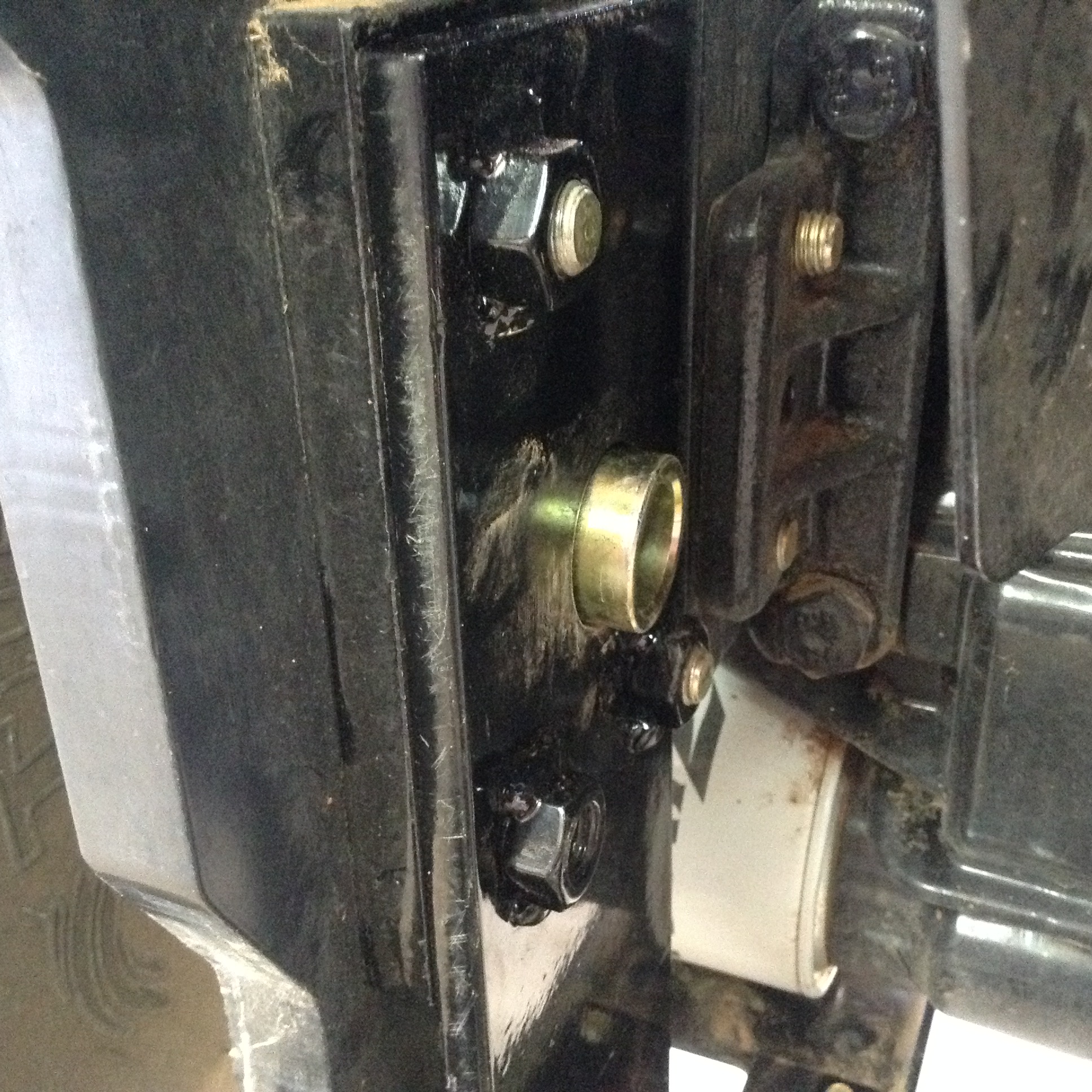

Well, update on the "kit", the new brackets are a necessary part of the fix. The original brackets have a sleeve welded onto them. The pins will not fit into the original brackets. The original sleeves could be cut out of the brackets, I would think, if needed to adapt them. There was no part number individually on the brackets, only the main kit number.
As the workability of the kit, loosen one bolt and the entire 3point assembly will come off, goes back on in about 30 seconds....much easier than taking off a tire!. I'll post some pics later this evening.
#20

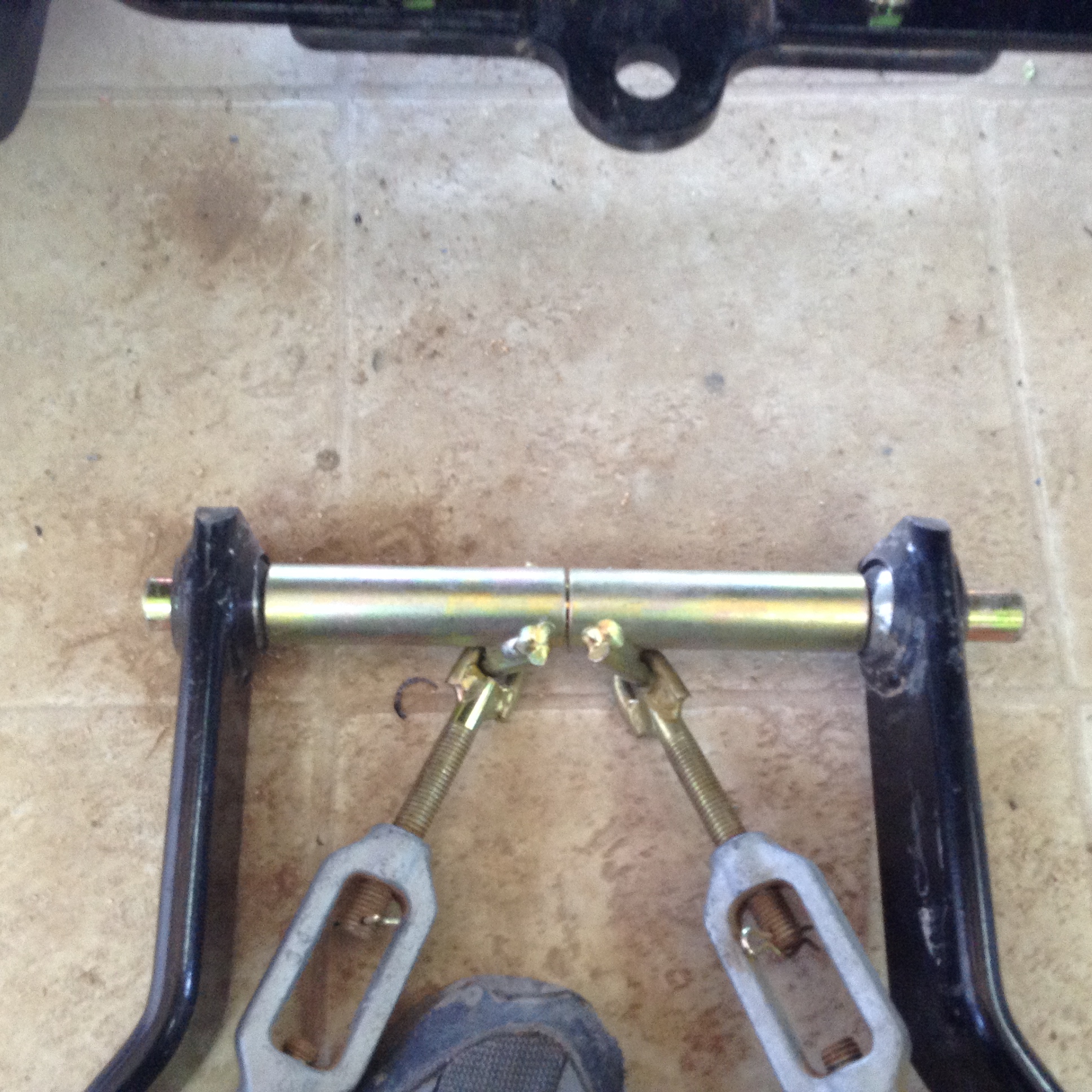

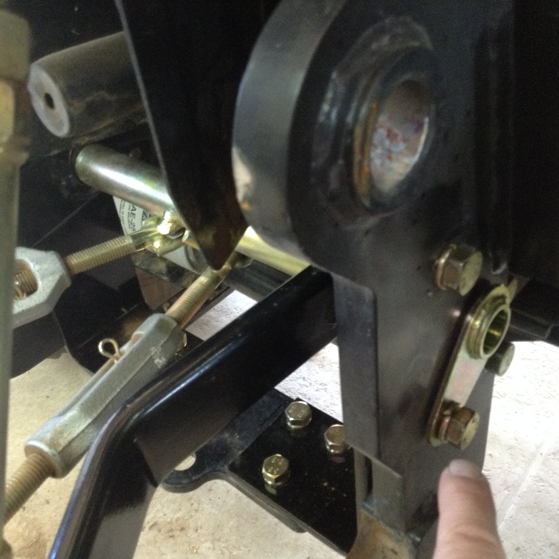

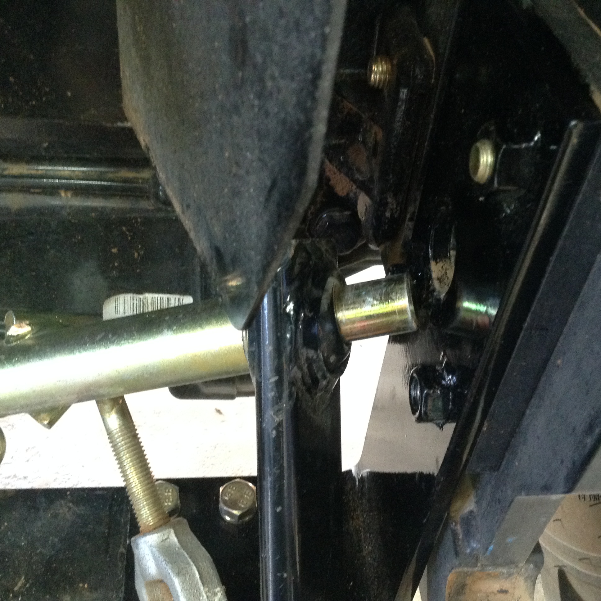

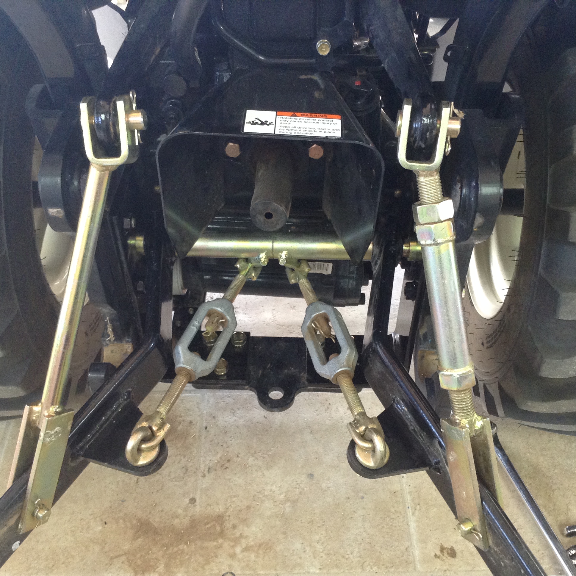

Figured I may as well post some pics now. Loosen one bolt (where I'm pointing), slide the "pin" out. Move the 3 point assembly towards that loose pin, and the assembly will come out. Installation is simply the reverse. I timed from loosening the bolt, installing the assembly, and tightening the bolt. Took 1 minute and 20 seconds. COOL DEAL! My tractor's 3 point is much, much easier to use for sure.:D:thumbsup::cool2::)
