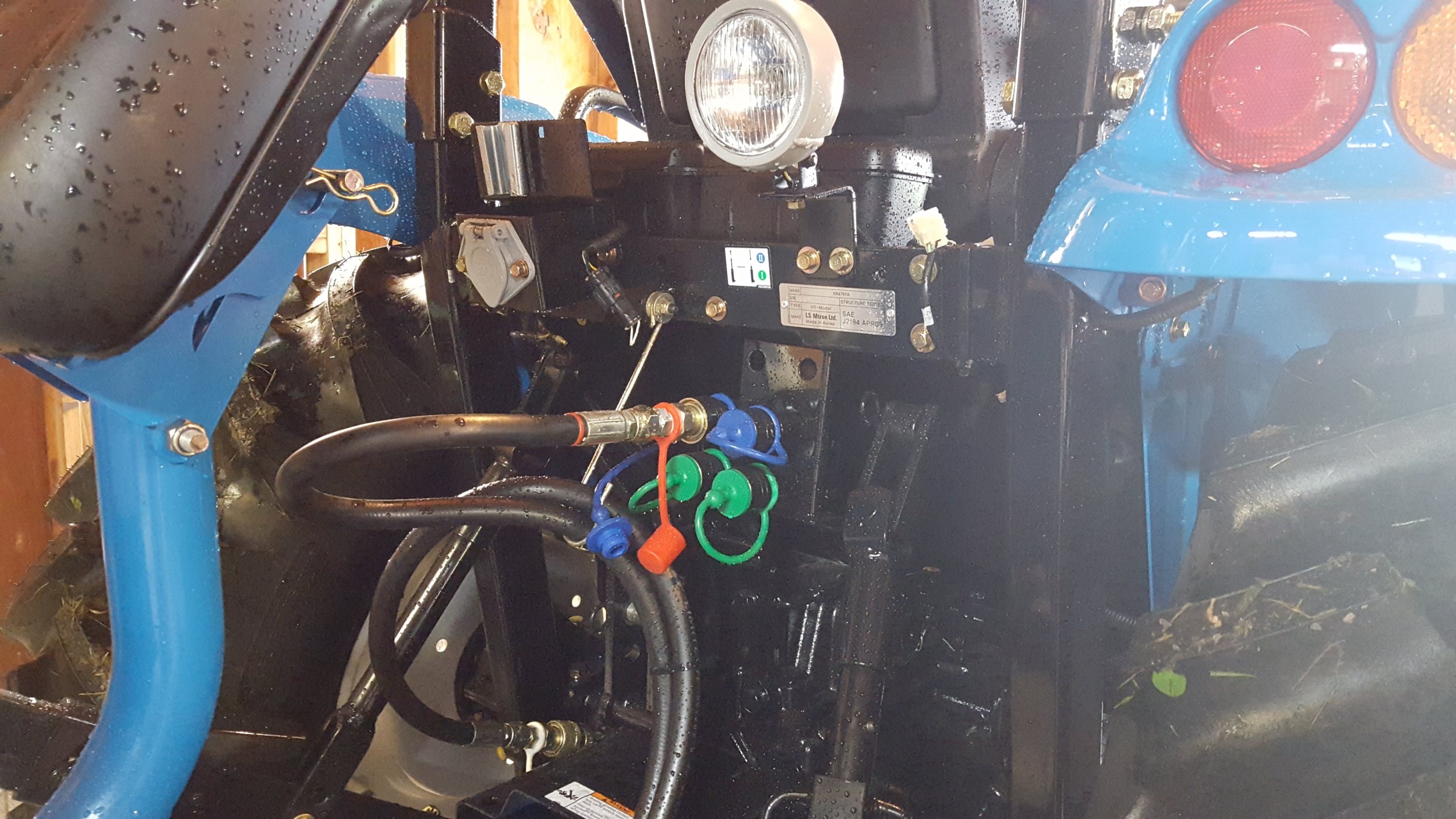

As I mentioned earlier, I live 1 1/2 to 2 hours from their nearest locations, (they have 4 of them) and I did not have the means to get the tractor to them. In none of my correspondence with them did they tell me what condition the backhoe would be delivered and what tools, etc. I would need for assembly/installation, even though it was clear that I was assuming the only assembly needed would be the two brackets that go on the tractor, and that they would do it at delivery. I even mentioned I had shop air if that would make things easier.
If it was unusual to ship the backhoe to the customer rather than bring the tractor to them, then they should have told me up front what was involved.

I agree, WoodMaxx is a good company. I have their 9900 wood chipper, and a 62" flail with the hydraulic side shift, and both are great machines. And yes, their manuals were very clear and easy to follow. Don't know anything about their backhoe, but, I assume it is mounted on the 3-point hitch? I had read that could be problematic so decided to not go that route, and instead get something specifically made for my tractor, though it looks like you have had no problems with yours.
My guess is that I could be the first person my dealership ever shipped a backhoe to. The pdf file, even though it came with pictures, could have been a lot clearer, and the dealership should have anticipated the inevitable questions and been more forthcoming with information. How about a picture of where the hoist straps were positioned to lift the entire thing?, since their are no obvious locations. Why does the picture show the bolts going in one way on the subframe, and the parts drawing shows they go in the opposite way? Which one is right?
