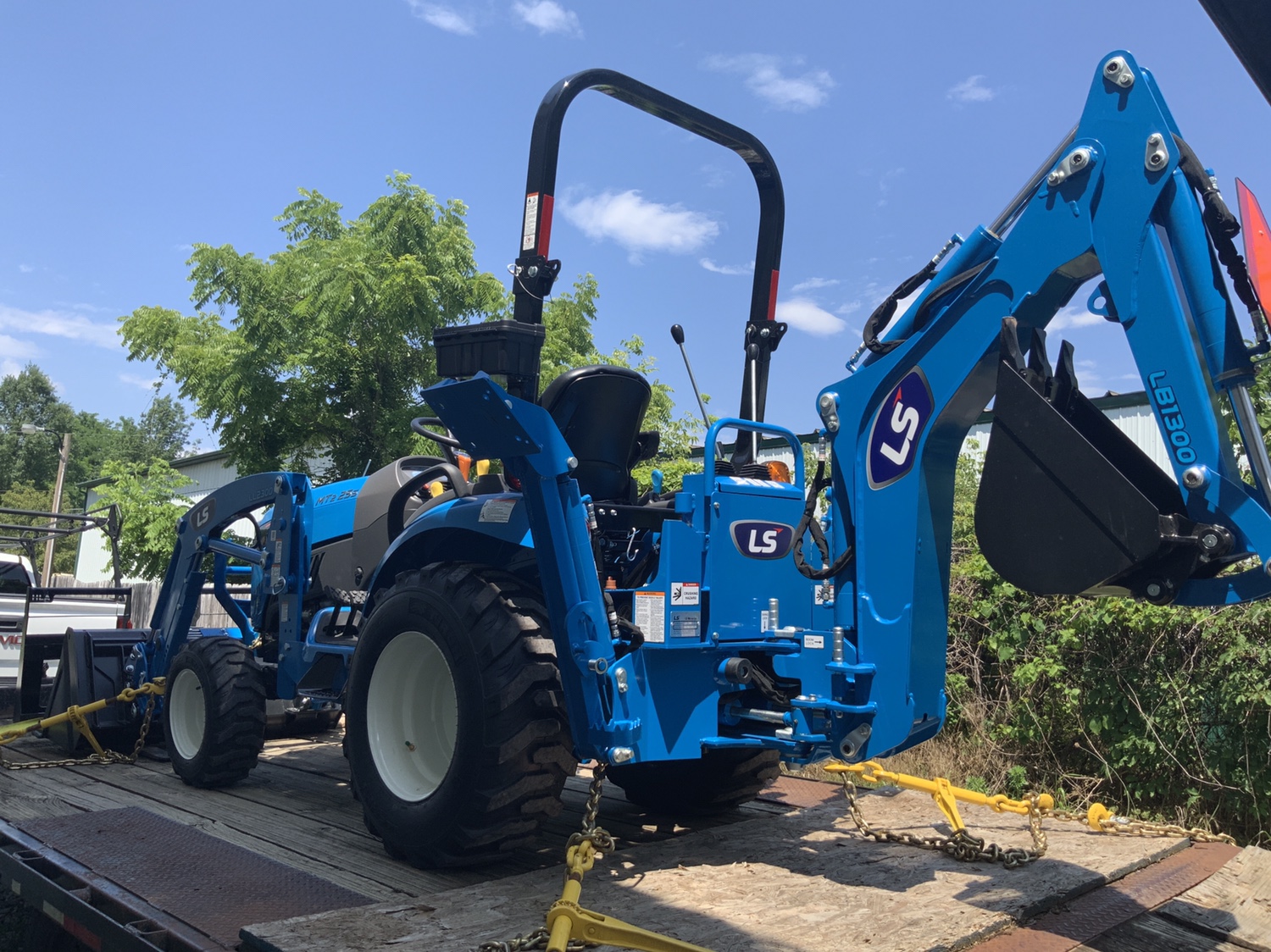

I have about 4 minutes of seat time (driving it up onto the trailer) so I can’t say how well it performs but I think I’m going to like it! IMG_1503.JPG
