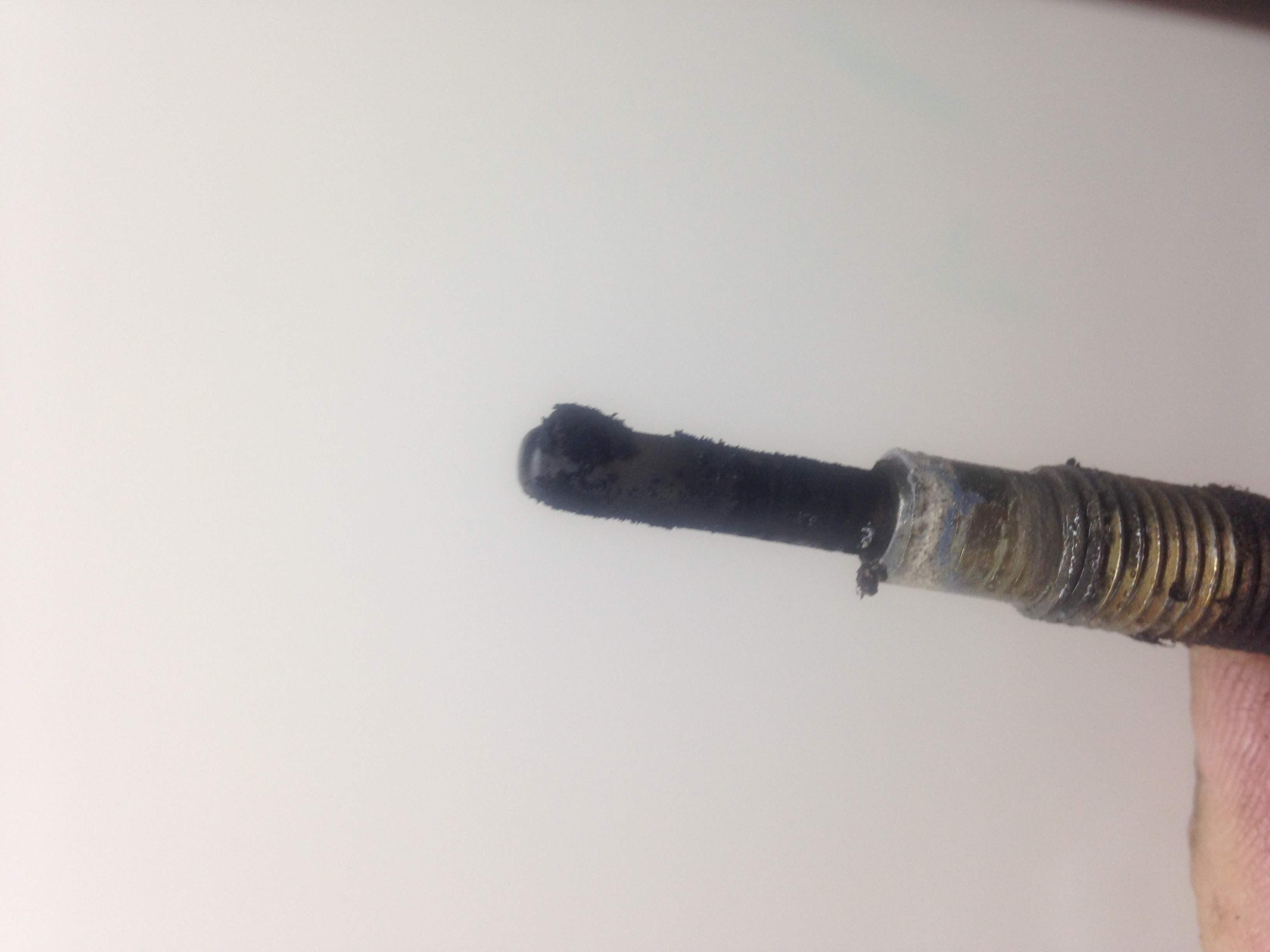

I removed the glow plugs last night they all seem to be good but had a fair amount of carbon (I think) build up on them.View attachment 399378
I cleaned them off and put them back in.. I then checked the volts they were getting (turning the key backwards with each one). they are all getting 12.9 volts. Only thing I didnt do is attach leads to them while in a vice to see if they are actually working. I figured with me checking the resistance and power to each plug that they are working properly and that the relay is working, as it should, due to the meter reading zero when the key is in the "off" position.
Now I will say i had to really scratch through the carbon to get a good connection while checking the resistance.
When you had the glow plugs out is when you should read them with an ohm meter. If they read 0 they are shorted and not working. Glad you found a replacement set.
