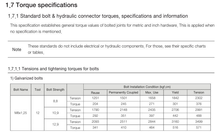

Anyone have a resource on bolt sizes for these tractors? My biggest gripe is loose or missing hardware on our XG3140, otherwise it's been a great tractor.

This is from the earlier G series models. I have no idea if these apply to yours.
/ LS bolt sizes #6
The fasteners on LS tractors are metric. The table provided above is a generic torque table for metric fasteners provided in the owners manual.
If you need to determine the size of a missing bolt, you can go to the LS tractor website parts list and look up the fastener. The description tells you what size fastener you need. For example, for a step bolt on an XG3140, the specification shows; M8XP1.25X40L. That means the bolt is 8mm diameter, 1.25 thread pitch, 40 mm in length.
As far as grade of bolt, SAE grade 5 = 8.8 metric and SAE grade 8 is 10.9 metric. Metric 12.9 has no SAE grade AFAIK. If you don't know the grade of the missing fastener, find a mate on the tractor and proceed accordingly.

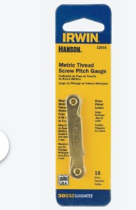

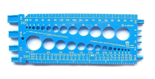

Besides looking up the bolts in the parts list to find the size of missing bolts, you could also remove one of the bolts that's not missing and use a plastic bolt measuring device to determine diameter, length, and thread pitch. These measuring tools are sold just about everywhere and are only a few dollars. I have one that is SAE on one side and metric on the other and measures bolts and also nuts. I keep it in my tool box and use it often if I'm not sure what size bolt I need. Some also show thread pitch but the one in the picture does not. I have a separate thread pitch gauge which is also available in hardware or auto parts stores.
