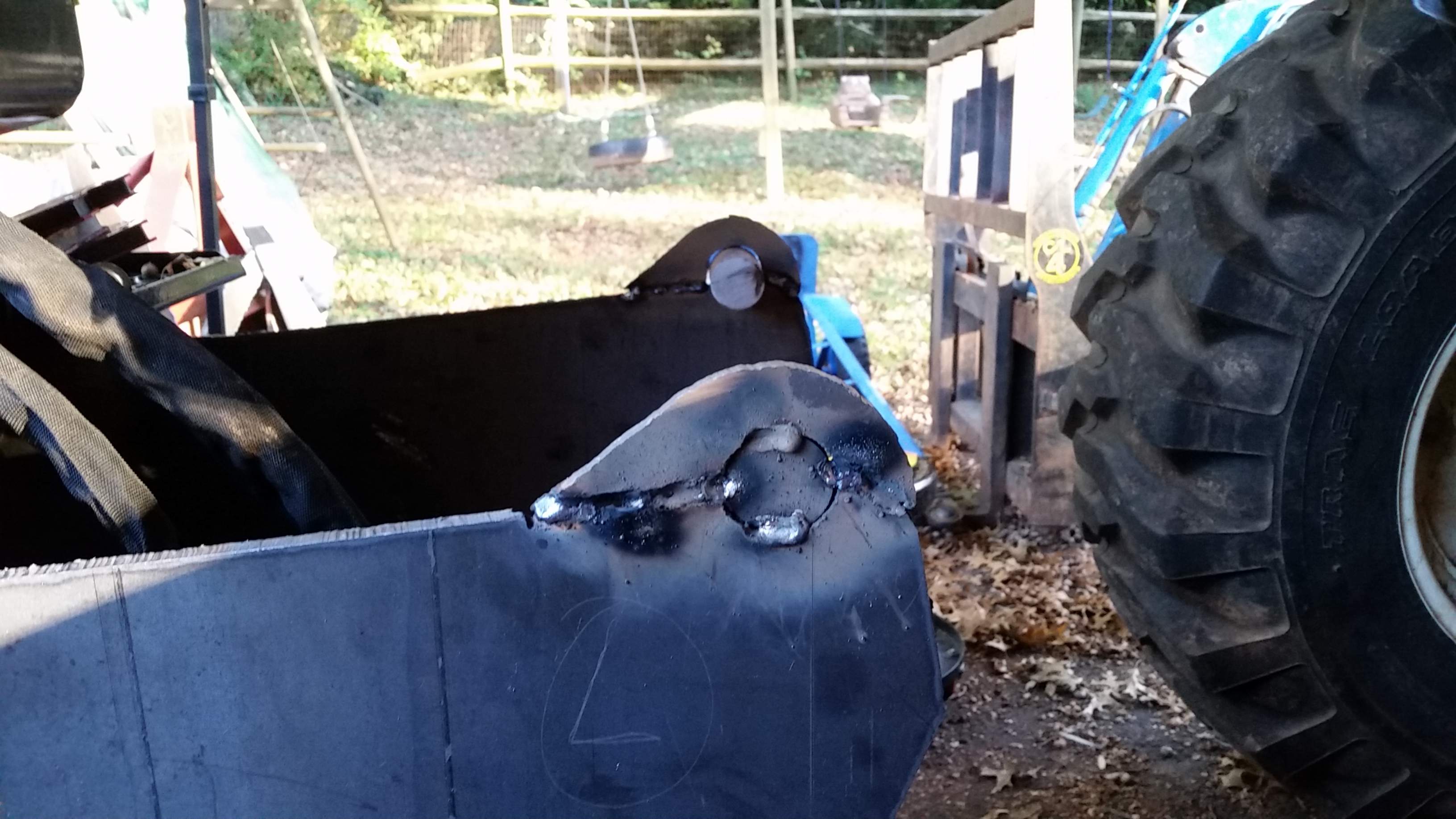

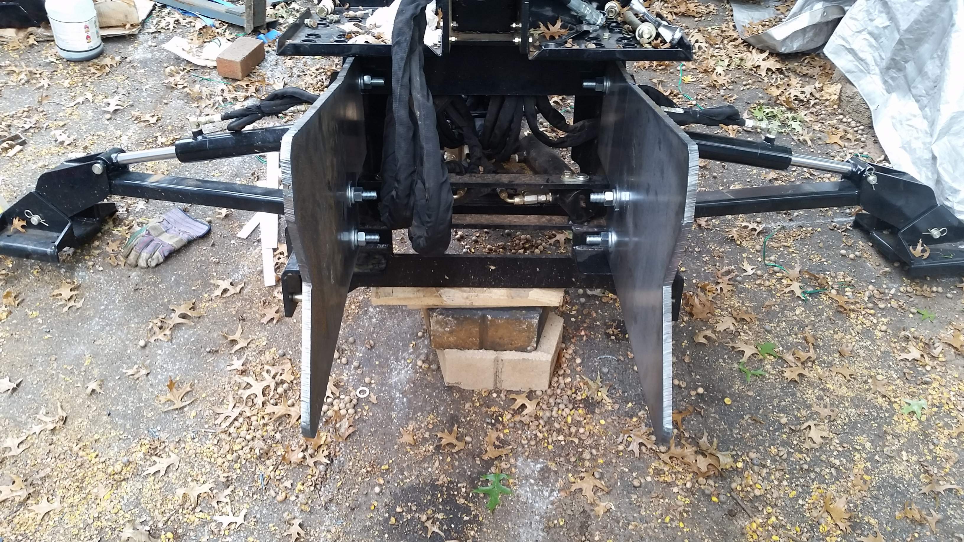

#68

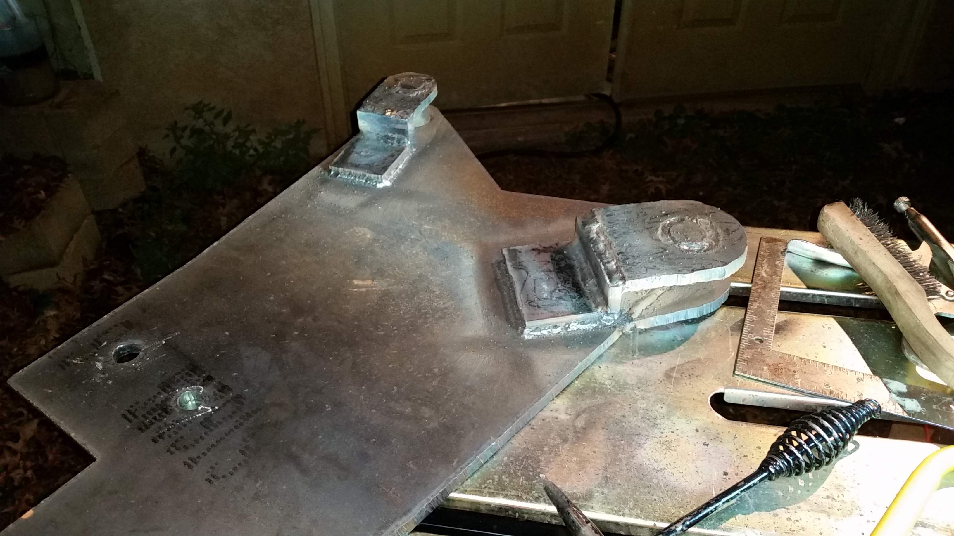

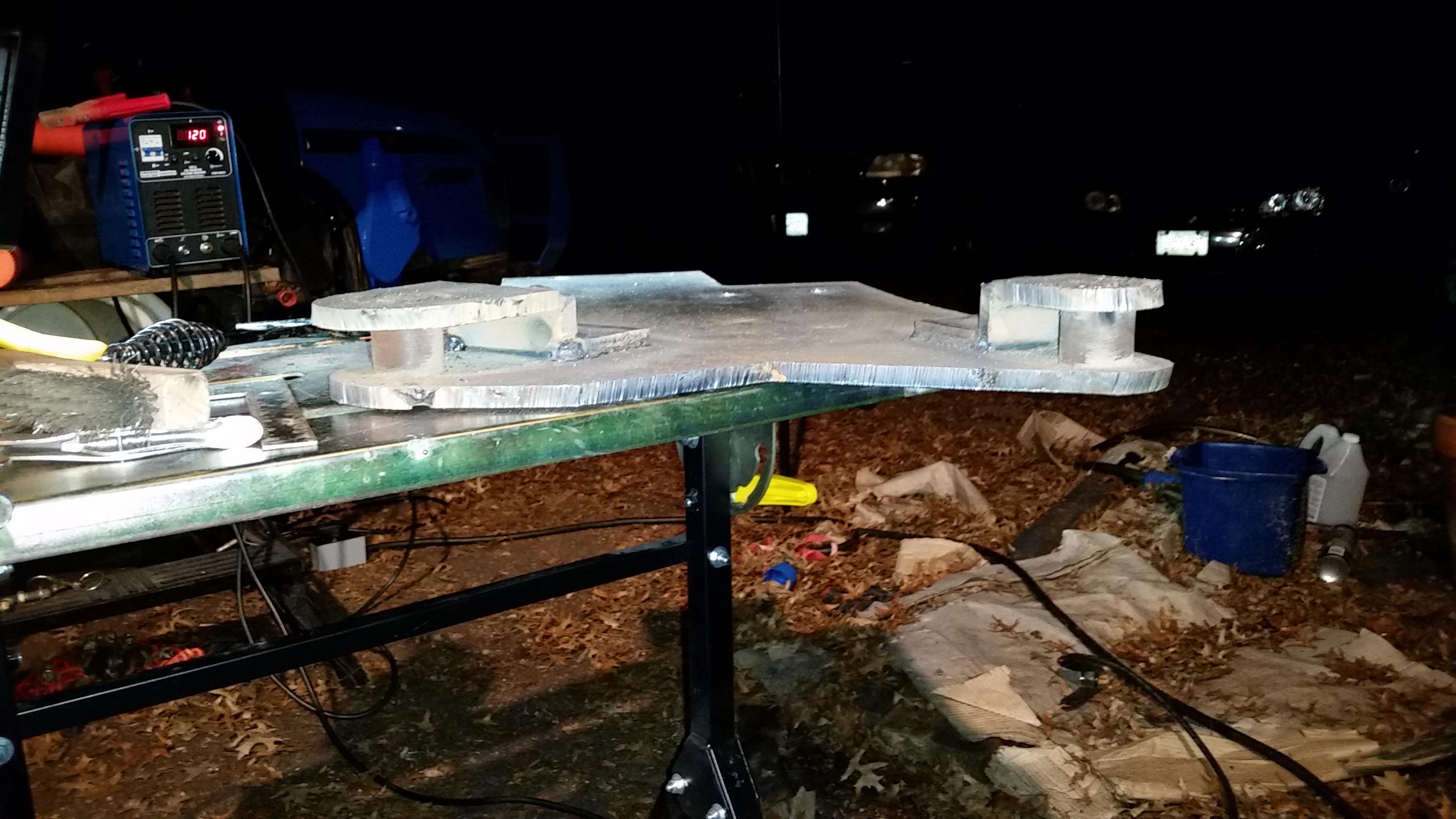

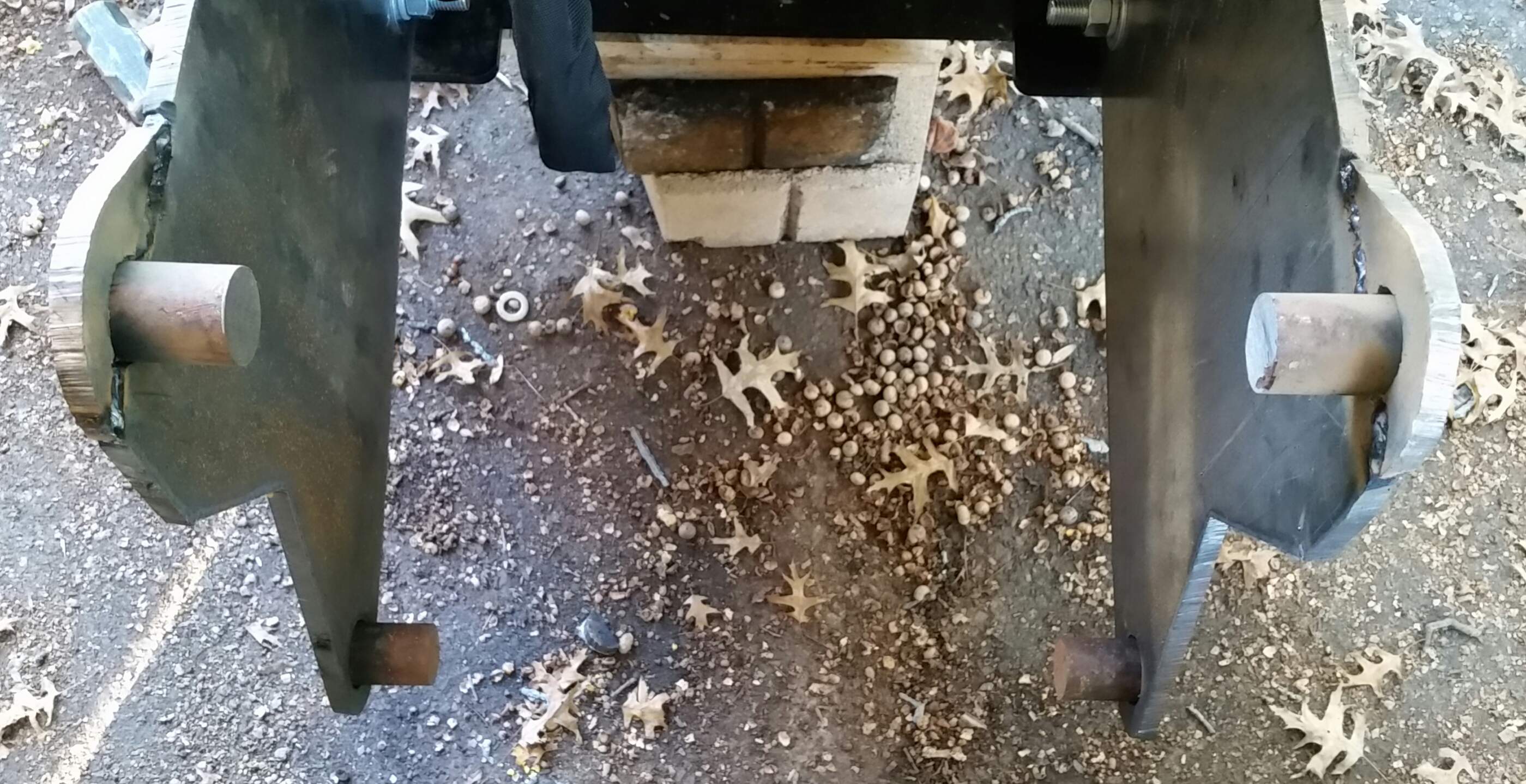

Backhoe sides
Update of progress ... focused on backhoe sides.
Was able to mount the sides I cut out to the backhoe:
View from rear:
This allowed me to then back up the tractor and position the backhoe where I wanted it to be then mark where the pin holes needed to be cut out. I ran out of material and had to add a small part on top to be able to reinforce the top pin. Here's a view of things just tack welded in place:
Another view of pins from the rear:
And I was able to make the brackets to reinforce the other end of the pins. Didn't get a chance to tack them on but here is a shot before they got cleaned up (just brushed off the slag):

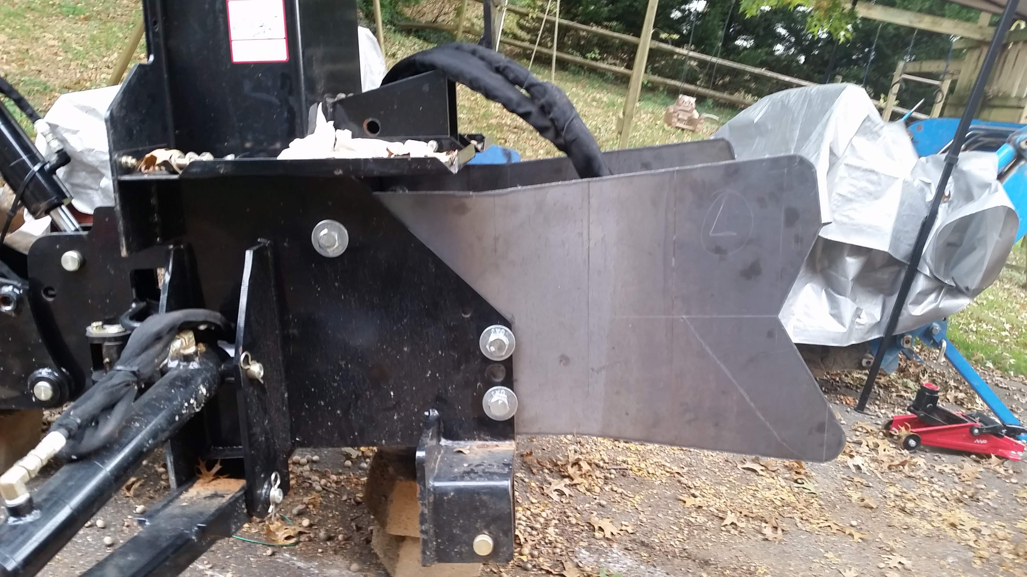

#69

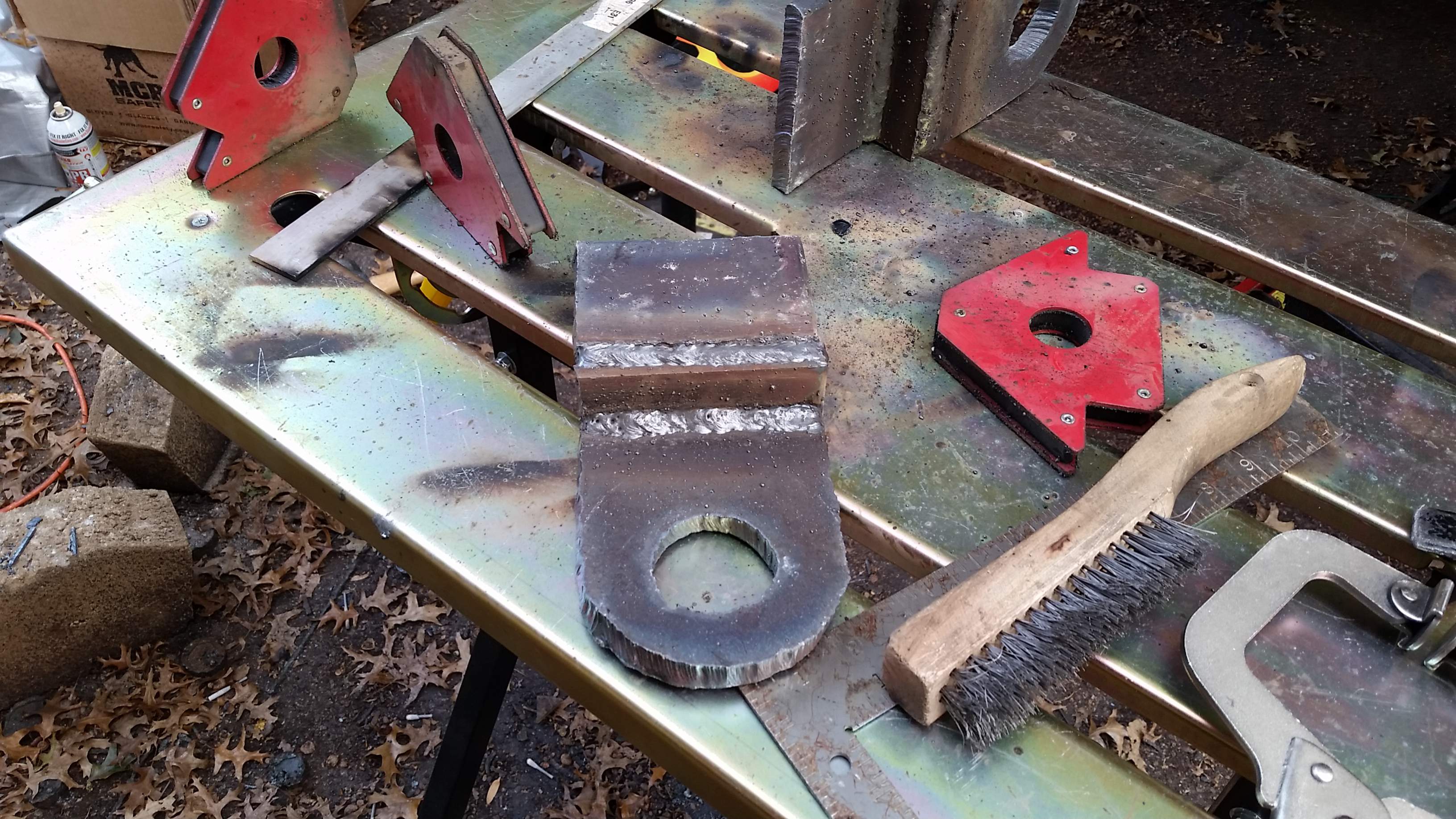

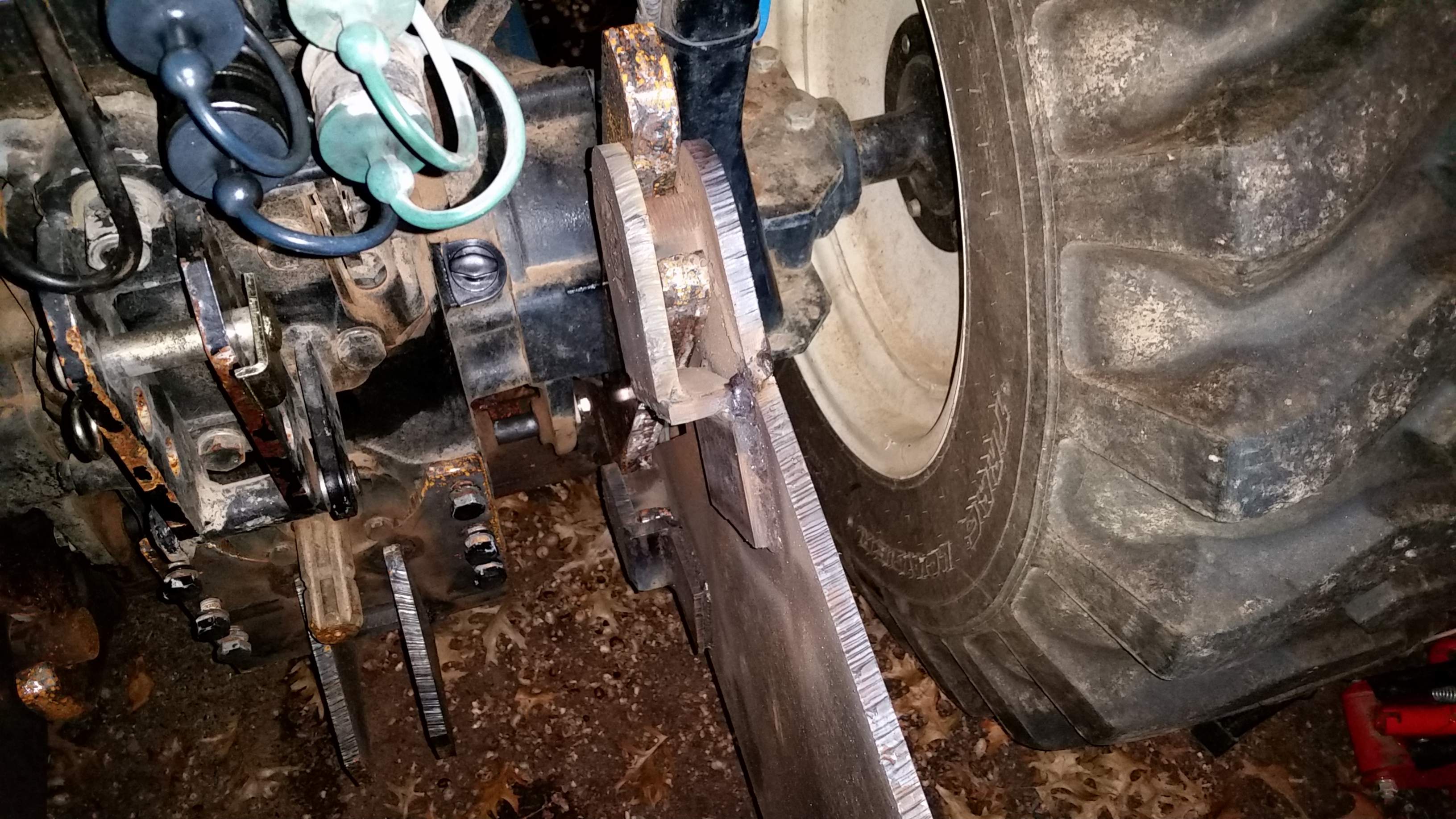

Pin brackets on
Test fit of sides to make sure they fit in cradle OK before I started welding on the pin brackets (my stuff got rained on so now I have some surface rust :( ):
Next, did the root weld on the pin brackets:
Stuck the sides back on again for another test fit:

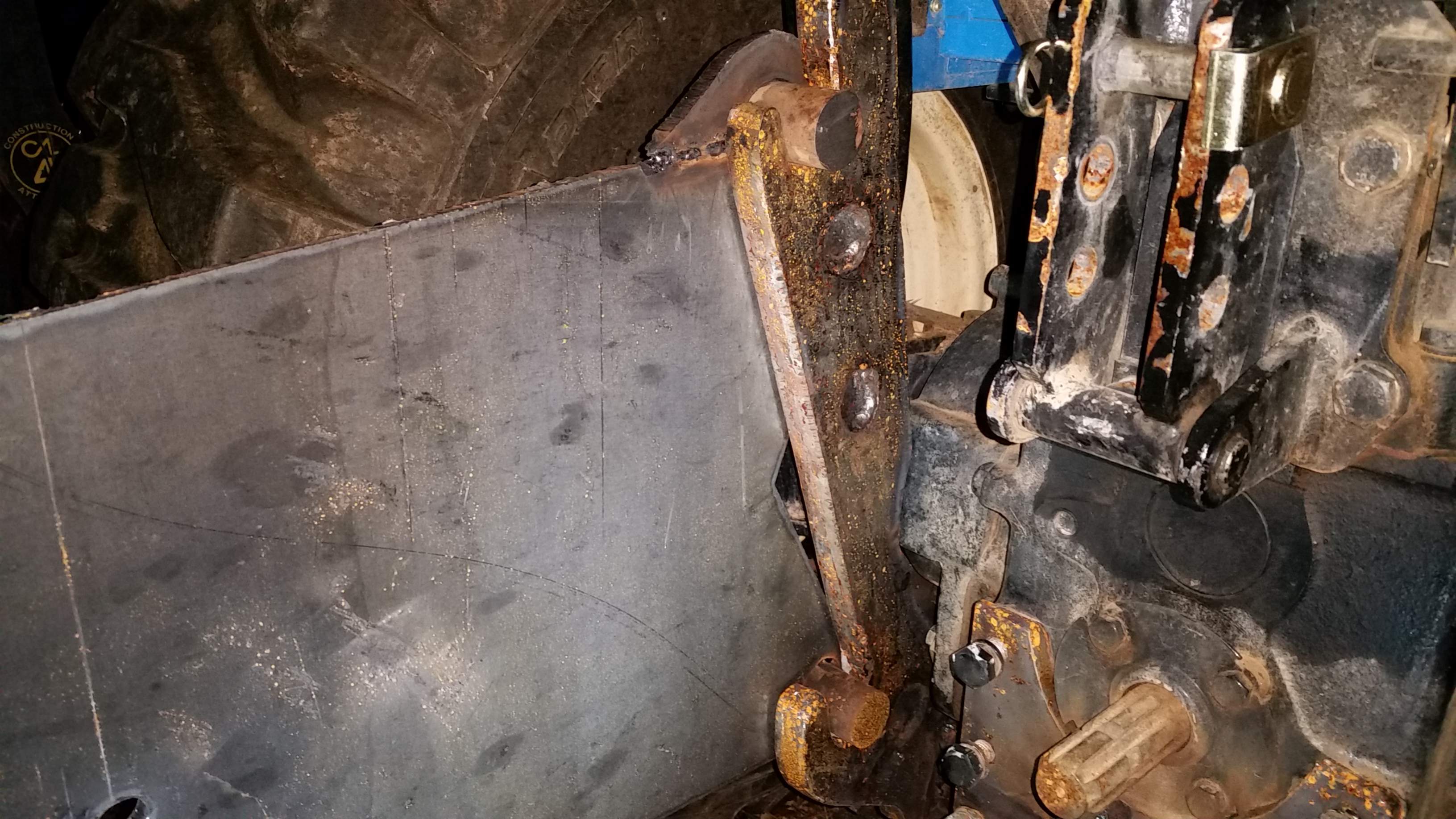

Major Fab Complete! Praise the Lord!
Well, today I finished making the final mounts. I could not figure out a way to make a mount that went over the top of the axle and connected to the front to back supports that run up to the FEL cross member. The R3039 is just too compact to do it the way it is done on the TC-45 and others. So I made a mount that attaches to the top of where the ROPS mount to the top of the axle and will connect to the top of my 4 point cradle with a 10.9 grade bolt.
Here it is after completing the root welds:
Now I need to take the subframe off the tractor and do the final welding then clean it up and paint it. It's taken me 3 months but I think I'm close to finally trying it out.
Oh, I also made another mount that I didn't get a picture of yet ... it connects the two cradle upright mounts together and helps prevent them from being pulled in towards each other. I'll post a pic of that next time I get a chance.
