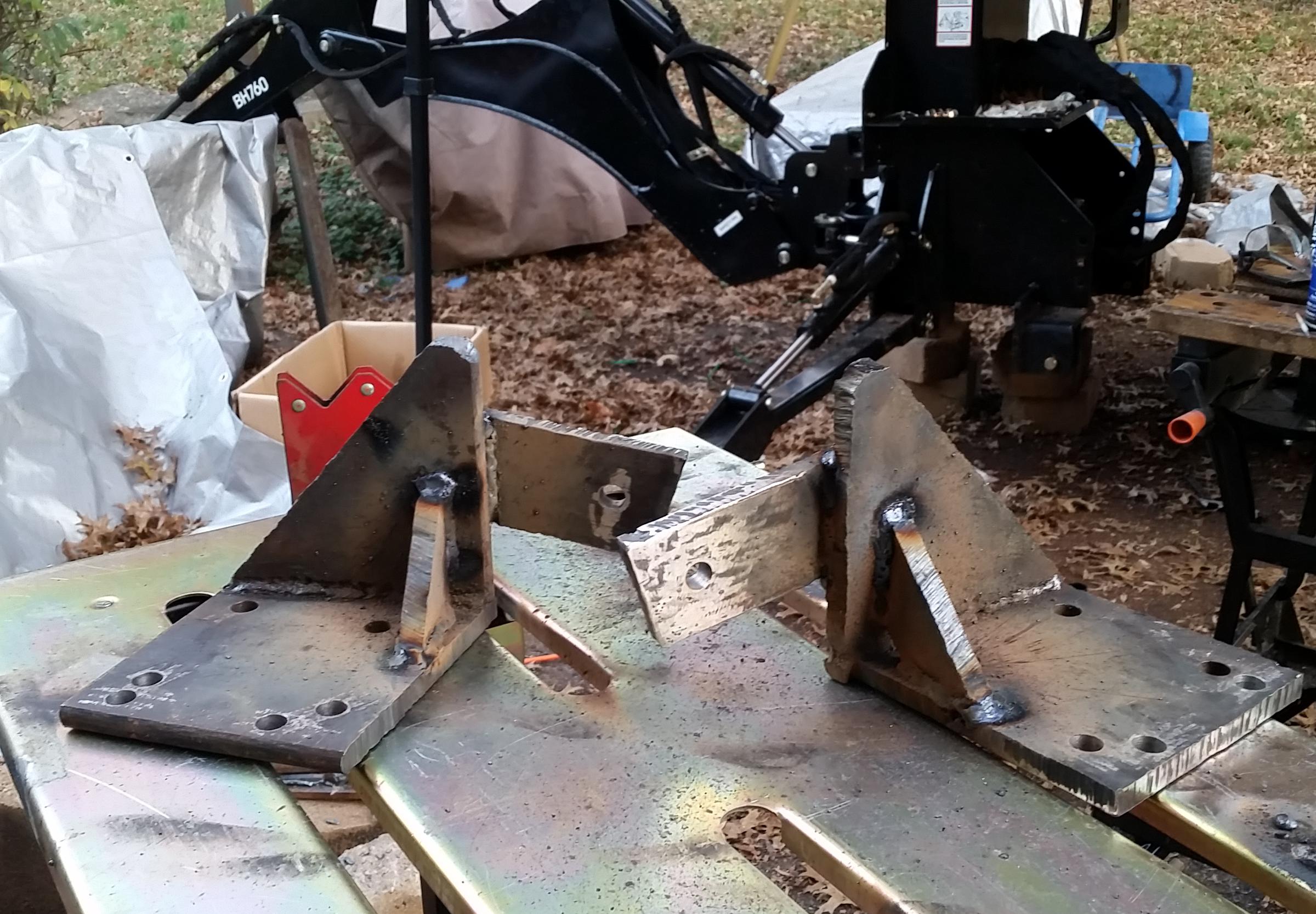

Been sitting on this one for a while ... sorry.
These are pics of the mounts I made to sit on top of the axle on either side. Sits on top of ROPS mount. Intent is to hold the upper portion of the upright cradle mounts to keep them from being pushed into the transmission housing or pulled downwards toward the backhoe.
This is just after they were root welded. Didn't take pictures of the final thing after they were cleaned up and painted:
*edit - Oops, I just realized I already posted that pic. Guess that's what happens when you take a year to get something done.

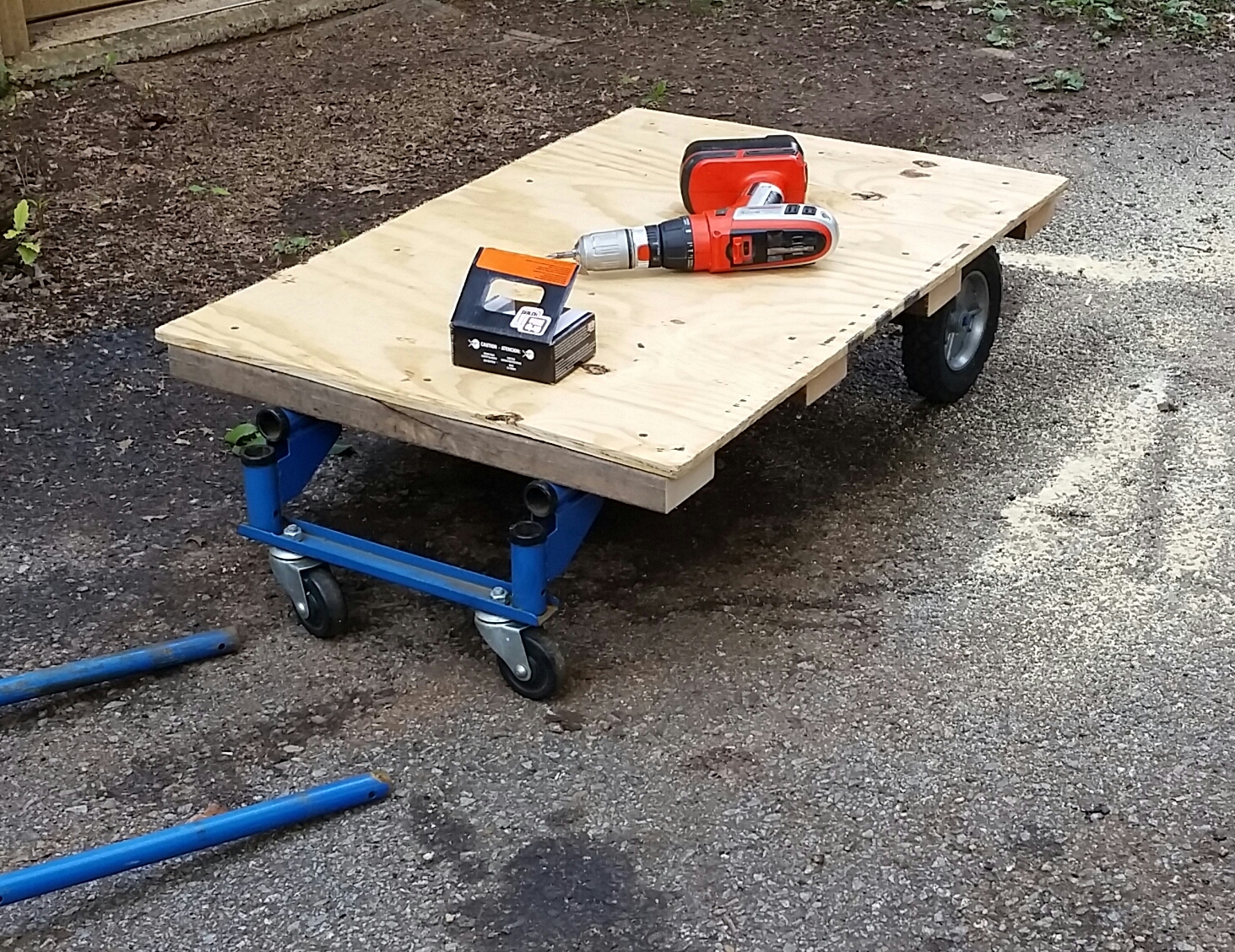

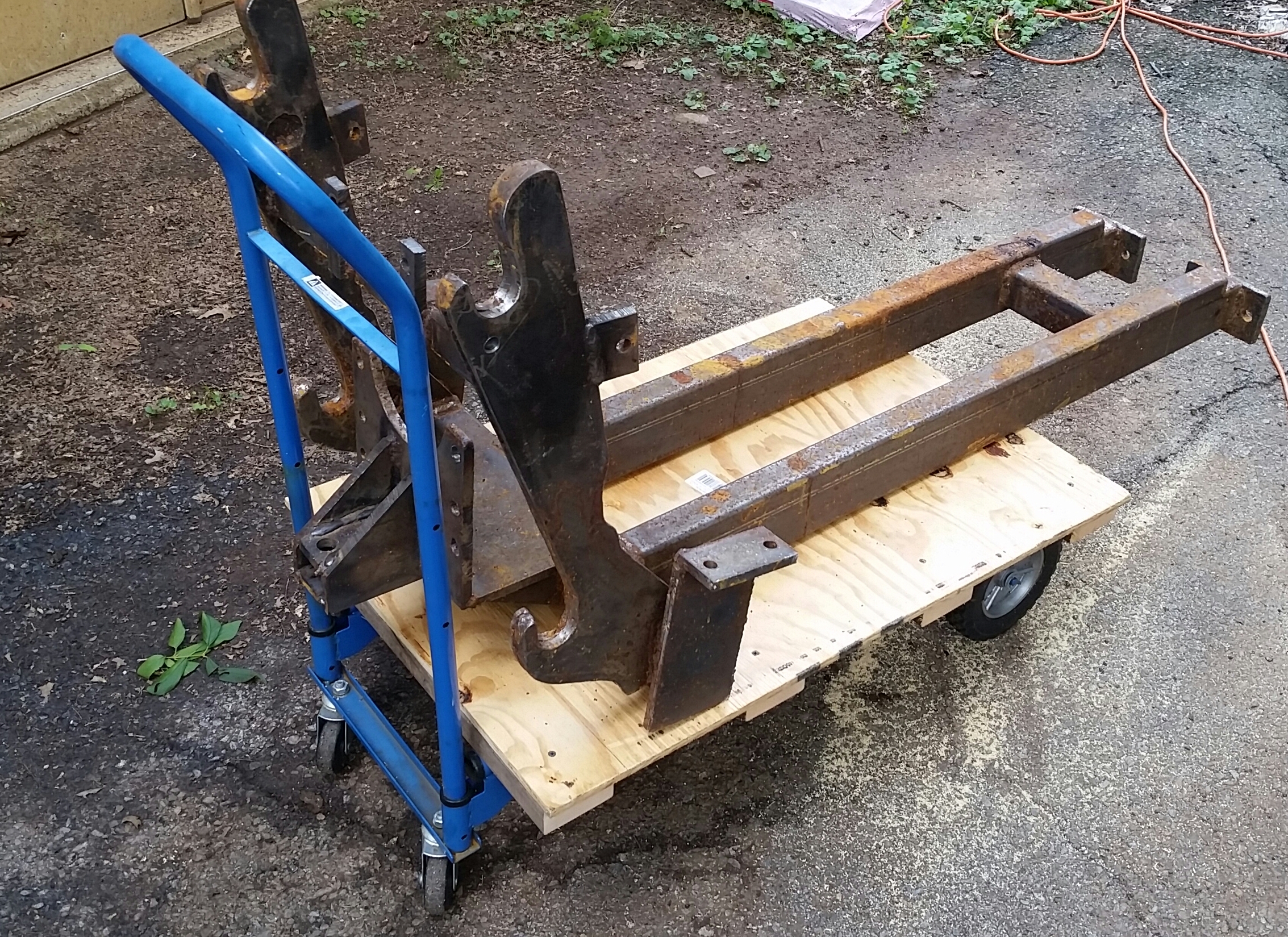

This subframe mount was too heavy for me to move around without help and nobody is around now to help and my wife's in no shape to help ... so I sacrificed a HF horizontal/vertical dolly:
This allowed me to easily move it around by myself and start cleaning up the rust that accumulated over the winter. It was covered with a tarp but the moisture still did it's thing:
There are four more pieces to the mount but I didn't take much time to photograph those as they are posted previously as I was making them.

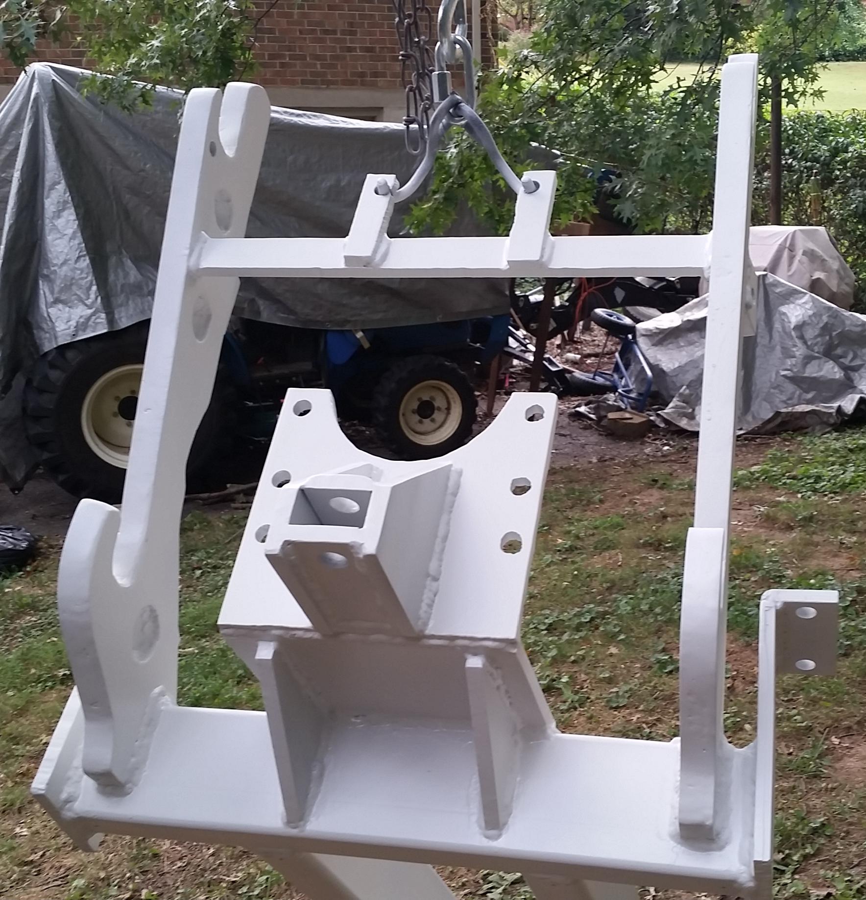

The small parts were fairly easy to hang up and paint. I decided to use the old mostly rotted swing I built for the kids a looong time ago. Nobody uses it anymore and the wife has been after me to get rid of it so I thought I'd get some use out of it before I cart it off (it's one of those tree fort things so don't tell the wife but I think I'm going to drag it to the farm and use it as a chicken coop!)
It was fun trying to figure out how to hoist the subframe up in the air by myself. At first I was going to use a come-along I had but I discovered I couldn't change directions with it using a snatch block because it was setup for double line pull only. I didn't have enough height/headroom to use the come-along inline. So I went mad using 20% super coupons at HF and got a 1,000 pound hand winch and two snatch blocks. This allowed me to very easily lift the thing and start painting it:

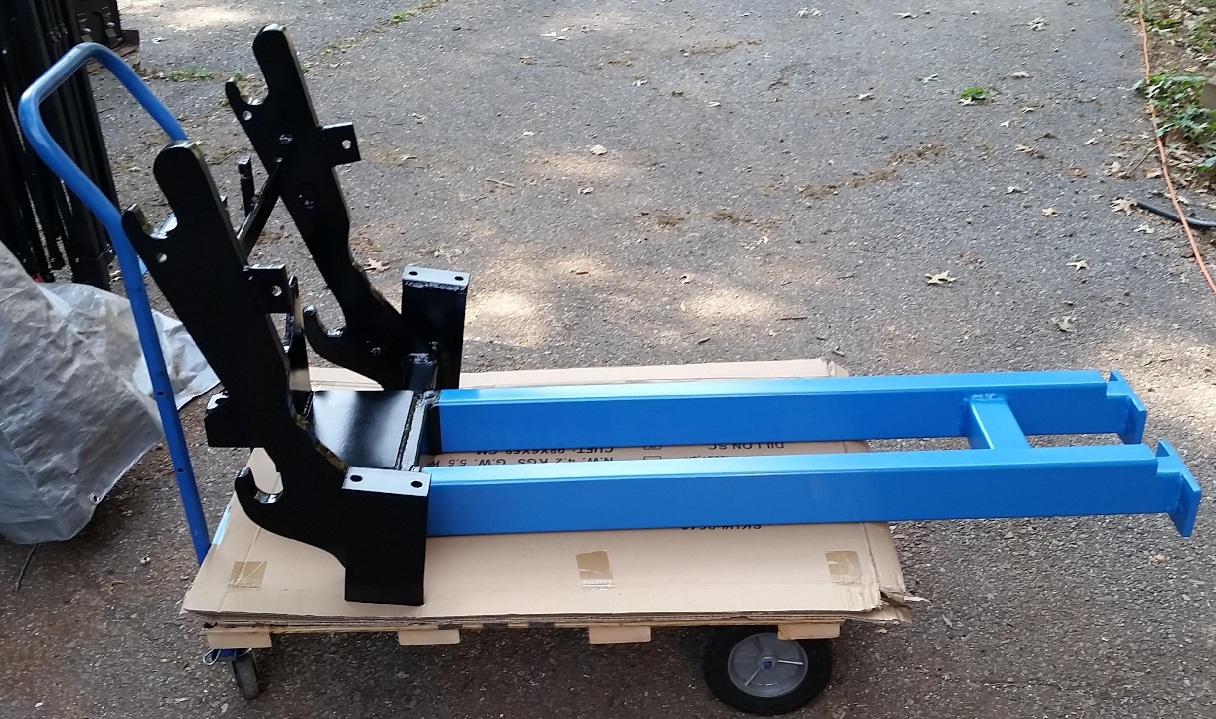

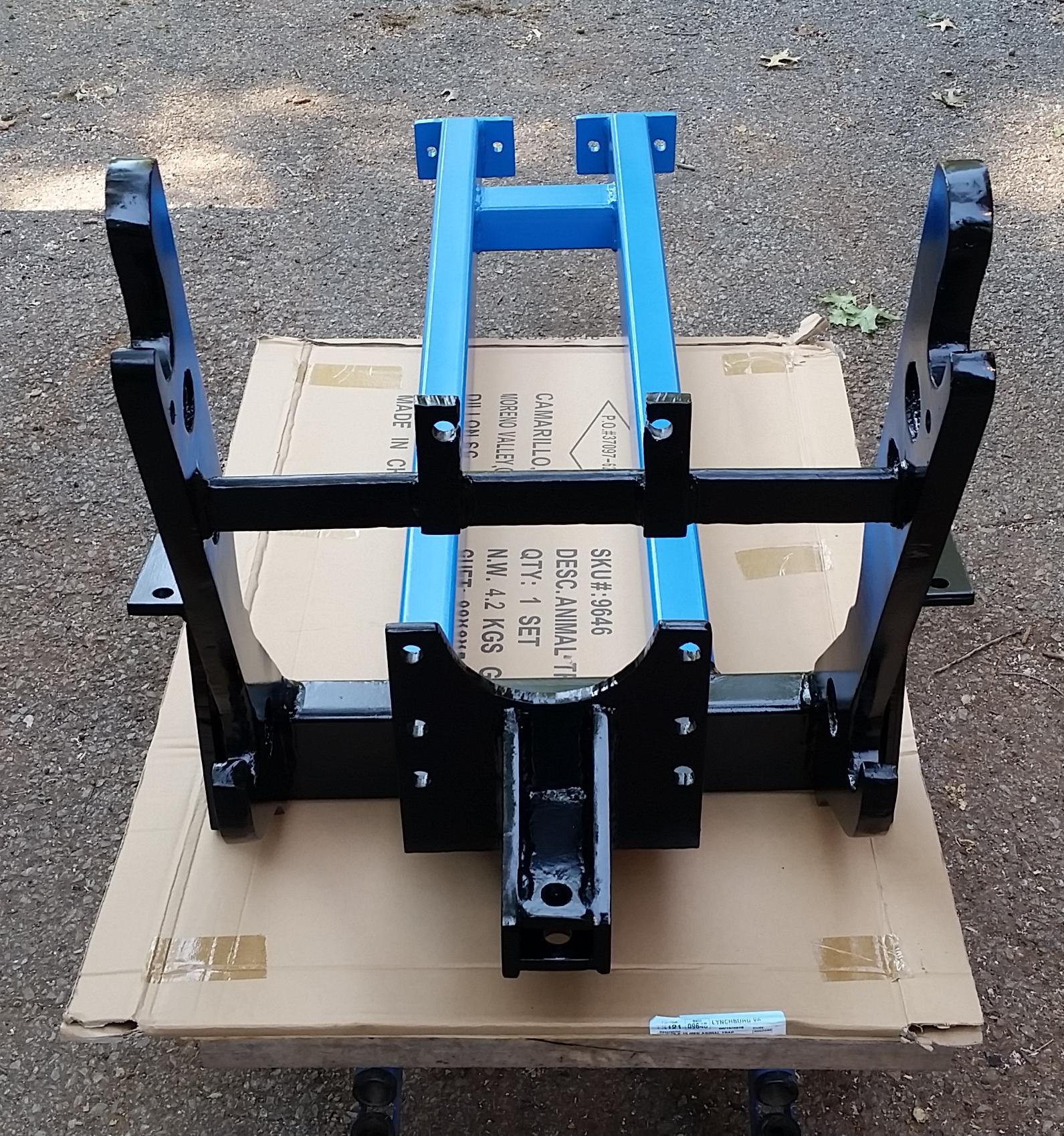

Here it is with it's final paint job on my high speed low drag HF super cart:

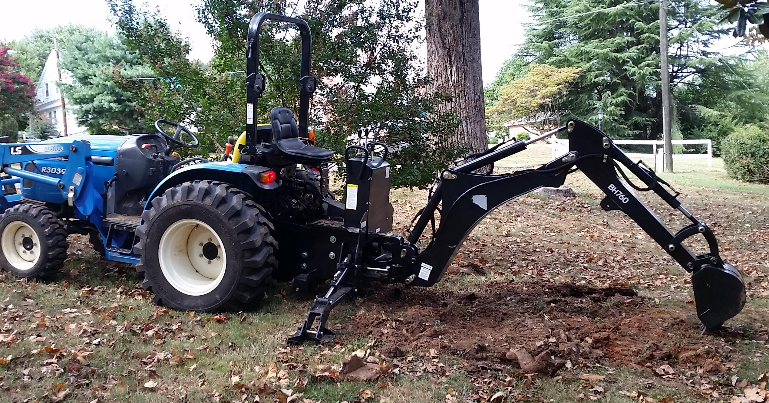

And now the money shot you've all been waiting for:
... The Ansung backhoe lives!
I had one of my top axle/ROPS mounts for the backhoe off due to the holes not being quite right so I thought it would be fun to pull on an old rotten stump and watch the mount to see if I correctly anticipated the forces that would act on the subframe mount. I was also hoping to bend one of the cradle mounts out just a tad. Well, I put the cylinders into relief pulling on the stump and the cradle mount never flexed or moved at all even though one of my mounts was left off! I was very surprised!
So I plan to egg out the holes a bit with a die grinder to get the final mount on. The backhoe sits only a few inches closer to the tractor than if I would have bought the 3pt. hitch mount and used that. I had to base the mounting position largely on the seat location ... I wanted it as close to the tractor as possible to eliminate overhang but I didn't want to be banging my head on the ROPS everytime I went to get up!
This project is entirely the fault of dfkrug for convincing me to attempt this with his excellent thread on "making your own backhoe subframe mount".
Next time I'm around the tractor I'll try to show more pics of the backhoe sitting in the cradles. It's pretty easy to attach and take off since I don't have to stand on my head and try to look up under the tractor to align things. With everything in the back it's very apparent how things need to move to line everything up and then just back the tractor up a few inches and let the backhoe down into the cradle then pin it so it can't lift back off.
The design was stolen from studying a co-workers Bradco backhoe on his TC45, a Woods subframe mount for a TC30 and incorporating some features from the factory LS mount that is now unobtainum (which is why I did this in the first place) and my own flare sprinkled in for fun.
That looks really good, Brian. Hopefully you have no regrets after taking on this project. The rewards make
it more than worth the efforts, IMO. I am glad you got something out of my subframe post.
Now, dig some holes and post the pix.
