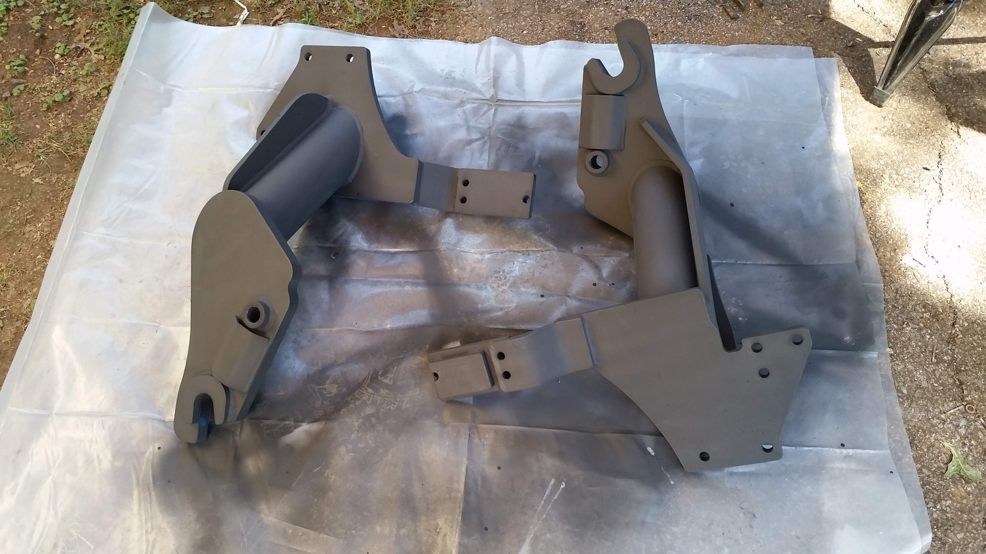

Re: Paint Department
Looking good
Thanks! It's Rustoleum Sail Blue so it isn't going to match and I'm OK with that for now. My main concern was to protect where I welded and grinded the reinforcing plate and the rest of the mount was dinged up some too so I wanted to nip any rusting. Lord willing if I ever get my road and pole barn built I'll have better facilities than I do now (... working in the driveway in my back yard under a canopy), I'll redo it with the proper matching paint.

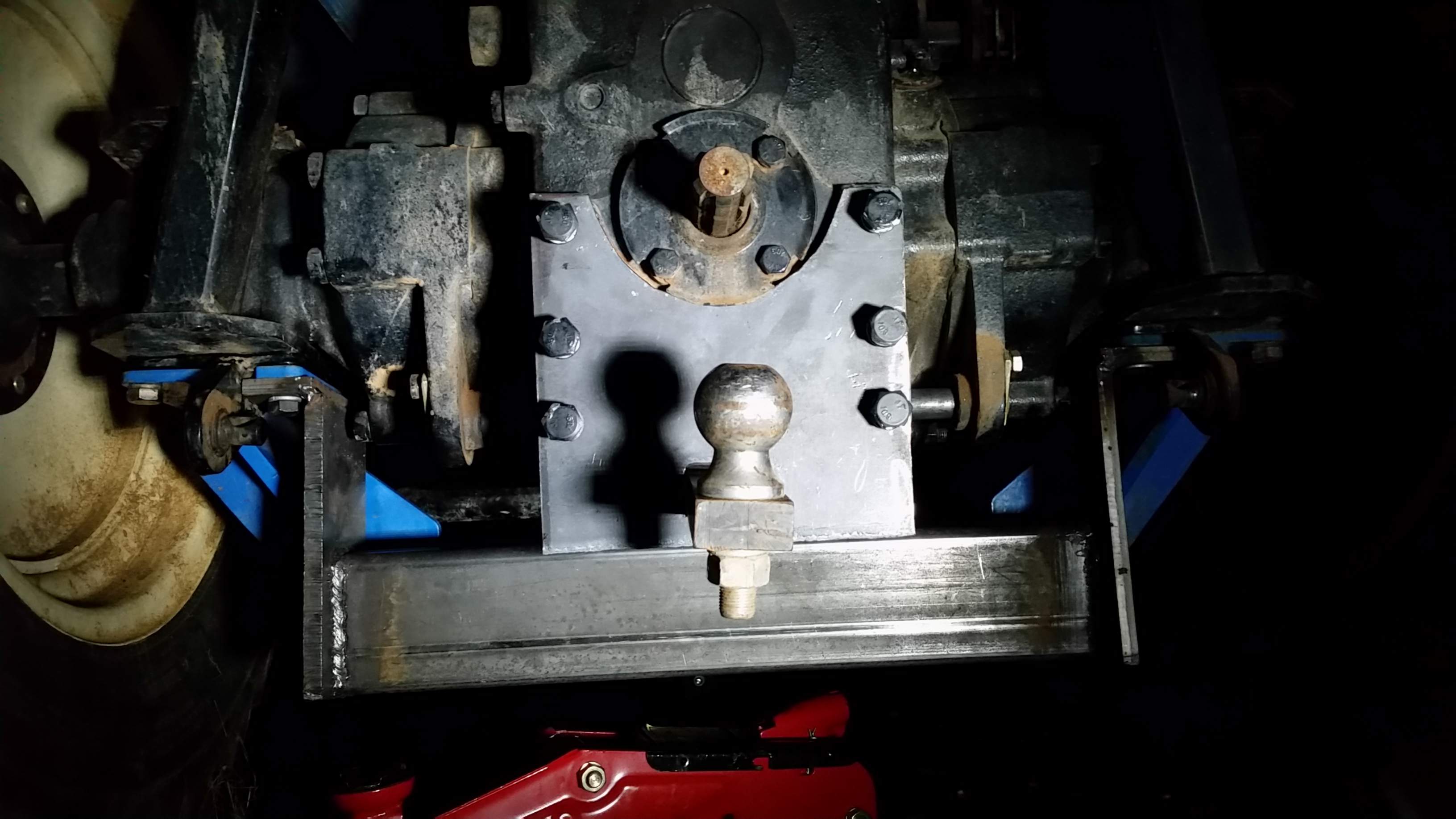

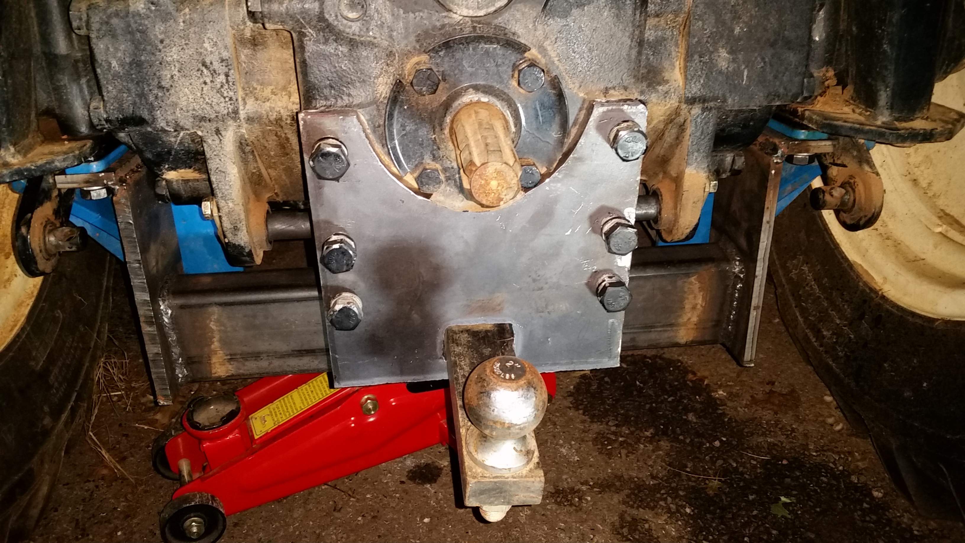

Test Fit
Tonight I test fit the new drawbar mount that bolts to the 6 holes around the PTO. I could of hacked up the original mount but I wanted to be able to put it all back original if I ever wanted or needed to. Plus the new one is made out of 1/2" so it's about an 1/8" thicker than the original.
The bottom of the plate hangs down almost 3" because I will have another 1/2" plate welded at 90 degrees (horizontal) that runs back to the cross member between the ROPS mount to help reinforce it. I plunge cut the drawbar hole (my first plunge cut!) and cut out the parts to make the new drawbar mount.
I stuck the drawbar in the hole just to make sure it had enough clearance to fit through the 'hidey hole' I made for it.
This one shows how the plate comes down level to the cross member (which will have a horizontal plate running back to the cross member and triangle guessets):

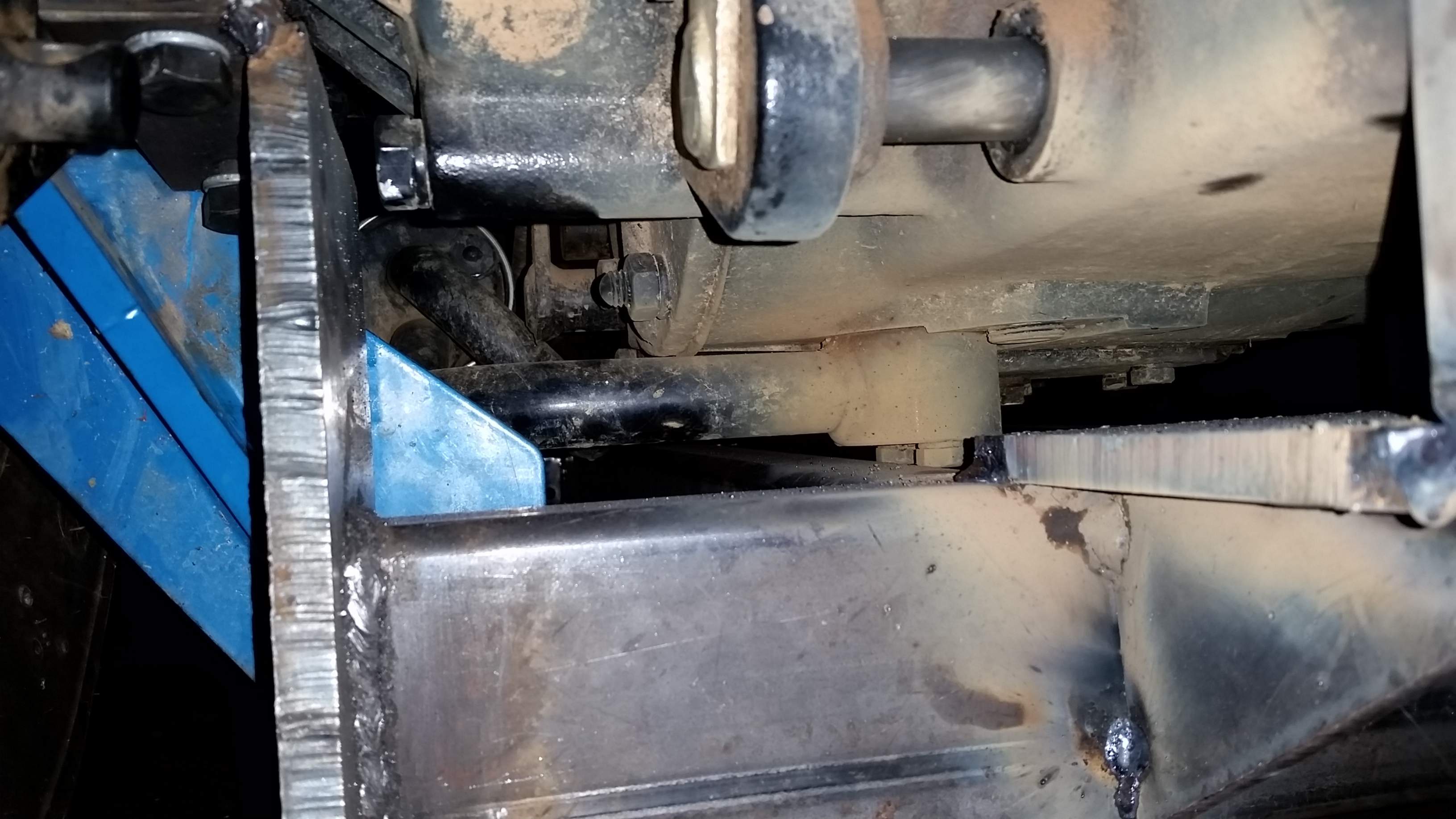

Mock-Up Continues

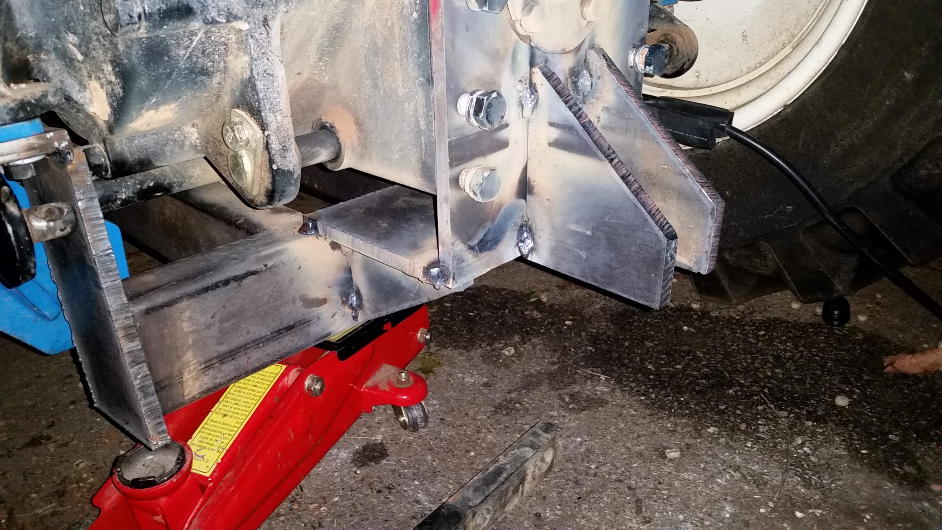

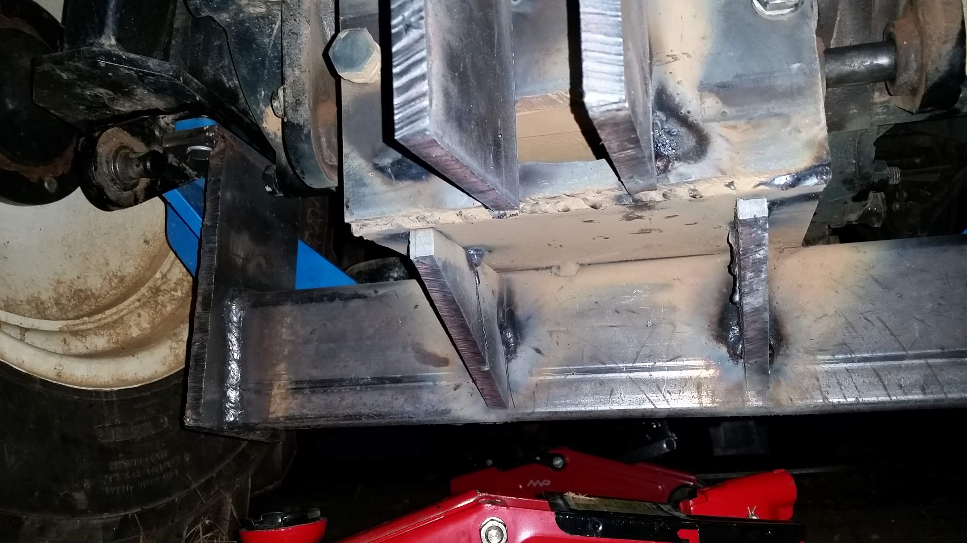

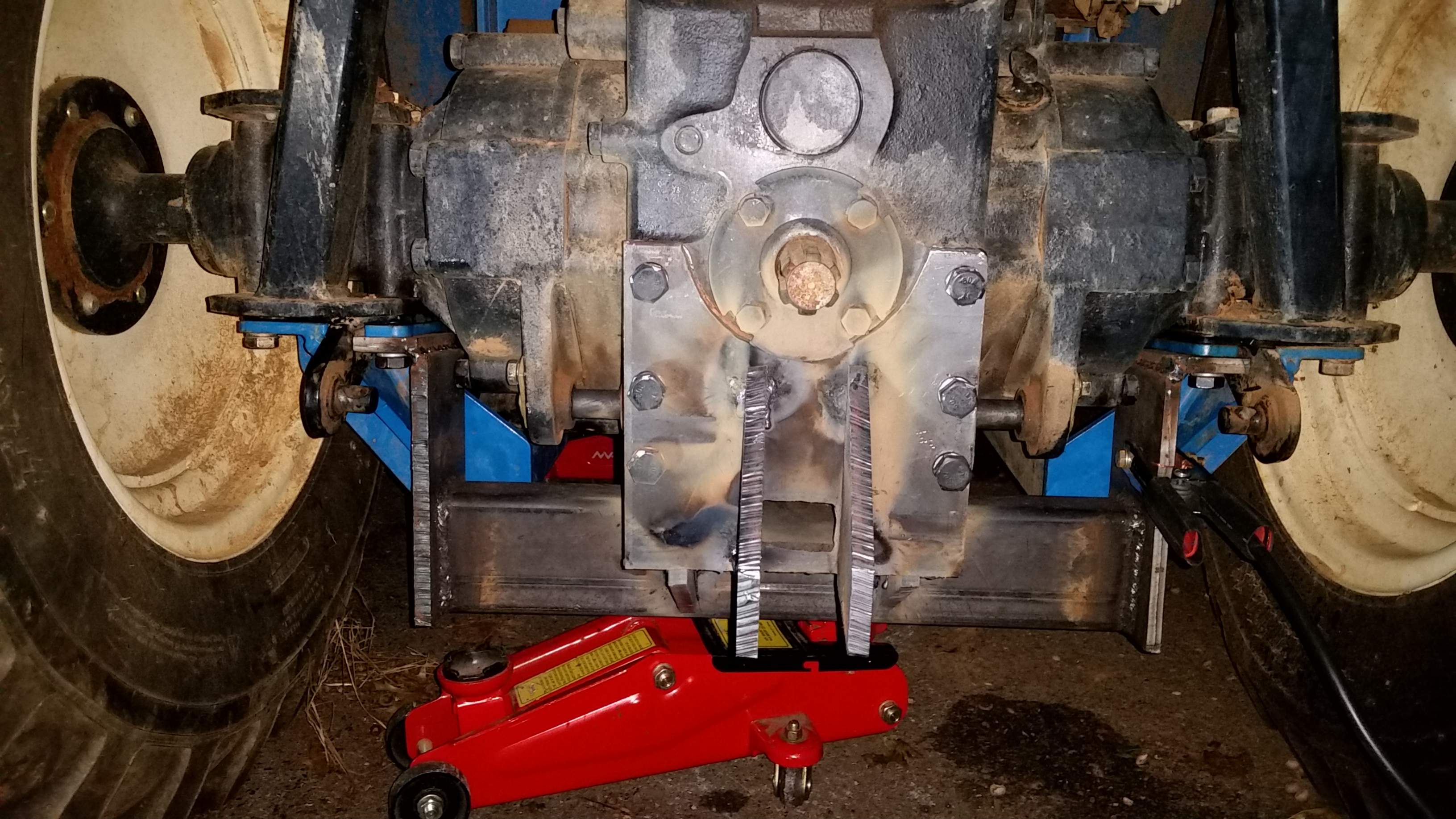

... twas the night of 1/8" mistakes :(. Nothing major, just hits to my pride. The wife's 'honey do' list was quite large so I didn't get the time I wanted to work on the project for the past few days. Working in the dark and trying to hurry doesn't go together very well.
I tack welded the parts I cut out a few days ago. Here is the underside of the new drawbar mount around the PTO where it ties into the cross member (you can see where my one of my triangle gussets is an 1/8" oversize):
I started tacking on the actual drawbar mounts and screwed up and got it 1/8" off center (still need to cut pin holes in the top/bottom parts):
Kind of a side view shot:
And here you can see why I lost an inch of clearance ... big rigid hydraulic line was in the way:
