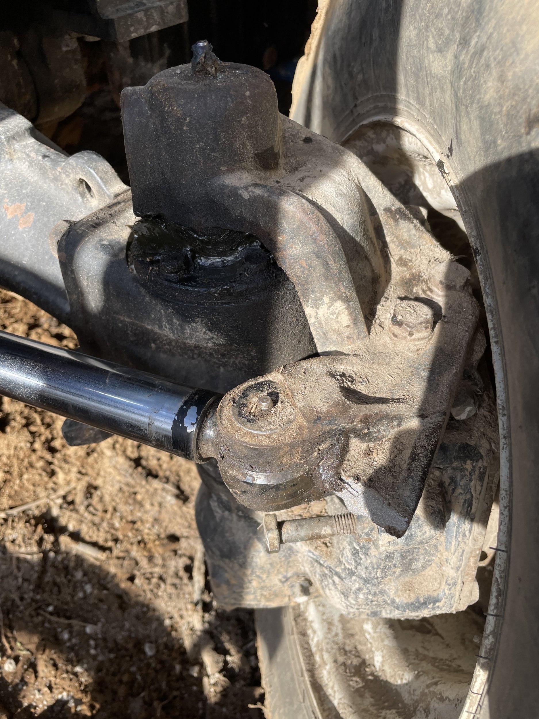

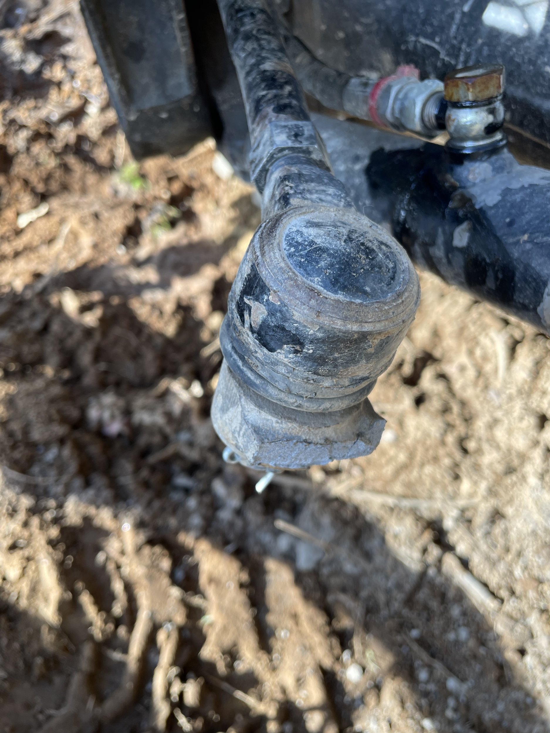

Hello all,

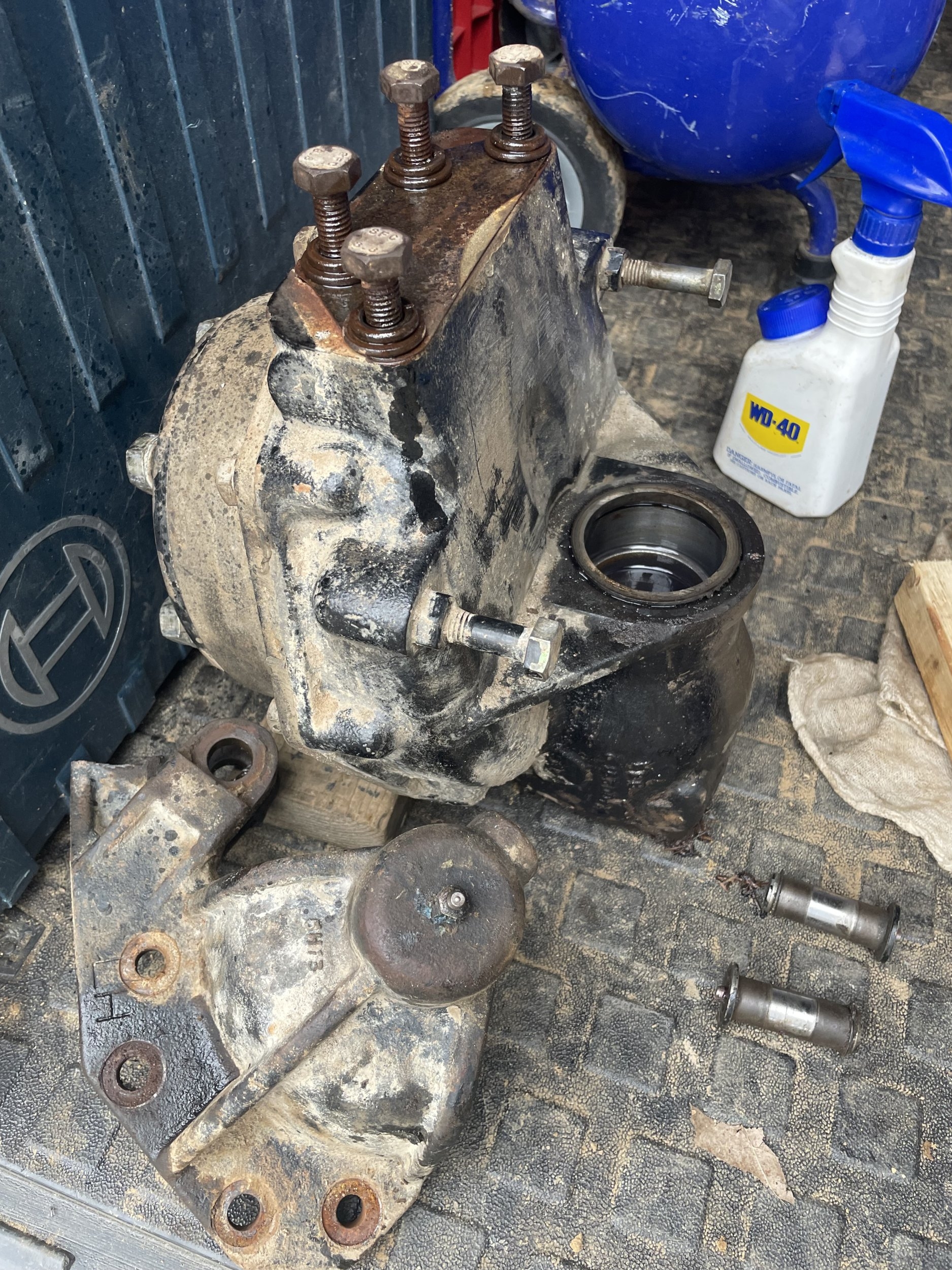

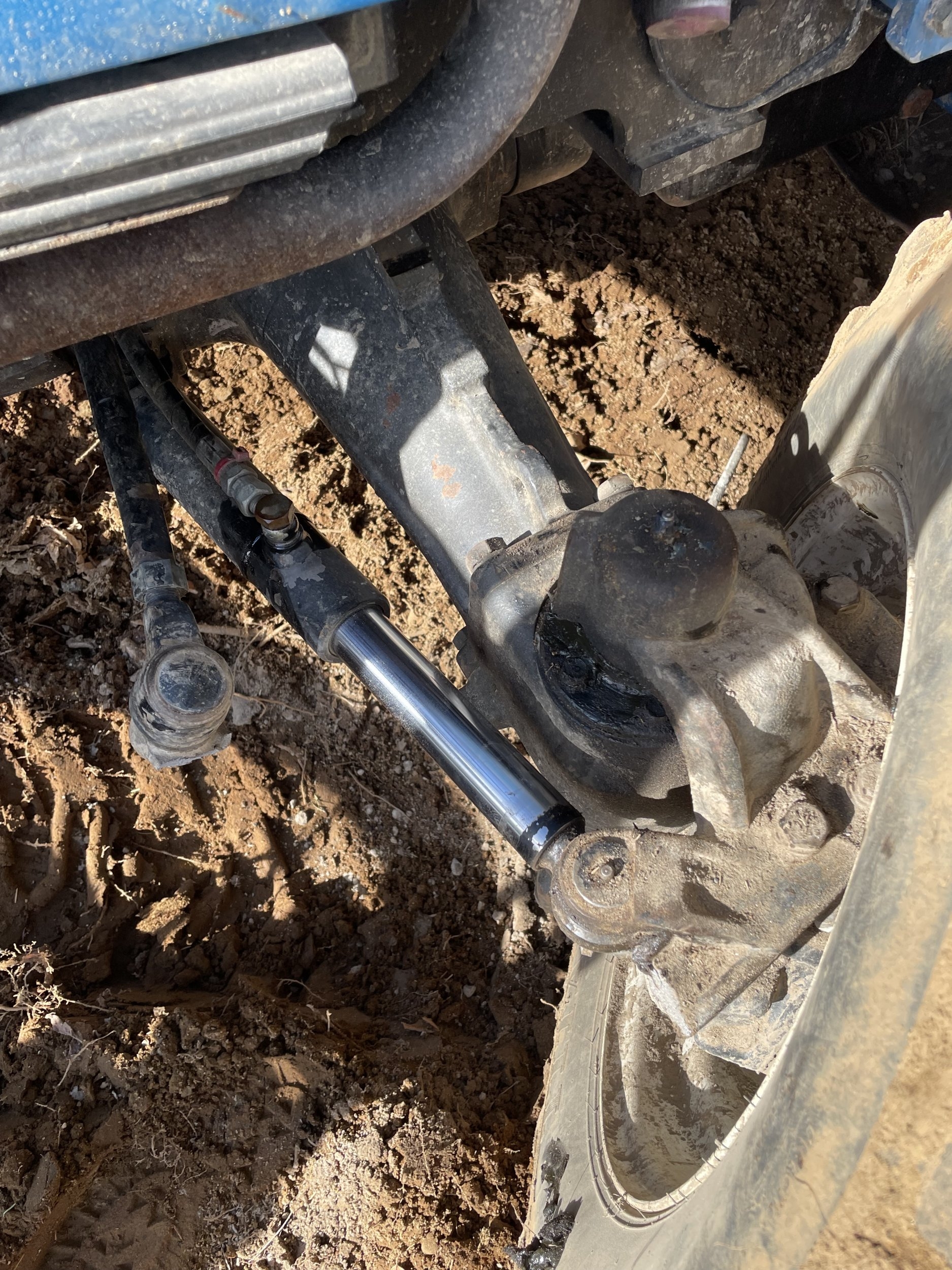

Looking for some help here, snapped the control arm on the left wheel assembly yesterday. I have a 2014 LS 4047R. I was in uneven ground doing some road work and the right wheel hit a large rock in the bank I was pulling material from. The control arm snapped right where the tie rod connects. I am going to try and source parts tomorrow from my local dealer but will need to do the fix myself, they are backed up months in the service department. I have everything off on the damaged side. I am curious if I have another issue though, both steering cylinders are extended. There is quite a bit of pressure built up as both cylinders are at, what seems to be, their extent. Is there a way to adjust those cylinders to get them back in time? What would cause that to happen, steering valve / pump failure? Seal failure in one or both of the cylinders?I have attached some pictures of the damage.

The steering cylinders on that tractor are single acting cylinders. This means they will only extend when pressure is applied and won't retract on their own.
By having two opposing single acting cylinders, one will cause the other to retract when steering one way and vice versa. The easiest thing for you is to pull the hydraulic line of one of the cylinders out and retract it by hand. Just be aware that it will probably make a mess of hydraulic oil.
I believe the user @Avenger had the same or a similar issue with his LS tractor. He even have a video or two repairing it if I recall correctly.

Thanks @ptsg for mentioning my video. When I saw this thread, I knew exactly what happened and how to fix. Then I saw the photos and started wondering why the entire assembly was removed. So yeah, simple enough fix. As stated in my video, I was wearing chains and I believe they got bound up in the loader bracket while turning on uneven ground. I heard a snap sound and watched the tires turn all the way out in separate directions. The tractor was still under warranty at the time, but the dealer was months out on repairs. So he sent me the parts and I did the repair myself.
I took the top control arm off and inspected the bearing. It seemed to be in good condition. My dealer sent along a replacement bearing and seal, but I didn't use the bearing, only the new seal. The hardest part was the grease zerk threads. They were a bit rough, so I had to chase the threads with a tap.
Getting the tires to point in the same direction was easier than I thought it would be. I lifted the front axle off the ground by using the FEL. Loosened the hydraulic connections at both cylinders, to allow the pressure to bleed off. I then thought I use a ratchet strap to pull the two tires parallel, but after the ratchet got full and wouldnt ratchet any more, I simply grabbed one tires and muscled it over. It went easy enough, don't think I would have needed the ratchet strap.

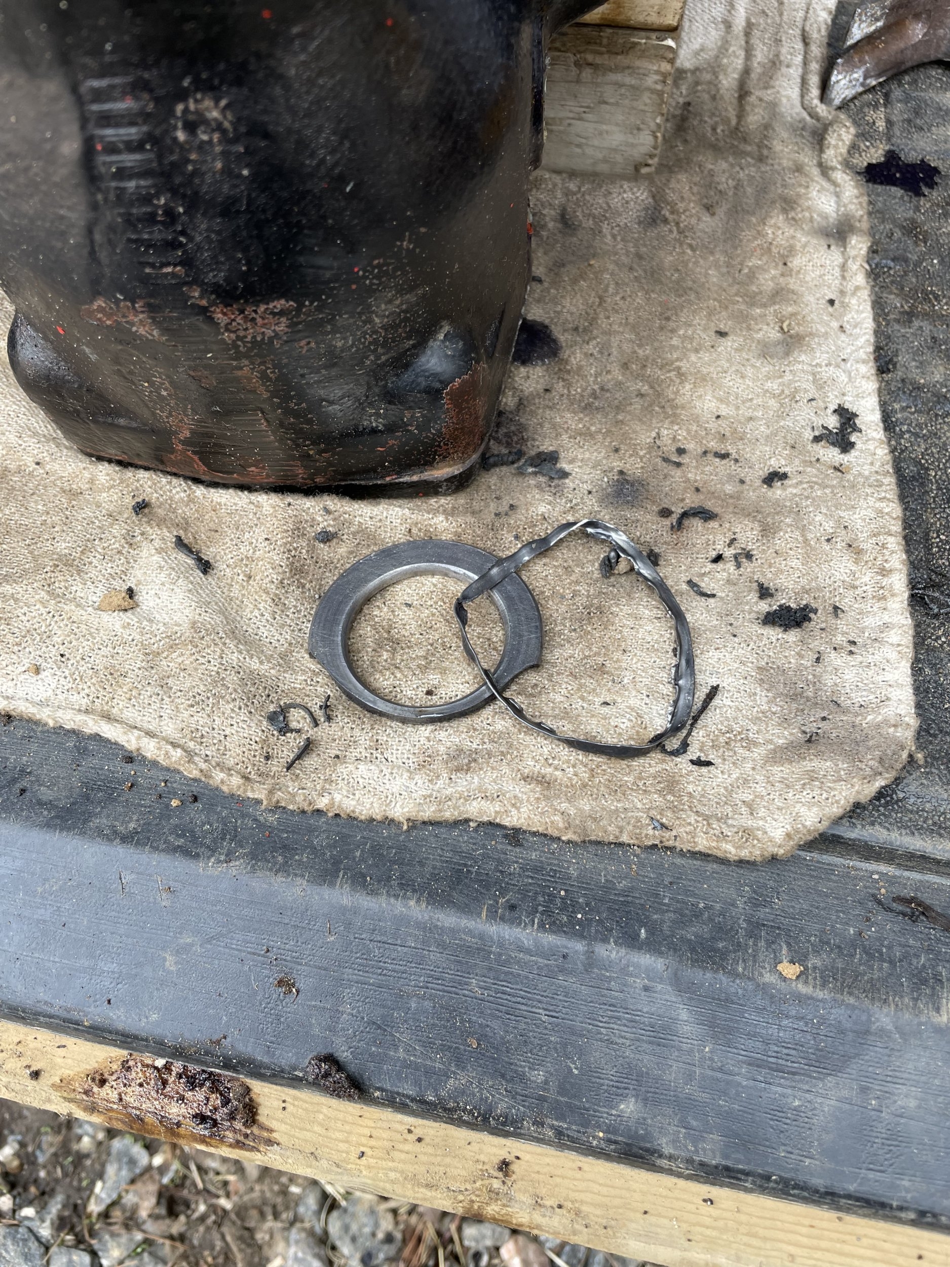

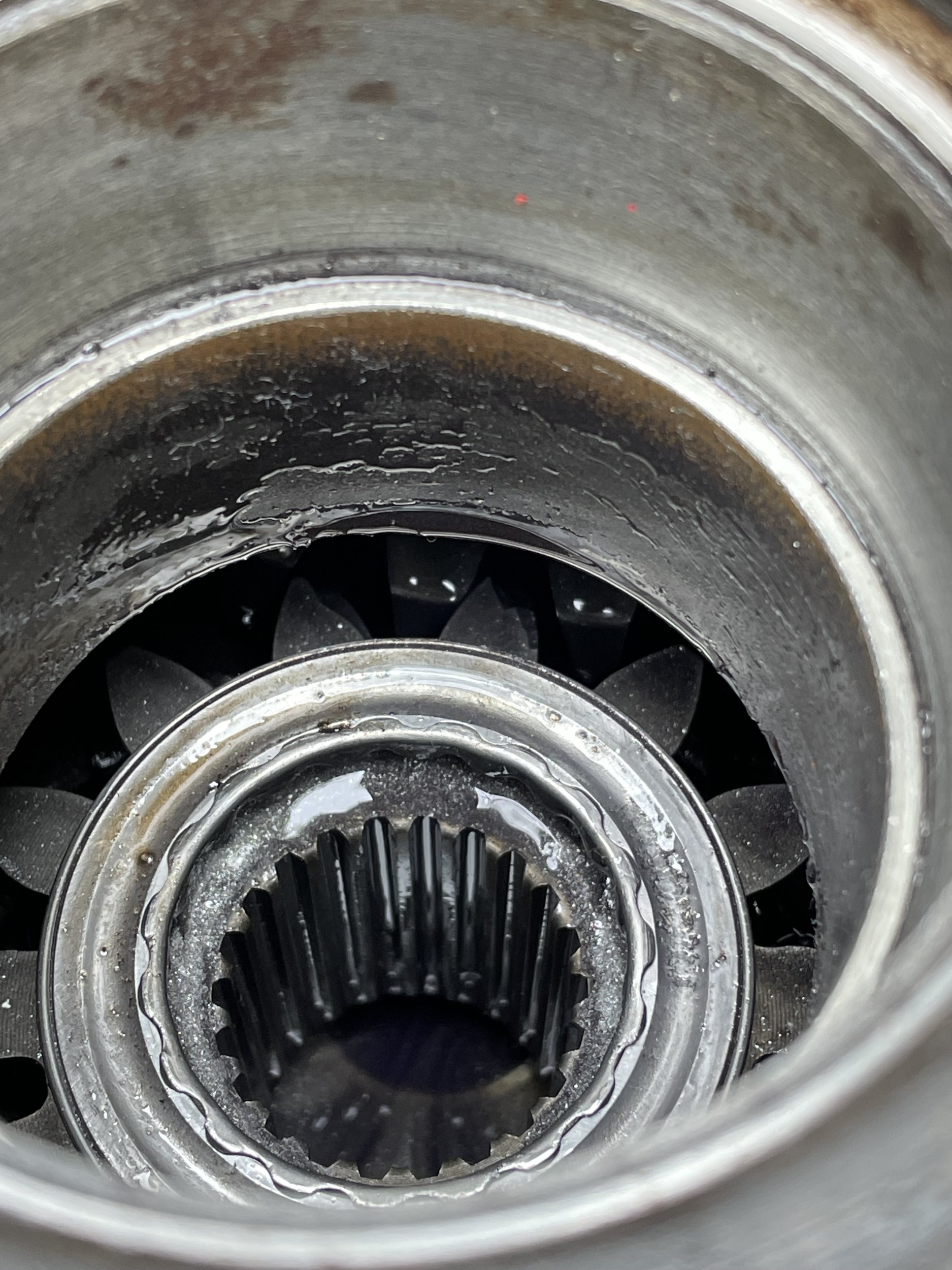

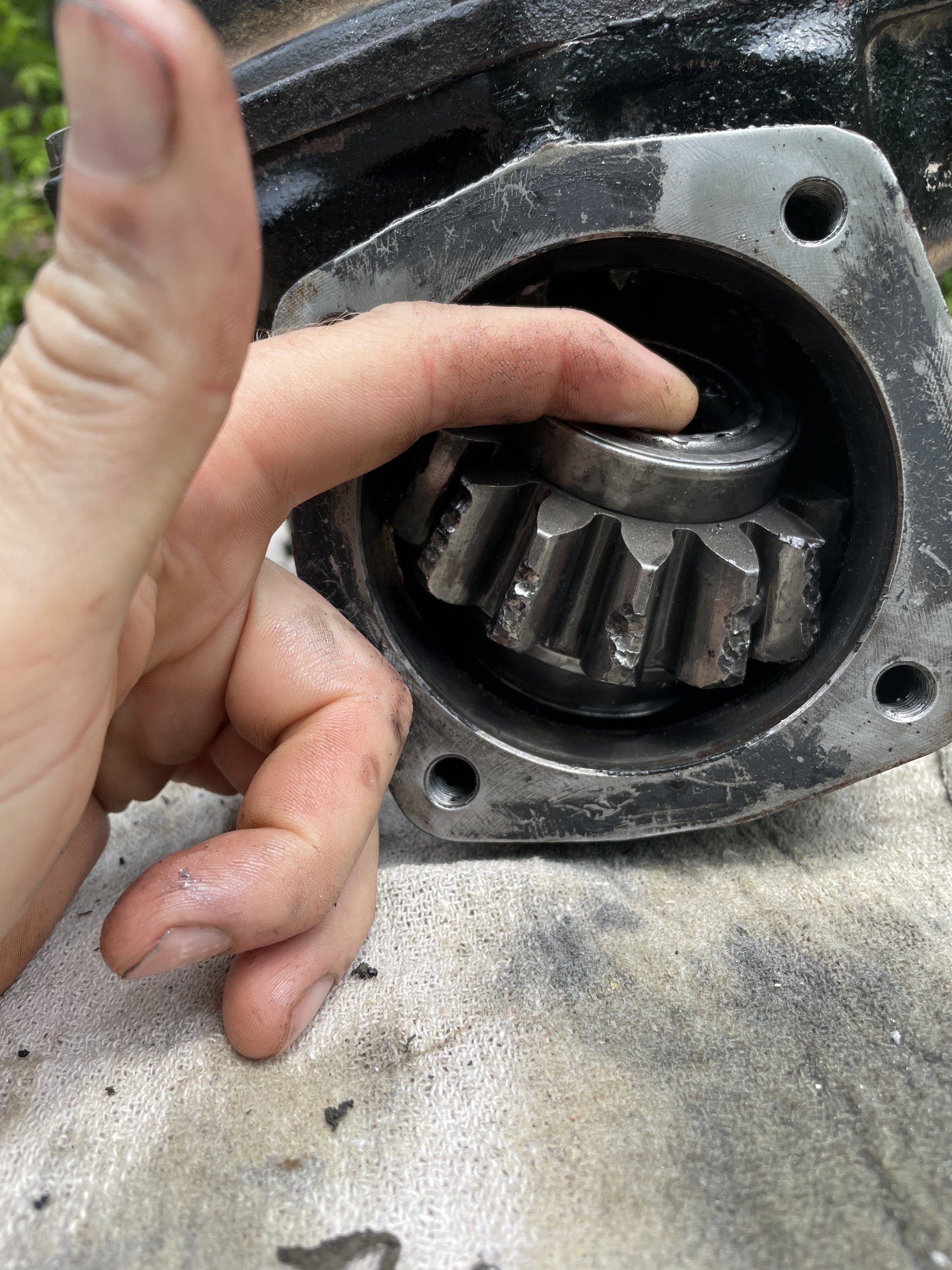

Upon further investigation, it looks like taking the hub assembly off was a good idea! The top bearing in the assembly had detonated, found it after draining the oil in the hub. There is a bit of damage to a few of the gears, hopefully that comes through in the pictures. I’ve got the dealer looking into the control arm and a filter set, i’m going to bring the hub to them and hope they can get it apart and find the bearing set / gear assembly.

As far as "drop-in," no. The bearing on the king pin will be pressed on. The races in the "king pin housing" (what we have been calling the control arm), are also pressed in. Same with the seal. But that cast is easy enough to do with a socket and light taps with a hammer. The bearing on the king pin will need to be pulled using a bearing puller, and the new one installed with some pressing. You can use a socket and hammer, but at your own risk. Just make sure your socket or pipe only contacts the inner ring of the new bearing. There should also be a bushing inside there that is free floating. Thats number 18 in ptsg's post above. All that is for the king pin housing/control arm. I forgot that your hub also needs rebuilding. Probably need the dealer (either LS or NH) for that.

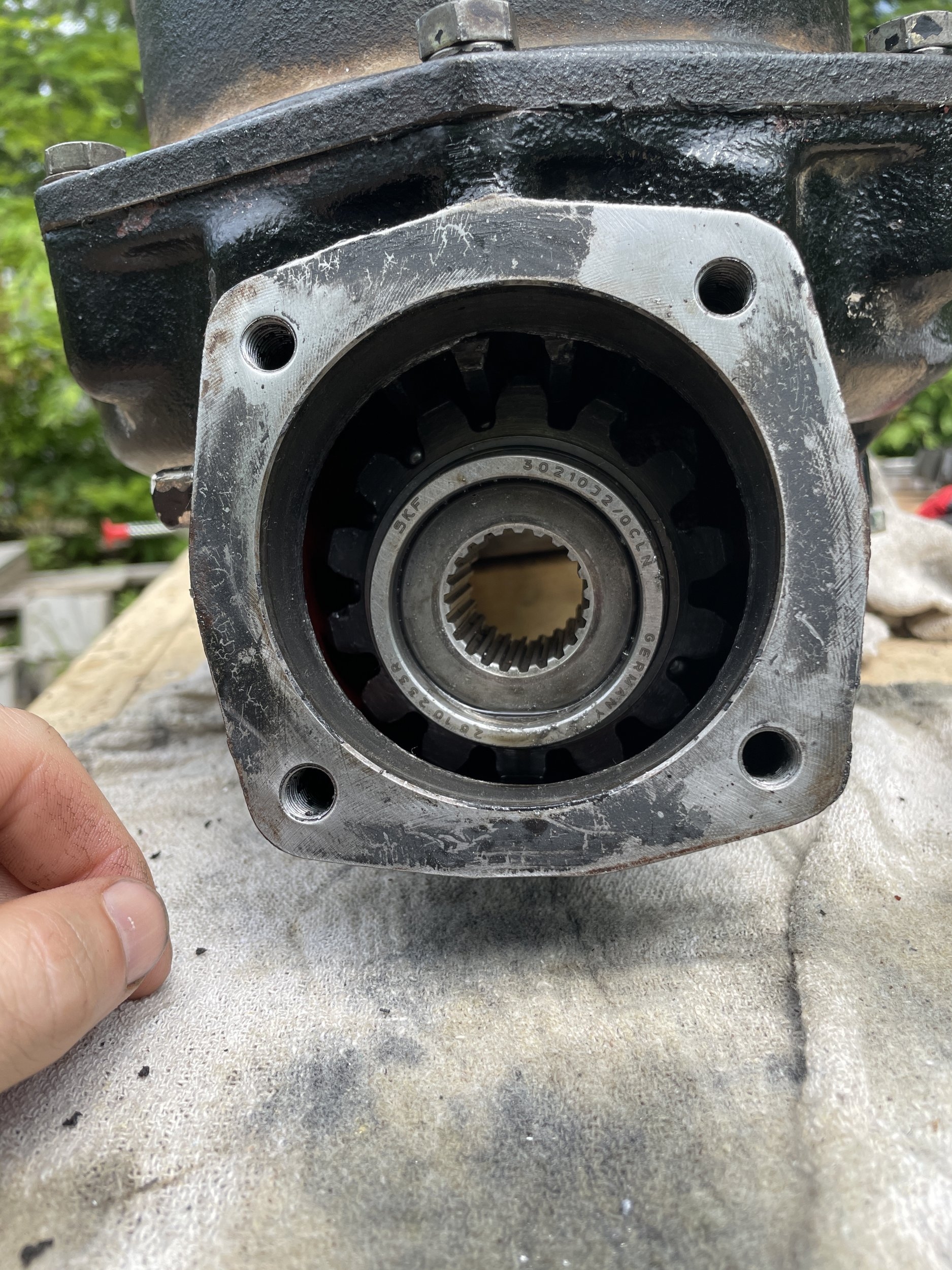

Finally have parts in hand and am trying to replace them. I cannot sort out how to get the taper bearing (40010341) out of the hub assembly. I’ve removed the cover (40036079) from the gear case (40008939) thinking it would drop right out the bottom, sadly, that is not the case. I’ve tried turning it to get a better angle for removal but the diameter is larger than the hole. It seems odd to need to remove the whole wheel hub assembly just to get that bearing out, that would be the only other option.

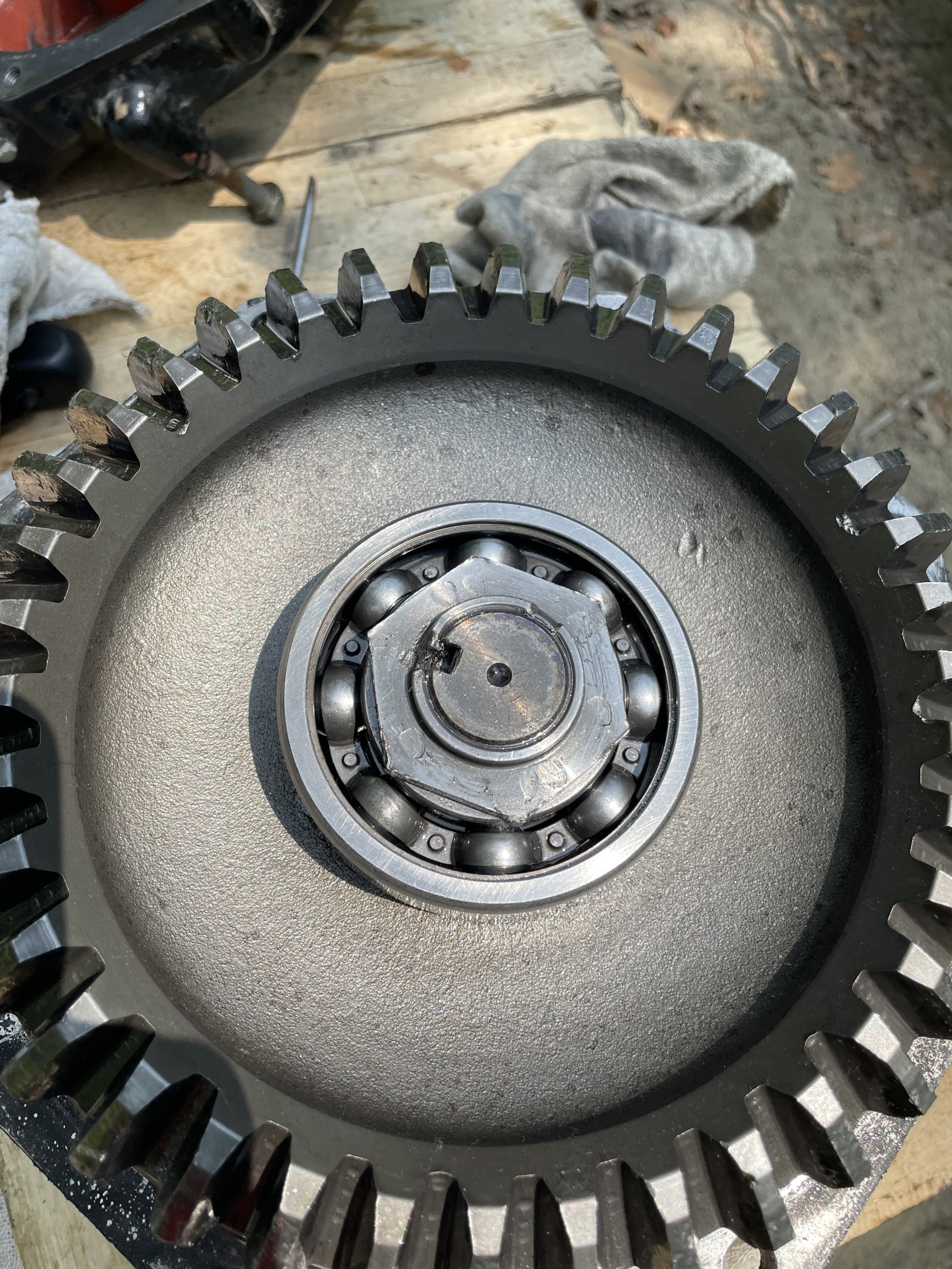

Got the hub assembly apart, gear is out. Will have to pull the bearing on the main gear tomorrow and get that gear off, there is a ton of metal sludge between it and the housing.
