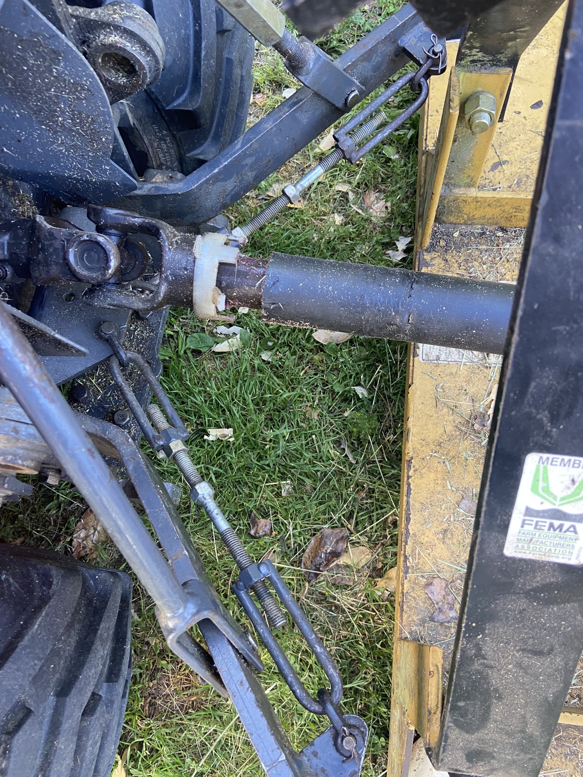

Hi! My lower link pin keeps popping out of my 3 point hitch when running my brush hog. It’s a 13” steel rod that goes through the lower arms & has a flat triangle shaped piece that curves over the rod & bolted on. That holds the adjustable stabilizers. Do I need to adjust the sway/stabilizers?.. Kim.

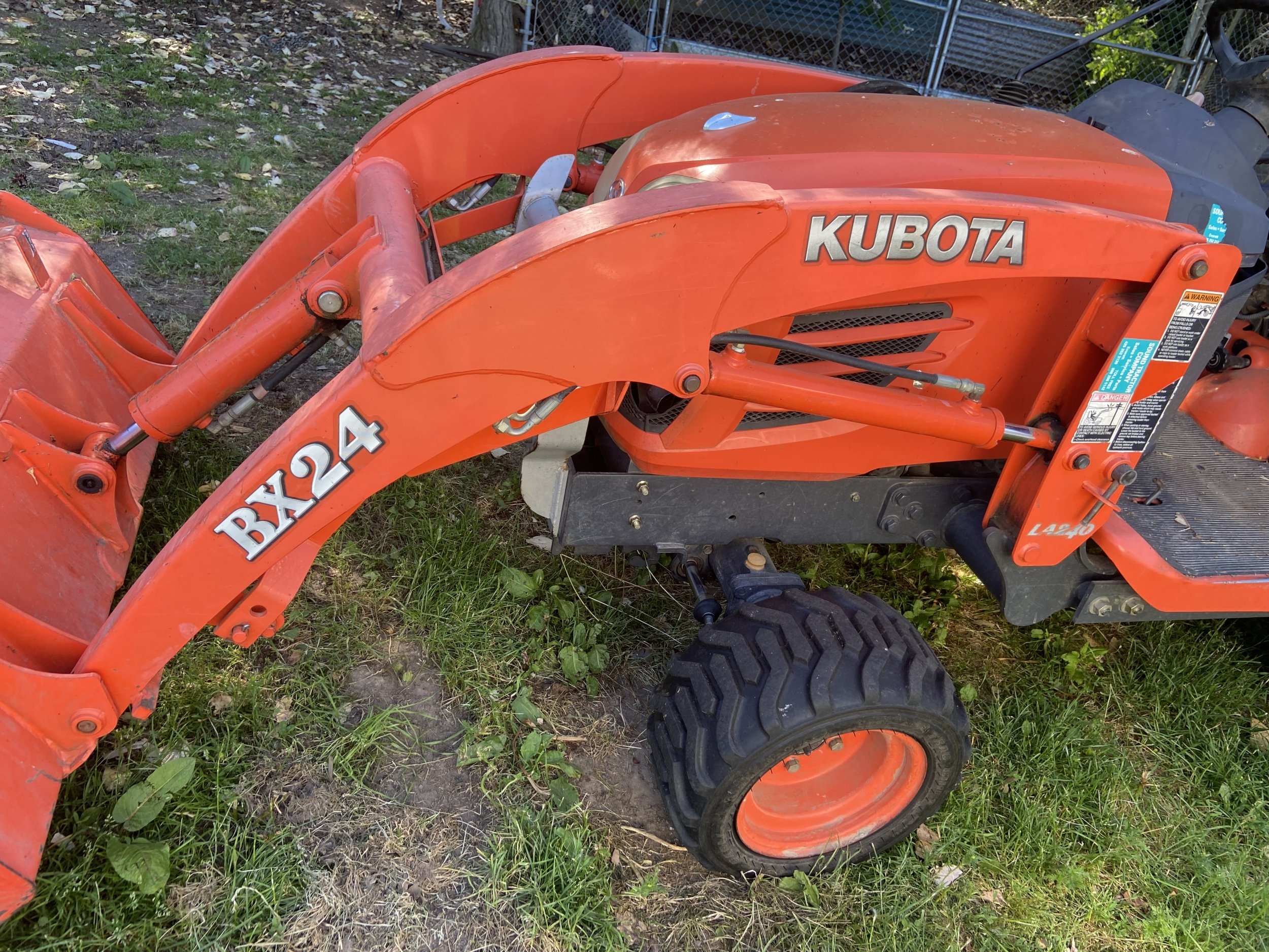

Can you post some pictures of what have and also provide make and or model of the tractor and bush hog.
   / Lower link pin #3
Kim - I'm a bit confused. A picture or two would sure help.

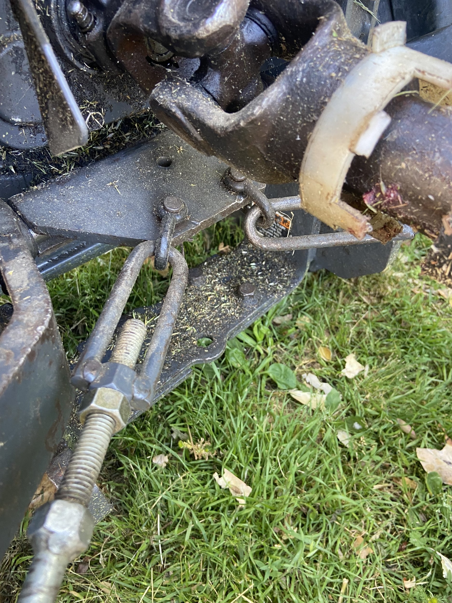

   / Lower link pin
Pictures of my Kurosawa, & the lower link pin & stabilizers..
   / Lower link pin

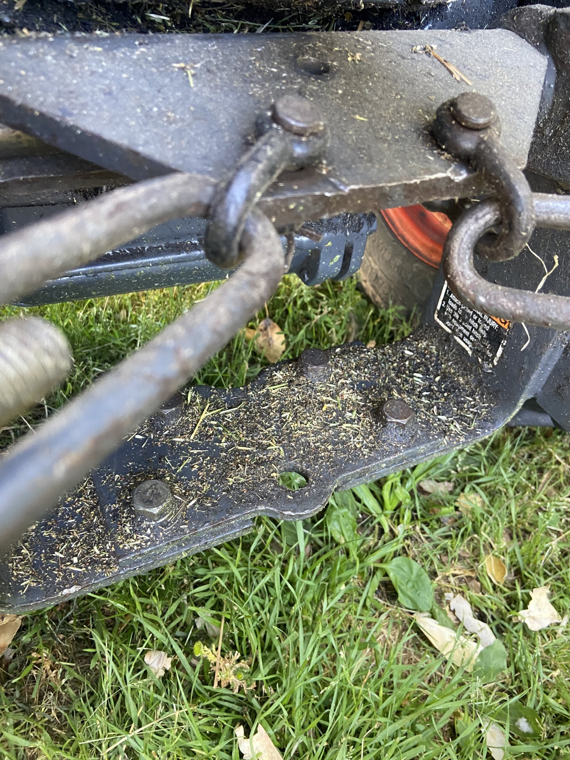

The 2nd picture is of the flat plate that hooks onto (curves over) the lower link pin.. I figured out how to tighten the stabilizers today.

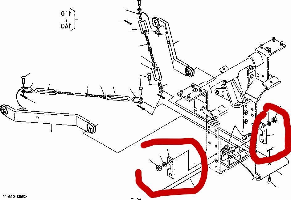

Unless there is big difference from the BX22 there are plated bolted to the frame on each end of the pin to keep the 13" shaft from coming out.
