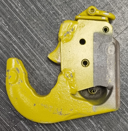

I just got sent some pics of the Walterscheid by their rep.
They are cast and assembled in Germany.
AMA told me that theirs are cast in India and assembled in Italy.
Pricewise the Waltersheid are around $1000 for the kit. The hooks on their own are only slightly less so not worth it because the balls off the shelf from other suppliers may not be a good fit.
Screenshot 2026-05-27 at 11-35-20 Walterscheid Tractor Attachment System (TAS) Catalogue 2021 ...png
The CBM are around $600 for a pair of hooks.
The AMA is around $340 similar to above kit.
