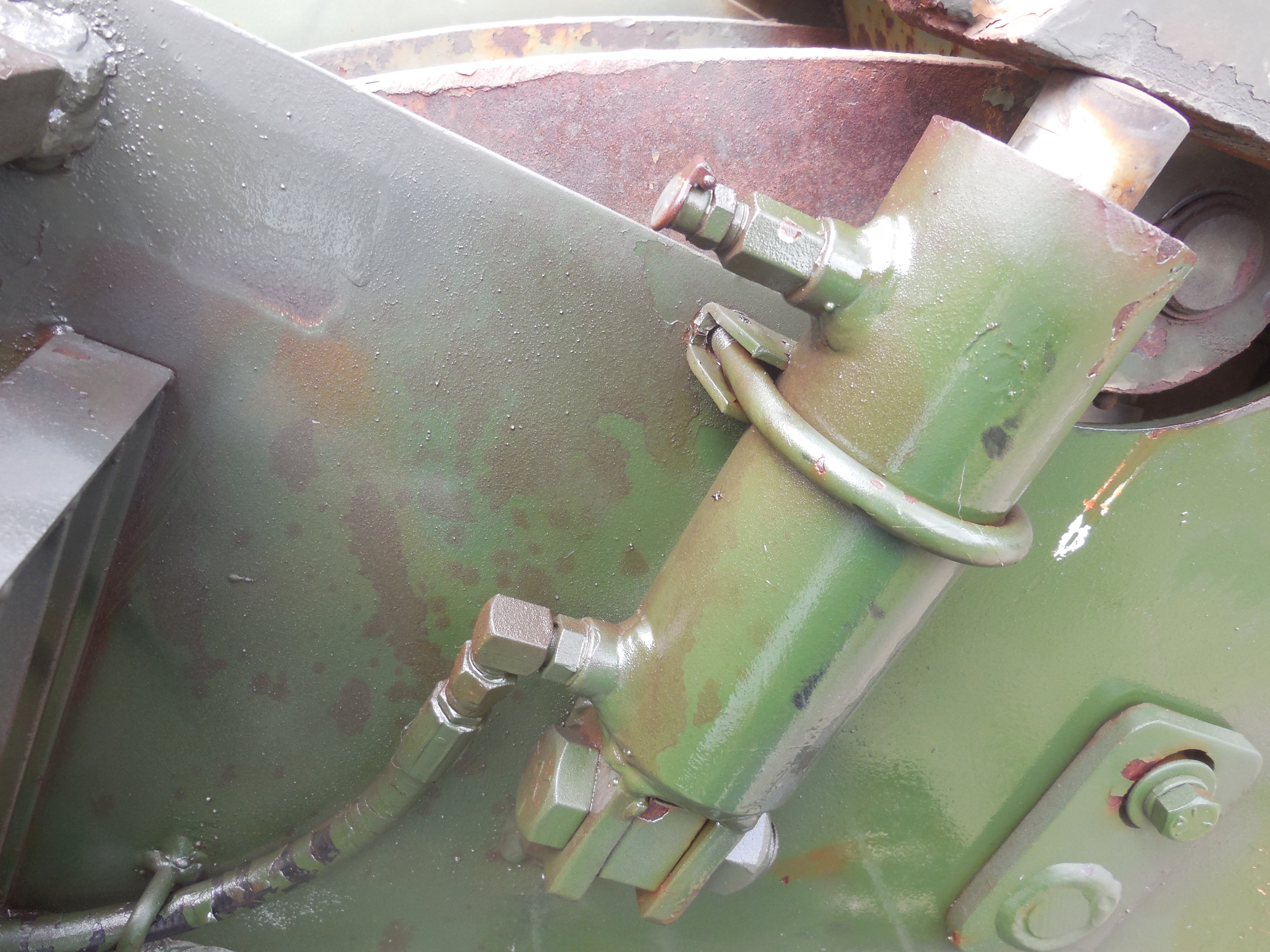

Speaking of leaks, has anyone seen a cylinder with only one hose and the other end with a mini flapper on it?
Well, it was more of a very enthusiastic spritz than a leak, but anyway.
/ Low hour used tractors #29
Well, it was more of a very enthusiastic spritz than a leak, but anyway.View attachment 3540044
That's a double acting cylinder being used as single acting. Usually the non used port gets a breather, instead of an oil cup meant, well, to oil things.
If it's leaking from there, you have bad piston seals in that cylinder.
Sometimes they also route that port straight to the tank using low pressure hose. This way there is no moisture that can possibly get in there and any leaks go straight to tank.
Thanks, that's what I figured it had to be. Just haven't seen a setup like this before.
If I'm lucky the seals are still good, but weren't good enough to keep fluid out while the cylinder was under pressure for several years.
Either way, a filter is probably in order since that vent is low and quite close to the trencher when in operation.
There is usually a residual amount of oil that can bypass even with good seals. Eventually, it accumulates enough oil on the rod side of the piston that when you extend it all the way, it will just gush all that oil out.
