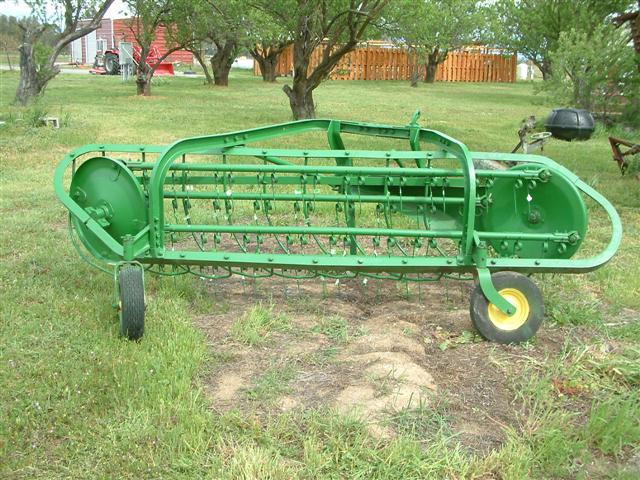

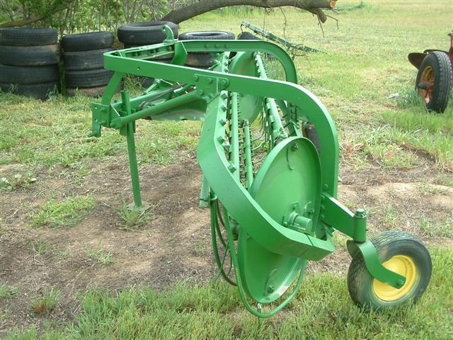

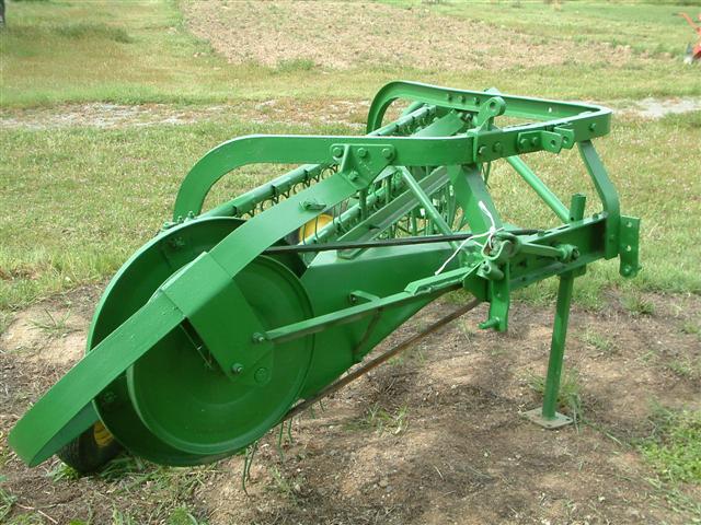

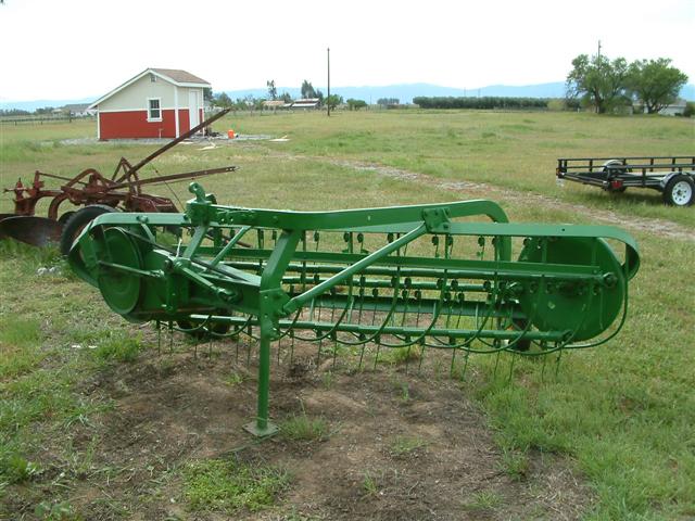

I bought this pre-owned JD 350 3pt side delivery rake a few years ago for $800.
These rakes show up on eBay a few times per year.
Good luck with your quest.

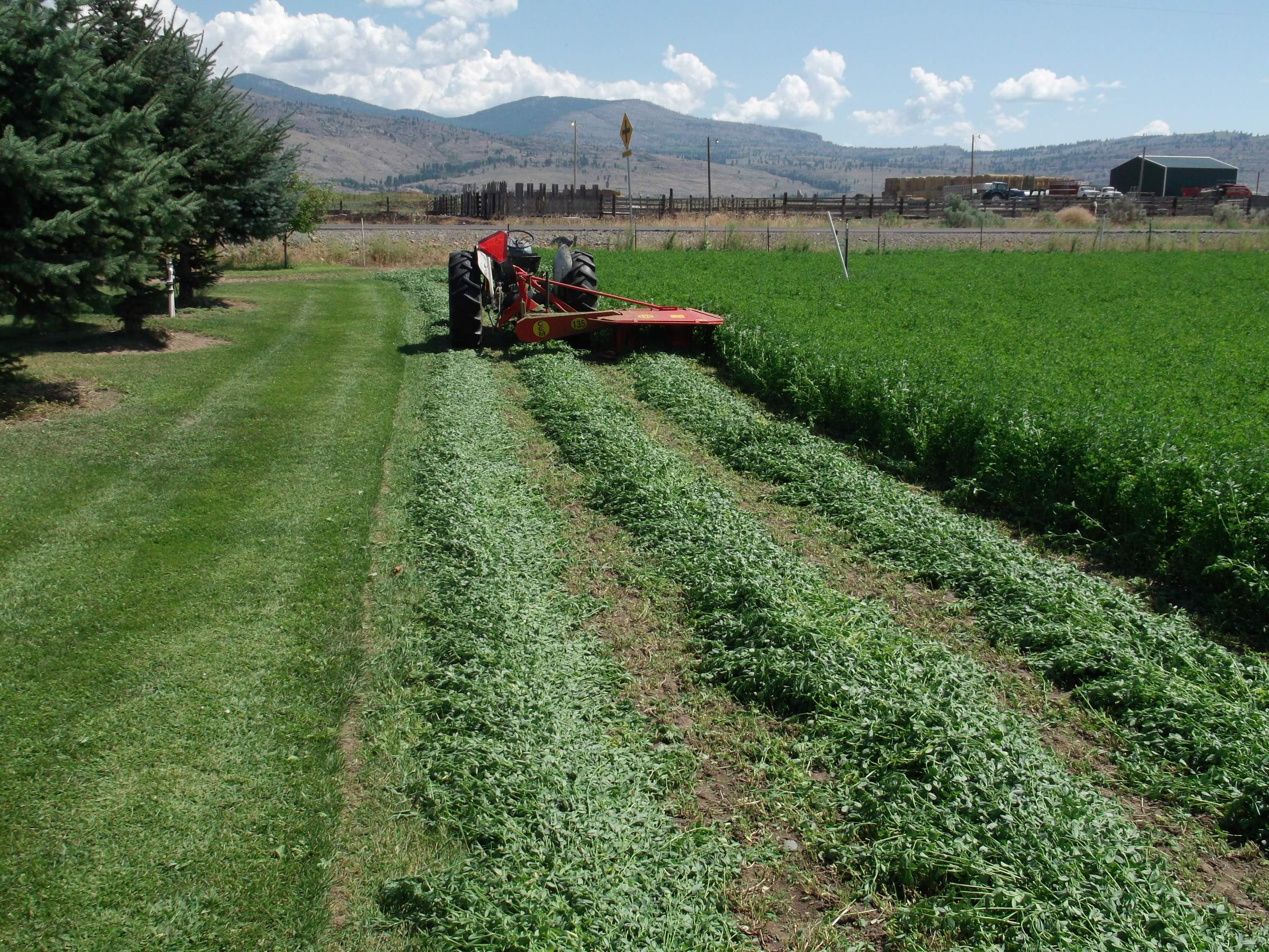

I use a 2 wheel rake I modified from a 4 wheel rake... 4 wheels made too large a windrow and it took too long to dry... I turn with the 2 wheels and combine 5 rows into one... takes awhile to get it done but my alfalfa is dry and baled in 3-4 days, depending on the weather... then the water gets turned back on... I get 4 cuttings using that method... 30-32 days per cutting..
Wheel rakes don't throw the alfala too hard so there's no or little leaf loss unless it gets too dry...
Most, if not all wheel rakes, can be "adjusted" to spread the hay or windrow... Getting them set up to do a good job of raking takes some time... balance of the spring tension... left and right tilt for even ground contact... but they do a good job when adjusted correctly.... I've seen rakes with bent tines... folks put too much ground pressure on them... the tines should just "tickle" the ground, so as to not throw dirt into the hay...
