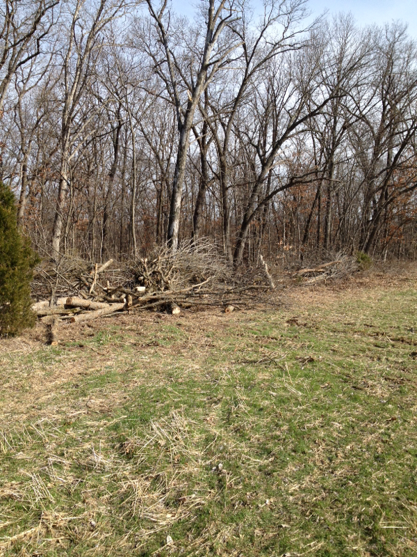

Thanks!! I'd like to meet up with you guys some day to discuss a million things. From FEL tips to brush cutter set up, and I haven't even touched maintenance yet! Following the OPs manual though.

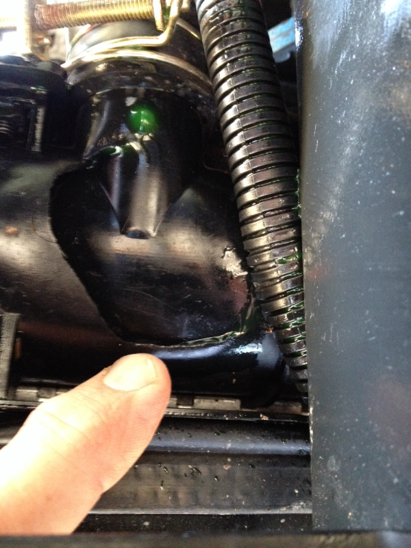

Glad I didn't break that cylinder. It was one of those days, when I cracked the radiator, just figured I'd messed that up somehow also.
Enjoying the morning out in the field this morning, but looking for a gobbler to come by.
