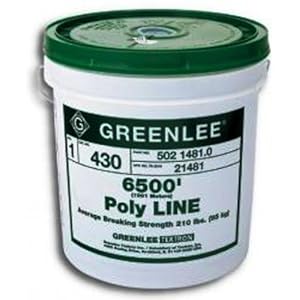

1500 ft isn't a problem
Use a bucket of jet line and a plastic bag stuffed with more bags to make a mouse the bucket of line will be less than $40.00 and a vacuum cleaner to suck the "mouse" through the pipe!

I've got a huge job coming up, and I could use advice on technique.
After years of petitioning, the Power Company has consented to provide electricity to my isolated acreage in the VA mountains.
I have agreed to trench 36" underground from my service drop location to the nearest power pole, and put in 3" conduit with pull rope so that when the Power Co comes, they only need to pull the main feed (600A) cable from the nearest pole to my service drop.
Here's what makes it interesting: This is not going to be like pulling Cat5 through 40-50 feet. It's going to be a 1500 foot-long distance. With BEEG honking cable. Power Co has to pull the cable (thank Dog) but what is the best way to set up rope to pull through 1500 feet of 3" schedule 40 electrical conduit in a trench?
How do the pros do this? In 30 50-foot segments? 15 100-foot segments? Clearly I can't get a 1500 foot rope (and if I could, can you imagine trying to pull a cable that big that far? Ay yi yi...)
If I want the PowerCo guys to be able to work uninterrupted, do I need 30 50-foot ropes? What seemed conceptually simple (how hard can it be, you thread rope through a 3" pipe) becomes not so simple when I get to the details.
Who's been there? What's the right way to do this (besides subbing the job out)? I'm all ears, friends. Can you help me figure this one out?

We are about 1800 feet off road. In 2002, I installed (glued) conduit myself (4 foot deep trench required) and fed a Greenlee pull string through as we went. Yes, did it the hard way.
Our co-op required a pull box every 1000 feet max, and when walking job with their field engineer we decided to put an extra one on each side of a creek we went under, as the line elevation dropped several feet into the creek and then back out. This required two extra pull boxes, but eliminated elbow down into creek and back out. Still had to have one from the vertical down creek bank and back up other side. They also required all the elbows to be metal long sweep elbows, not plastic for that length of pull. We used 2 inch conduit.
