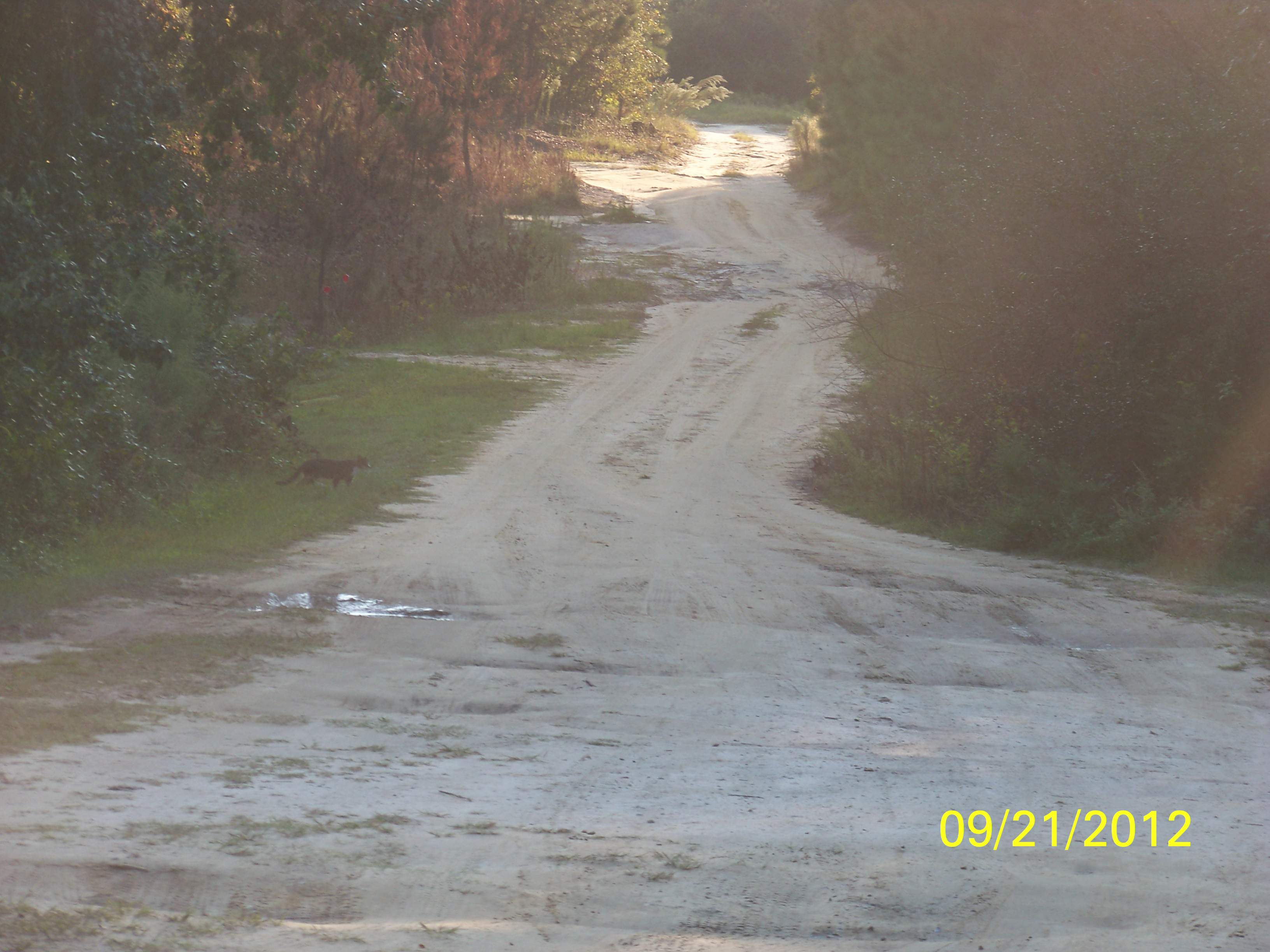

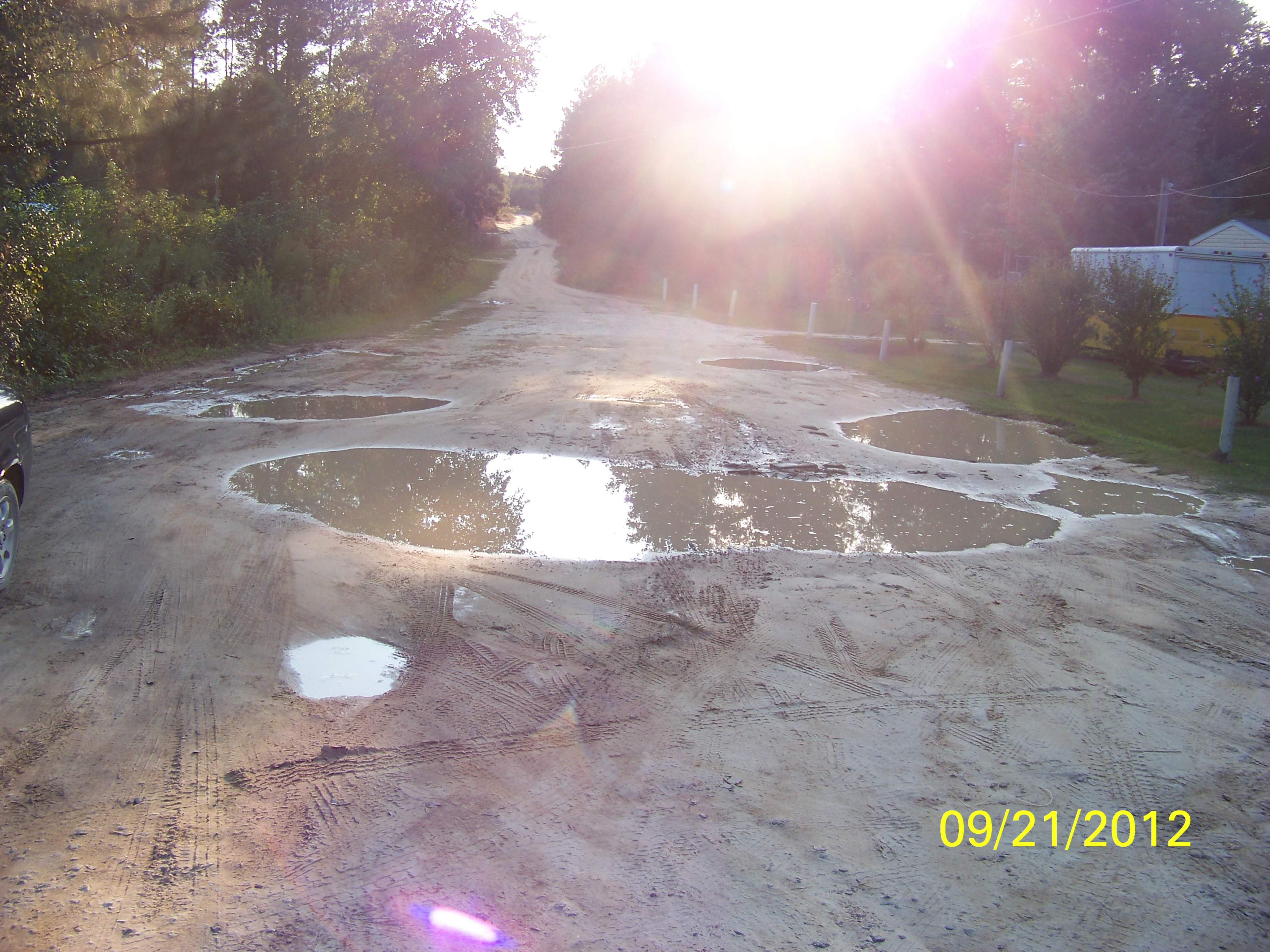

These first two pics are where I am staying now, as you can see the driveway to my property is in very bad shape. I would like to fix it up while I am still here, four other families share this road and most are either out of work or retired so money wise no help. I already asked about fixing the road professionally but I would have to pay for it myself, still wanna help them b4 i leave.

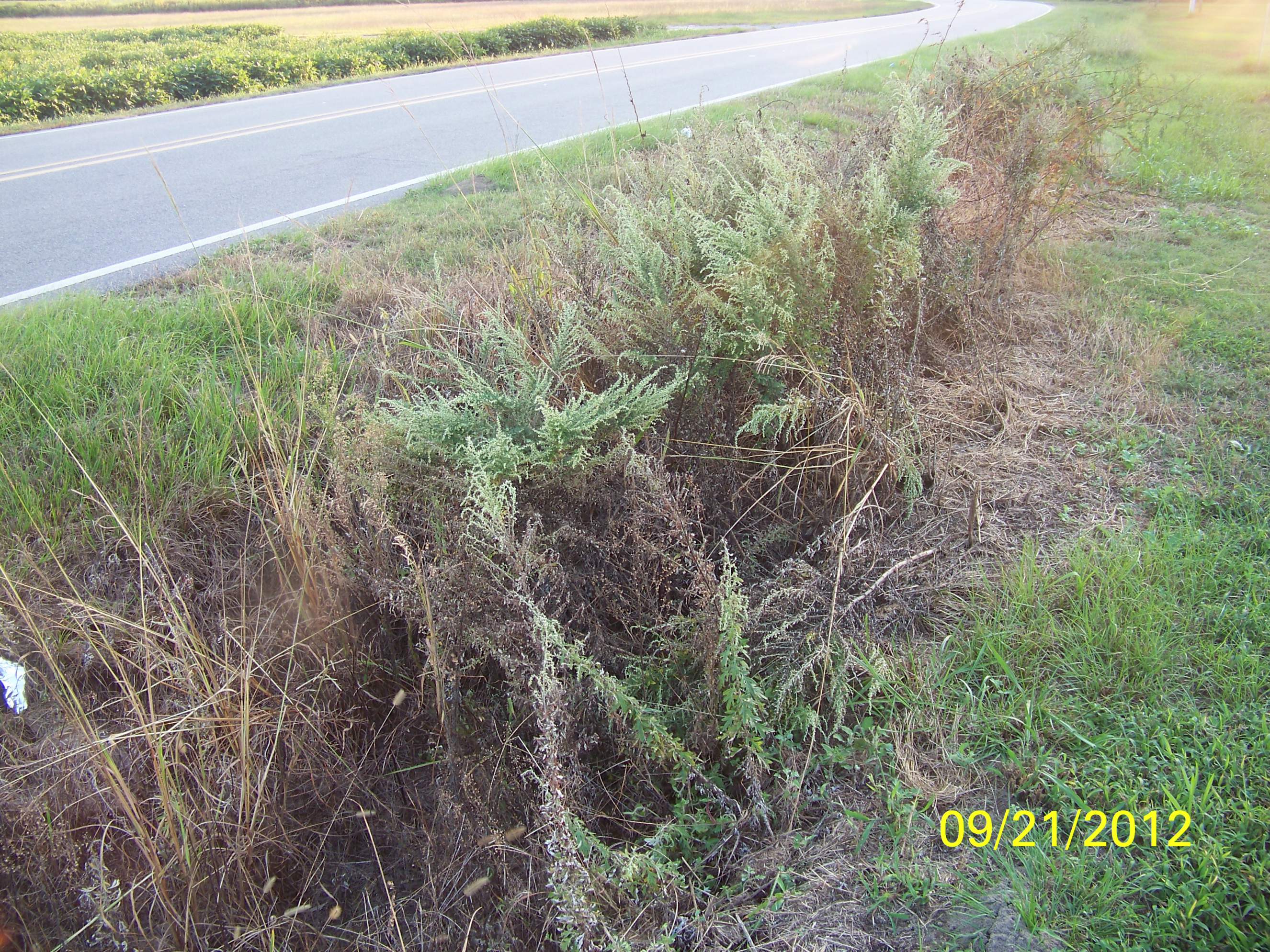

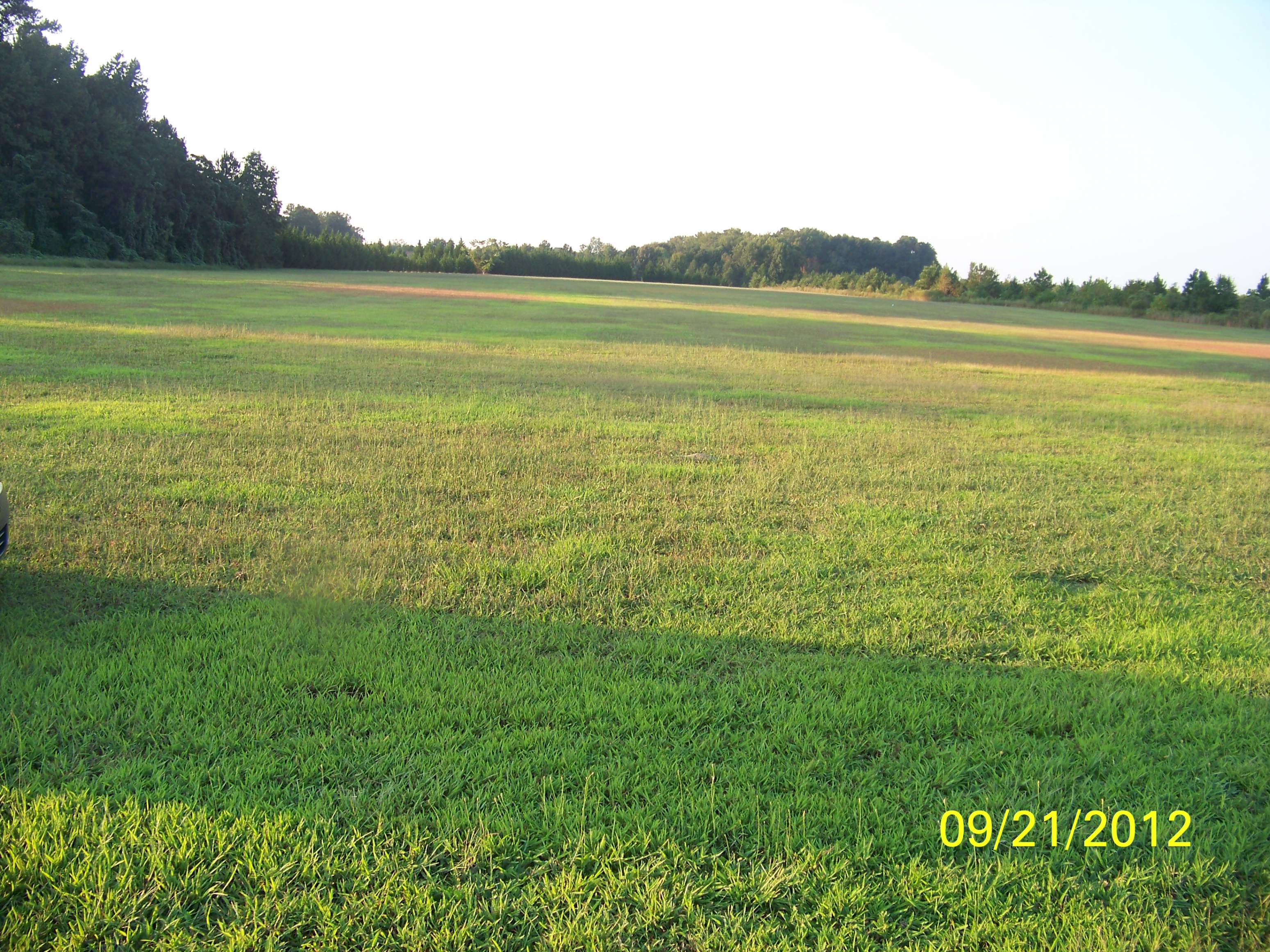

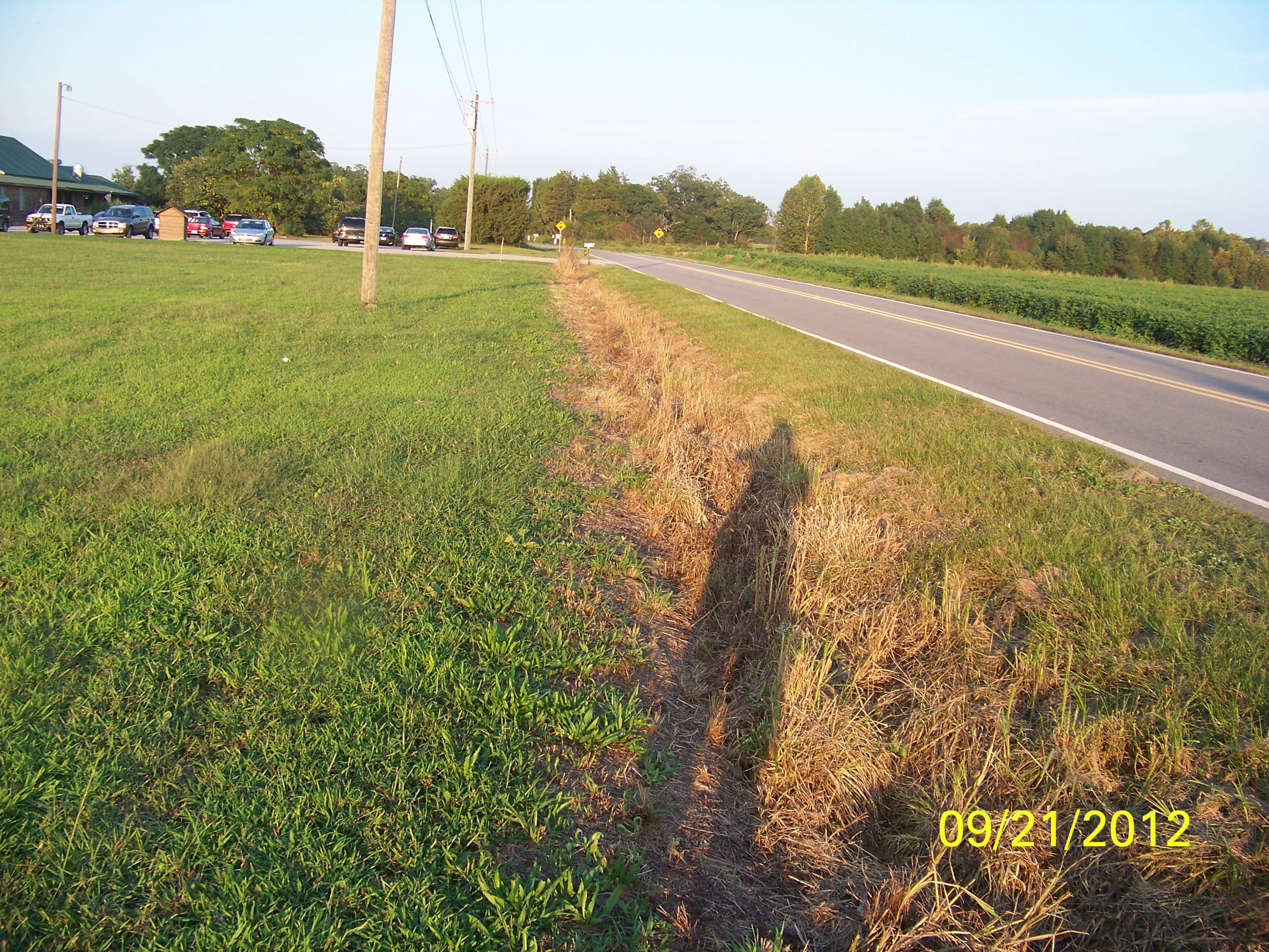

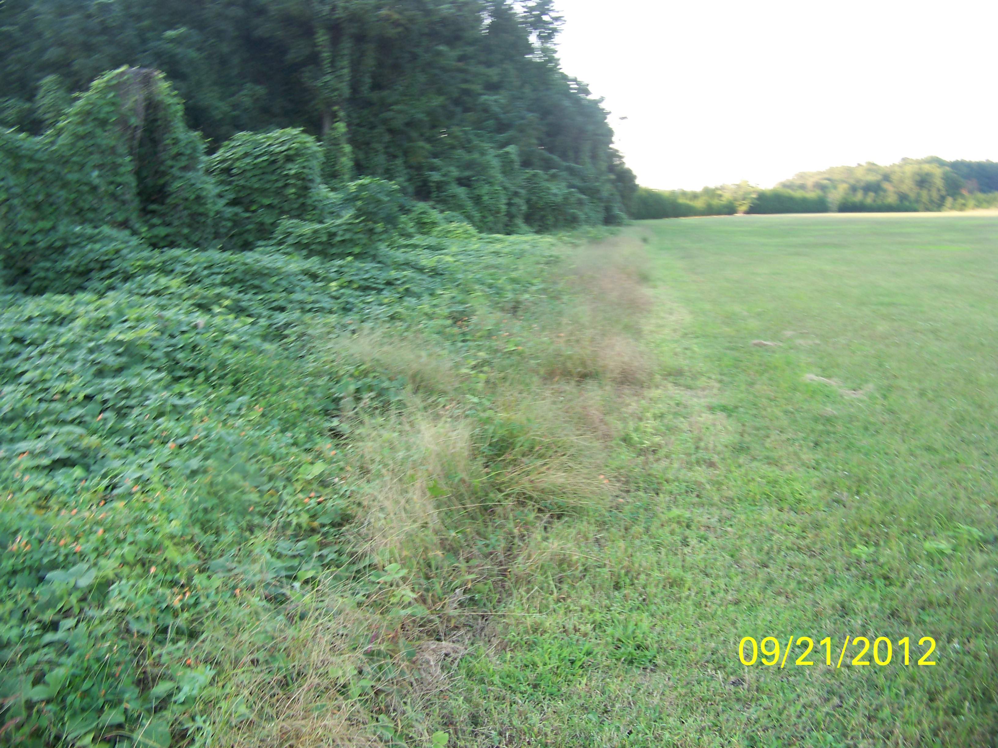

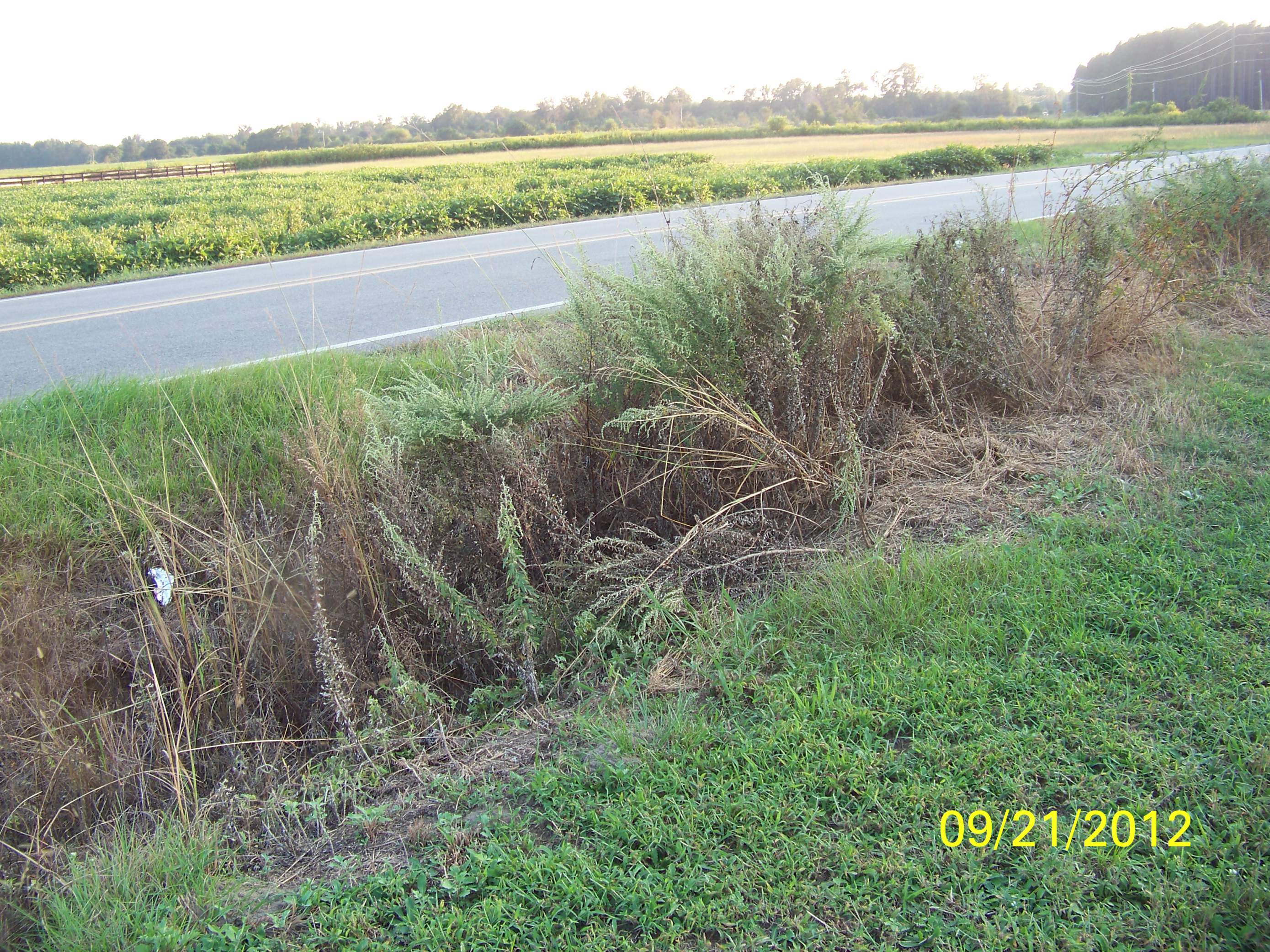

The other 4 are from my property i will be moving on, lot nicer i think, but still needs some work. The pic with the vines in it and the ditch will be about as big as i will need to cut and very little of that. The long pic is standing near the road shooting to the back of the property, the trees are my property line, so you can see how far it goes back and 320 feet of road frontage. Just thought it might help in deciding the implements i may need....thanks

The pics kinda help but it still hard tell by not seeing it in person. The road where you currently live looks like it could benfit from being crowned and having some ditch along the sides. I would get some 21A to fill in the pot holes. They pack extremely tight. If you get a truck load it needs to be spread that day, it has to be spread wet. I think it has some concrete in it to help hold it in place. A tractor with a FEL and a box blade should do a pretty good job.
The pics of you property out by the road in the ditch look like to me that would be tough to run a tractor across. I would use a Trimmer with bike handle and a brush cutter on it, something like a stihl fs90. Do you plan on finish mowing all of that in the picture? If you do I would go with the biggest finish mower your whatever tractor you get can pull.

There are lots of good compact tractor brands to choose from, I prefer Deere but for a 9 acre rectangle that is flat I don't think it makes much difference what brand you get. First thing I would do is take some samples in for soil anaylsis. So far I think just to fix this up I think I would hire out discing and harrowing for a one shot deal. I would buy a 3PH spin spreader to put out seed and fertilizer, you will need to do this ongoing so buy this tool. I would inquire of the local coop's to see if they have trucks to spread lime if your analysis indicates a need for it. I would look for a good 30 to 40 hp tractor with a fel and rear finish mower to maintain the grass. For the driveway maintenance (don't see it yet) if it is long I would get a good rearblade and a 6' wide landplane.
Clearing the property line might be tough with limited equipment at your disposal. Looking at the pictures I was wondering if that growth is covering up a mess of old brush piles and stumps, bet there is a reason the open area is cut close and this growth is still there. I don't think I would buy the equipment to tackle that work because it is a one shot deal, clean it out once and maintain it. If it is just some overgrown brush without a woodpile beneath it then hire someone to brush hog it once as low as you can and work with it from that point on.
I think it is importantto recognize that your land is 95% clear already. If you are anticipating building a house and money is tight I would have someone else with large equipment do the major work because a large wide disk and finish tools will give you a smoother end product. Once you get it smoothed out a couple of zero turn mowers should be able to mow it at or near full speed. I think hiring out the tillage work will be the cheapest way to go too assuming you have some farmers nearby, most i have ever known were always looking for cash sidework. Right now is a good time to plant most grasses and I would recommend it if your soil analysis doesn't show to low a ph. If you do need lots of lime then I would get that incorporated into the soil now and let it work over the winter and plant in the spring.
Using my method I think will be the cheapest way out and gives you the abilty to take your time shopping for the right tractor. I really prefer hydrostatic drive tractors for my close quarters work but that said I could easily see using my older 820 (31 pto hp) gear tractor to mow your place in a couple of hours. This tractor will be 40 yrs old this spring '13 and is as good as it ever was. I checked Tractorhouse and machinefinder this morning to get an idea of the price and I suspect about $6000 to $7000 is about right. The point is you can find a good used 30 to 40hp 2wd tractor in good condition and add a few attachments without breaking the bank.
