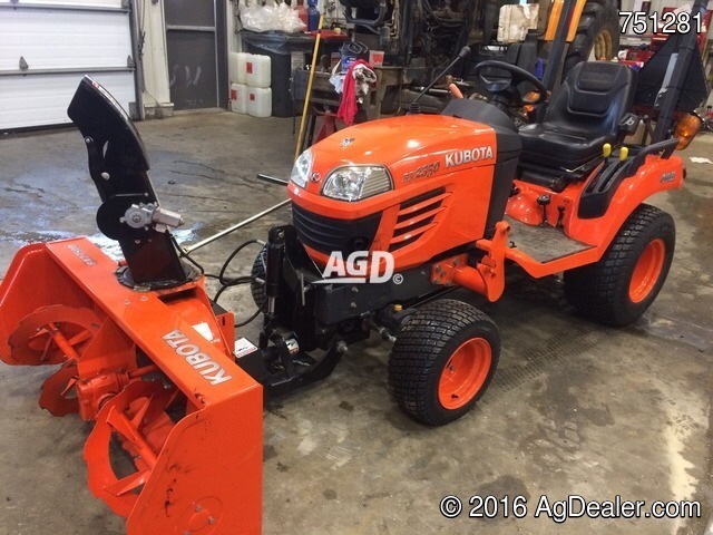

Choose which snow blower you want to buy first, then buy a tractor with enough weight a power to operate it.
Since you're on less than one acre, a Kubota BX with front mount snow blower might be a good baseline with which to start your comparisons.

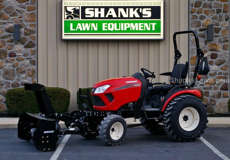

/ Looking to buy first tractor #5
One of these would work nicely.
Front mount snow blowers aren't cheap. Plan on spending around $3k for the blower, front chassis mount, and extended PTO shaft to reach the mid PTO.
I would avoid the proprietary belt driven snow blowers found on some garden tractors. They have a tendency to go through belts pretty quick and they don't fit all tractors.
