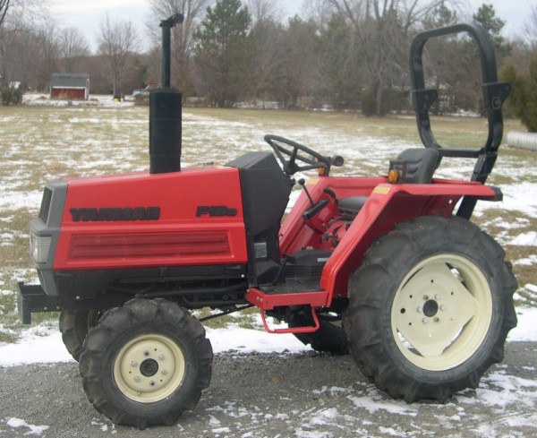

Someone;) has a nice F18D and it comes with an operation manual as well as a parts book full of exploded diagrams. And a ROPS. And an OR coupler.
/ Looking into an f series... #4
I think that unit is in Ohio.

Might want to check into that one.
