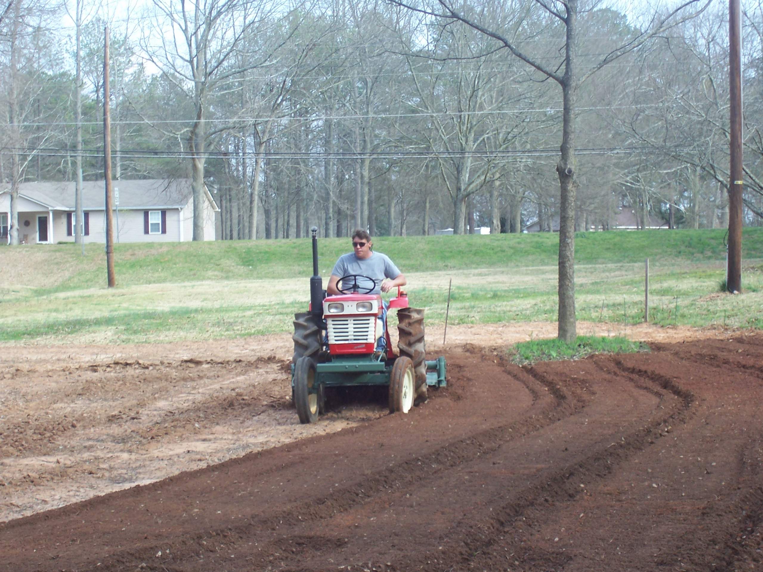

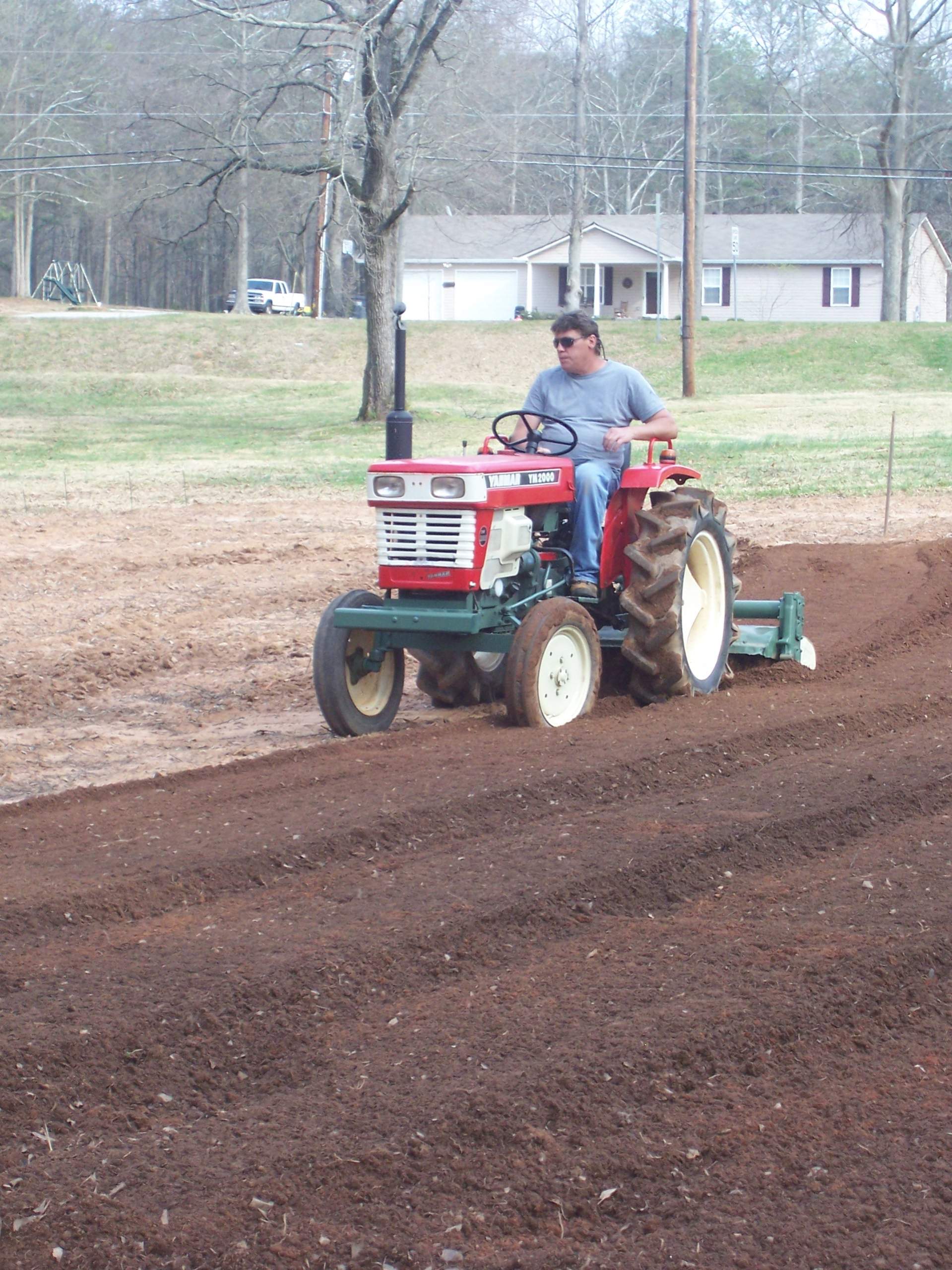

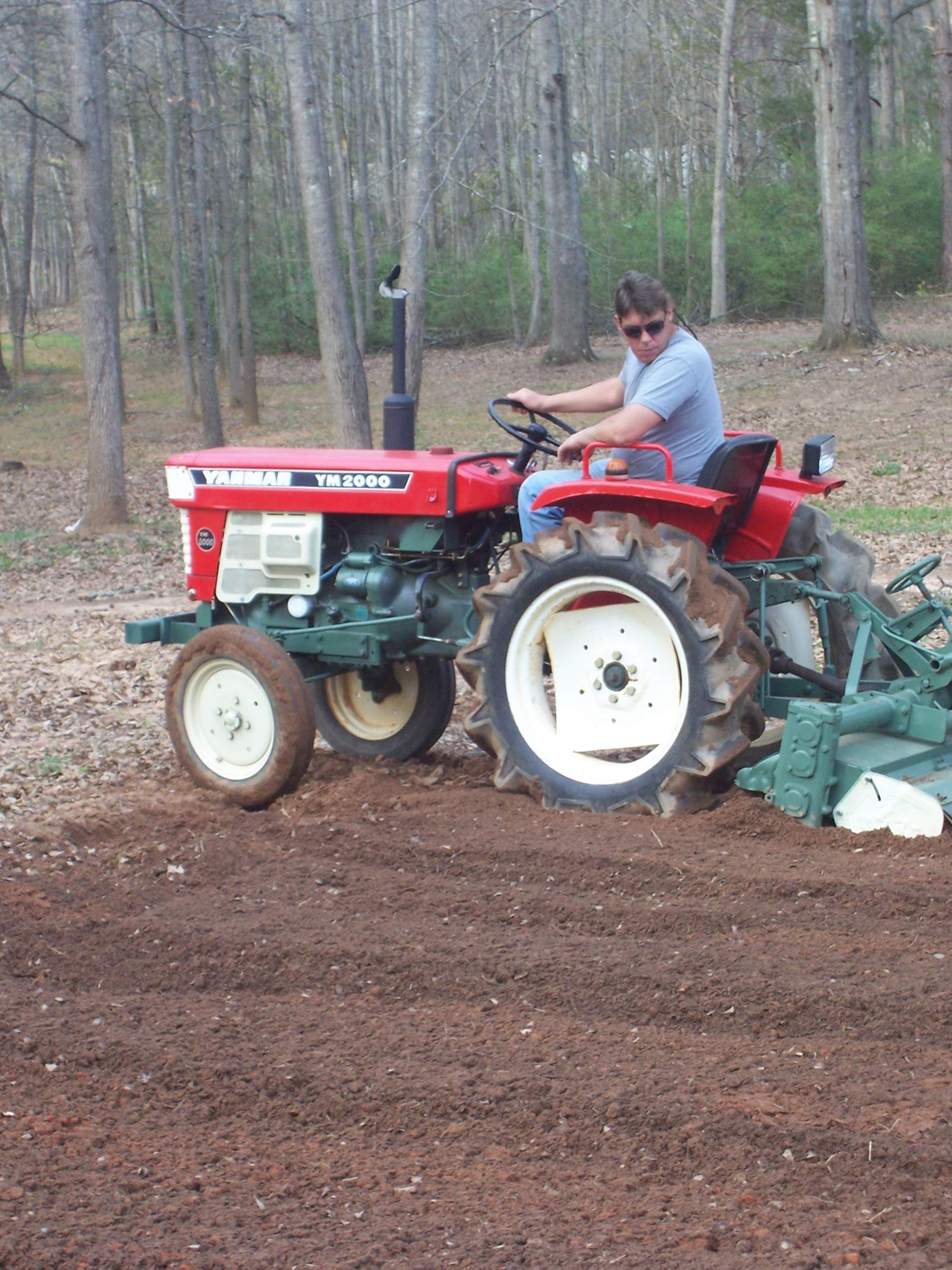

Here are a few pics of a YM2000 and RS1400.Just wanted to show how pleased and what a good job it does on a small garden.I broke the ground in January and now getting ready to plant.I had to make a couple of passes earlier this but it looks like just one will do it from now on.So now it's time to pull the tiller and get ready to start mowing.My GM.is still my favorite and looking forward to start cutting, Just Love It:)
Carey, where did you hook up your work light?
/ Looking for Tiller for a YM2000 #7
Here's the wiring diagram.There should be a lead off of your fuse panel.But on mine had to go look to remember for sure the way the previous owner wired it there must have been a problem with the factory lead most likely to keep from blowing the fuse.They ran a dedicated line pos. with a inline fuse from the battery using a marine type battery conector to a toggle switch mounted on the dash to the light fishing the wire through the fender.Then they grounded it to the bolt for the handle on the fender.look closely to the side pic of my tractor and it's ran through the plastic blue caseing by the starter.
Hey, where's your tiller's wheels??? Great looking job. At which pto speed were you running??
/ Looking for Tiller for a YM2000 #13
The supports were damaged so they were removed.I noticed that other models didn't have them and others post that they didn't use them for various reasons.I will admit that they would be nice to have when attaching it to the tractor but it's not all that bad after doing it a couple of times.
I tilled it in Jan. for the first time not knowing what to expect the 1st. pass was in 1st gear then I made another pass in 2nd gear pto. fluffed it up nice.The pics. you are looking at I did a couple of weeks back in 1st. pto.
My spec. sheet lists the 3 pto gears at 588,730,1260 RPM.If 3rd was used it would probably turn it to dust.
