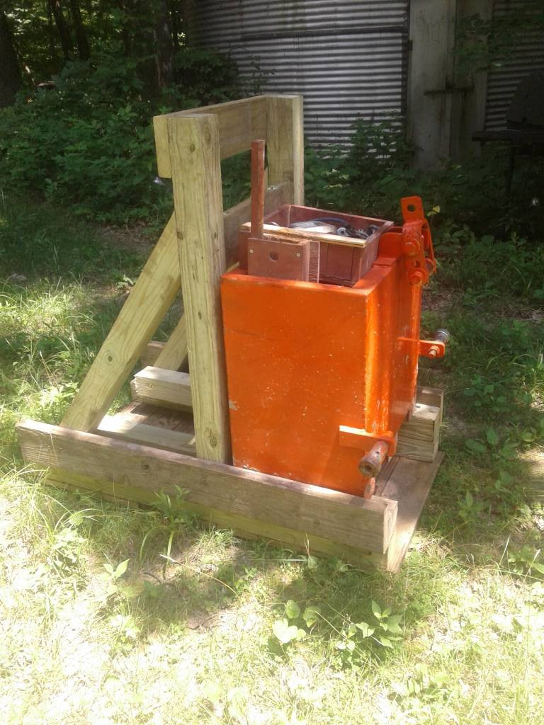

Titan box - homemade stand

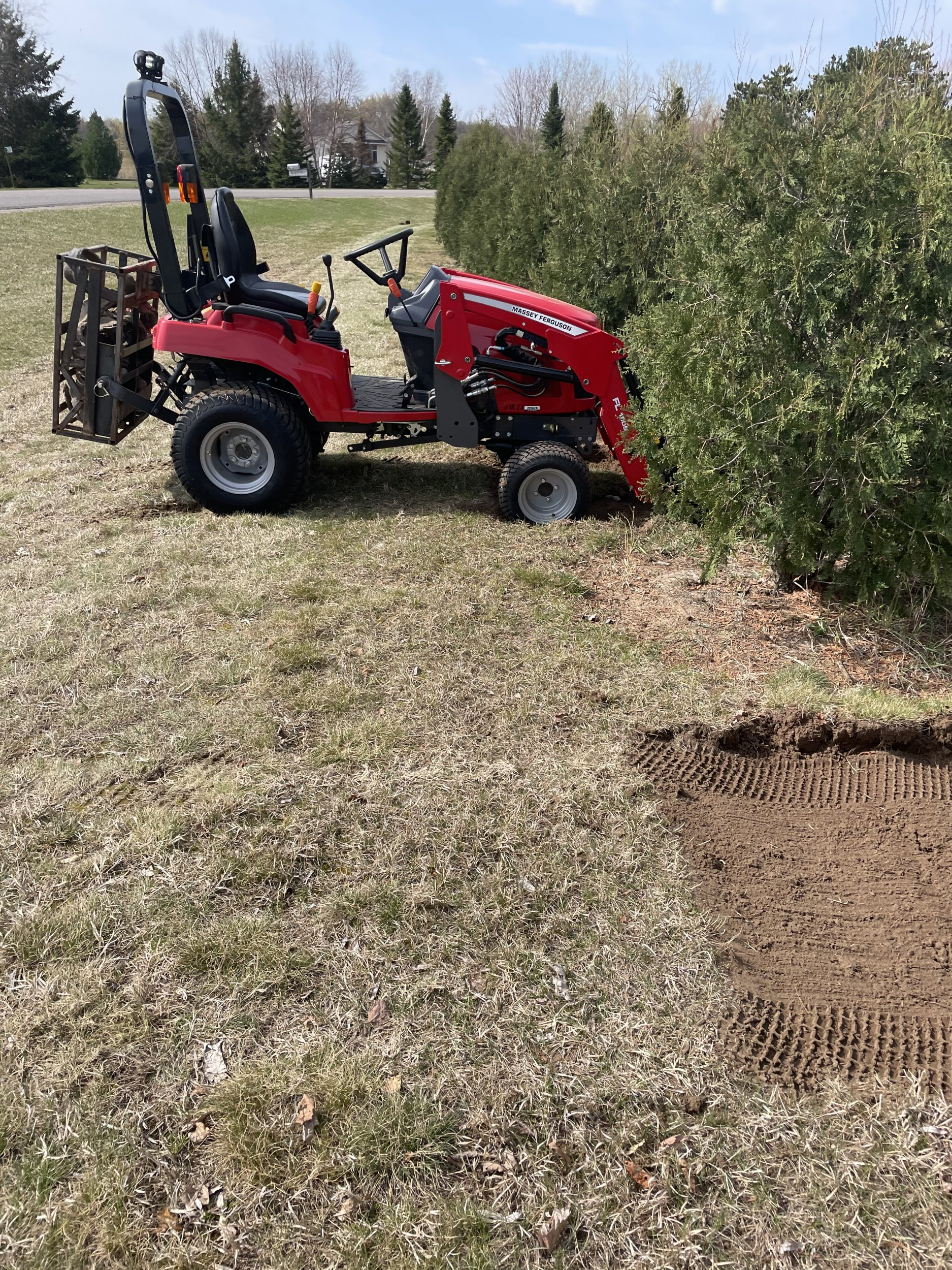

Scrap steel welded into a box, filled with lead water main gaskets. The Cat 1 pins were bought online.
/ Looking for some rear ballast ideas
Cheap and easy. I like it

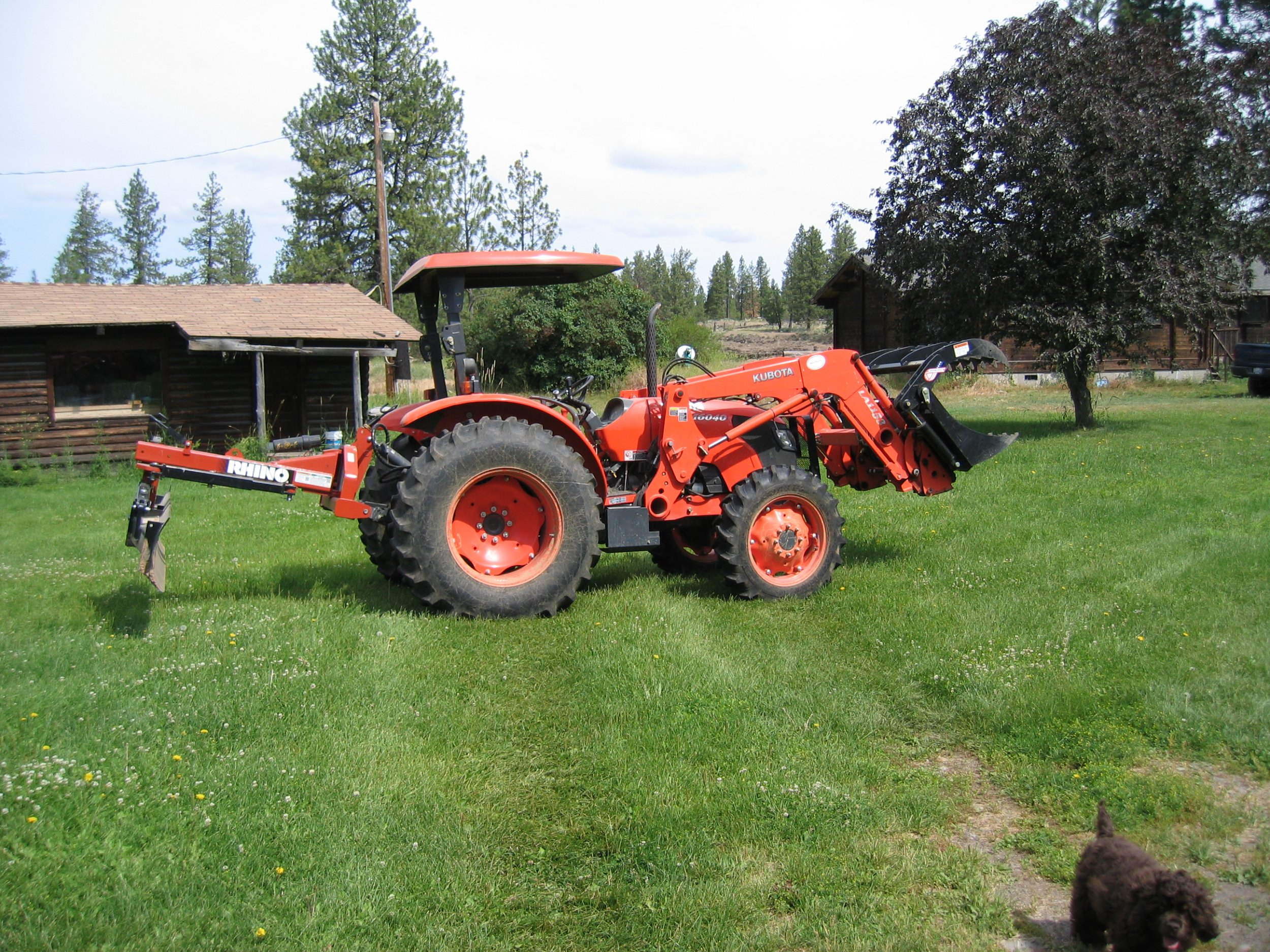

I have 1550# of RimGuard in my rear tires and a Rhino 950 rear blade @ 1050# on the 3-point. Why go to the bother of building a 3-point ballast box if you have a 3-point implement.

What if youre in tight quarters working though? This is why i want to build something thats up close to the tractor.

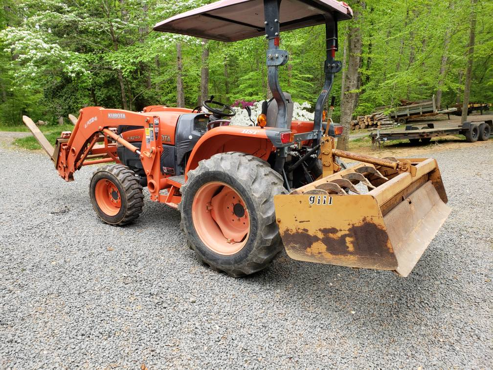

Thats why I have a heavy box blade, only sticks out about 3in on each side, weighs around 1100lbs and is a multi use implement. I have a weight box for my B series and while I've used it a few times, I found for my uses its easier to keep a compact implement on the back such as the box blade.
Its fairly compact and doesn't kill maneuverability much at all.

cramped working space is my motivation.
I sometimes use the back blade, sometimes use the carry all filled with dirt. sometimes use the rear scoop bucket empty or filled.
But the concrete block is invisible when I'm trying to negotiate around buildings with a loaded bucket.
The photo shows you have lot's of room. I can only wish for the same. My land is a series of pushed up stone faced terraces. Picturesque, New England at it's fineist!
