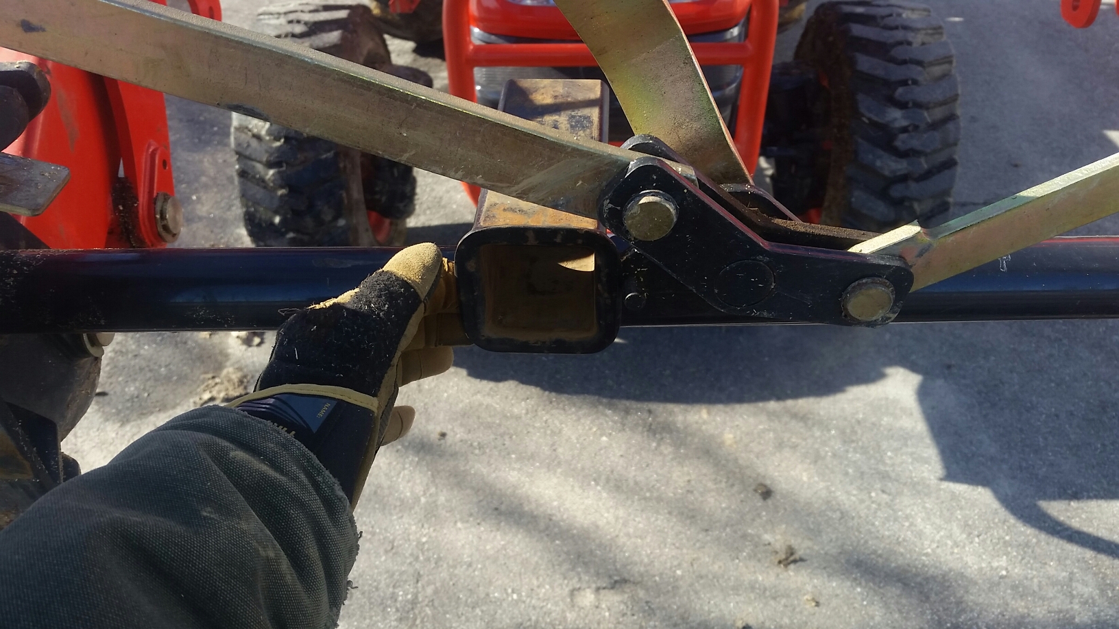

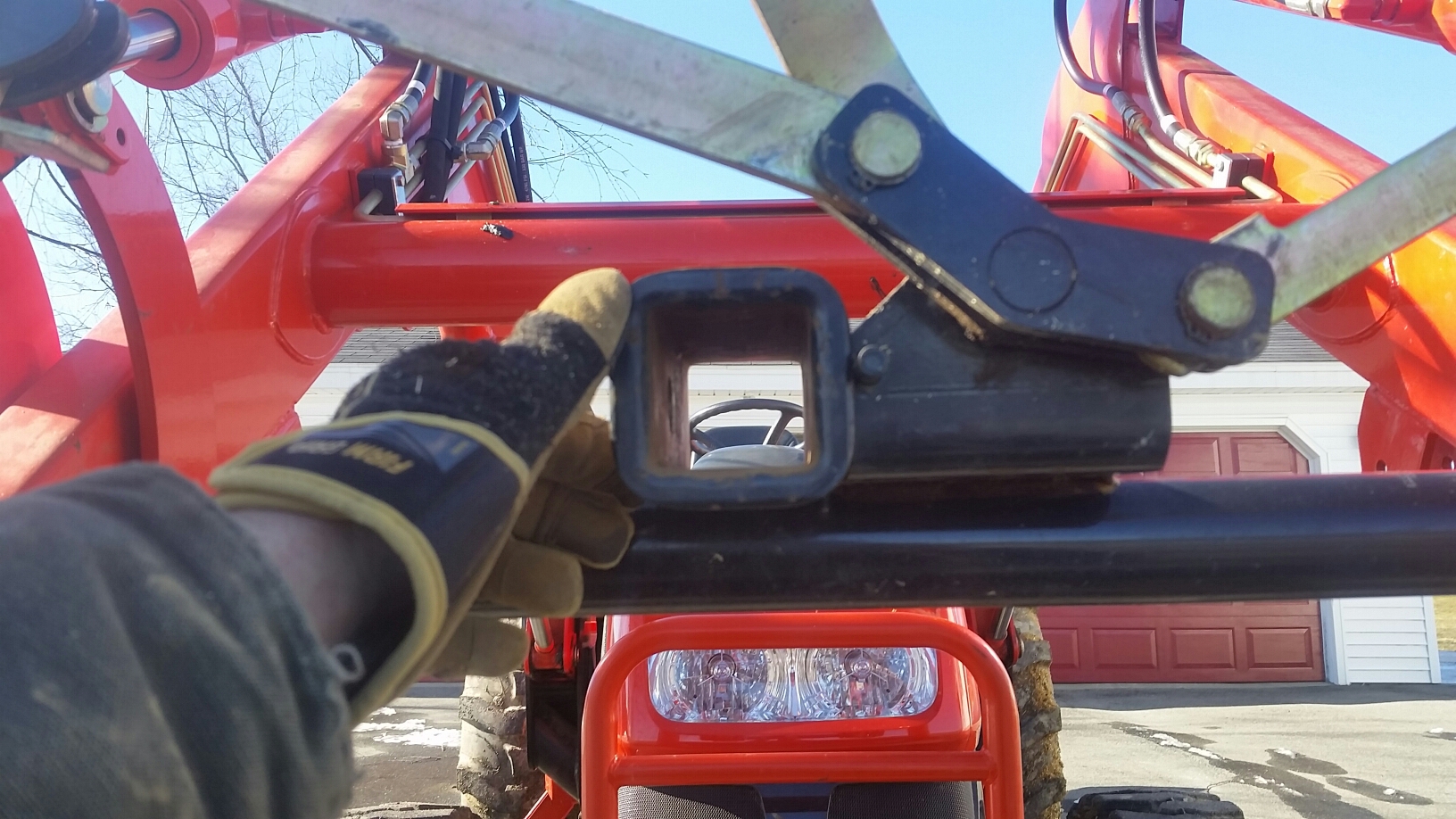

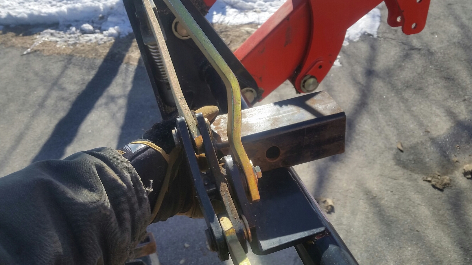

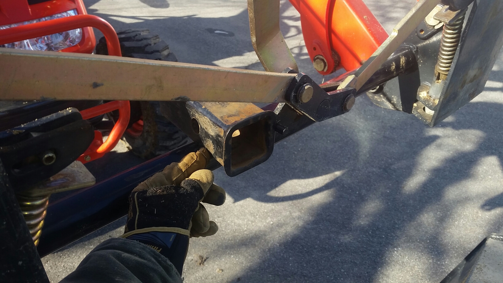

Hello all, I wanted to get some opinions on mounting a 2" receiver on the tool carrier on the loader. I am thinking of bolting, maybe weld, a short piece of of tubing to the cross pipe (torque tube?) of the quick attach on the loader. The idea is when I need to move a trailer I can just drop whatever is on the loader and grab the hitch I need, but my concern is if the tube is strong enough to support the weight. I'm trying to reduce the number of things I have to bring with the tractor, it has two homes that it is always going back and forth between. Also I have a gooseneck two horse trailer that I would like to be able to move, this is the one that the weight concerns me. My other trailer is a pintle so it's not as easy as throwing a ball in the bucket. I did that with our JD 790 and lost the trailer across the yard, lucky it was empty and stopped before it made it to the road. Here are some pictures, I'm holding the adapter sleeve from my truck to get an idea for the clearance. I'm open to suggestions.

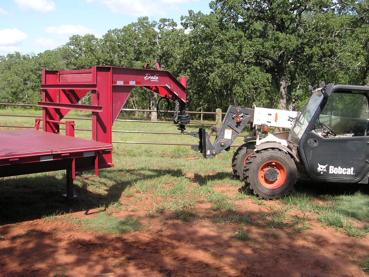

Before you have it break off and ruin your bucket, take a look at Titan Attachments. I got a 3 pt hay spear and receiver combo with the pintel ball mounted up top. and then I picked up a SSQ front adjustable reciever hitch
Tractor Trailer Hitch Gooseneck Receiver 3 Point Hay Attachment
Three Point Hay Attachment / Gooseneck Tractor Trailer Hitch
Amazon.com: Adjustable 2" Tractor Trailer Hitch Receiver Mount Plate Skid Steer Bobcat Titan: Home Improvement
Just an option
Others have welded them to the top of their buckets

I would not mount a receiver tube where you show. If you would bend the cross pipe (or what ever it is called) your bucket(s) probably won't latch properly. Then you'll be rebuilding the QA set up.
I'd look for something like the last link posted above.
/ Looking for some options on mounting a 2" receiver. #4

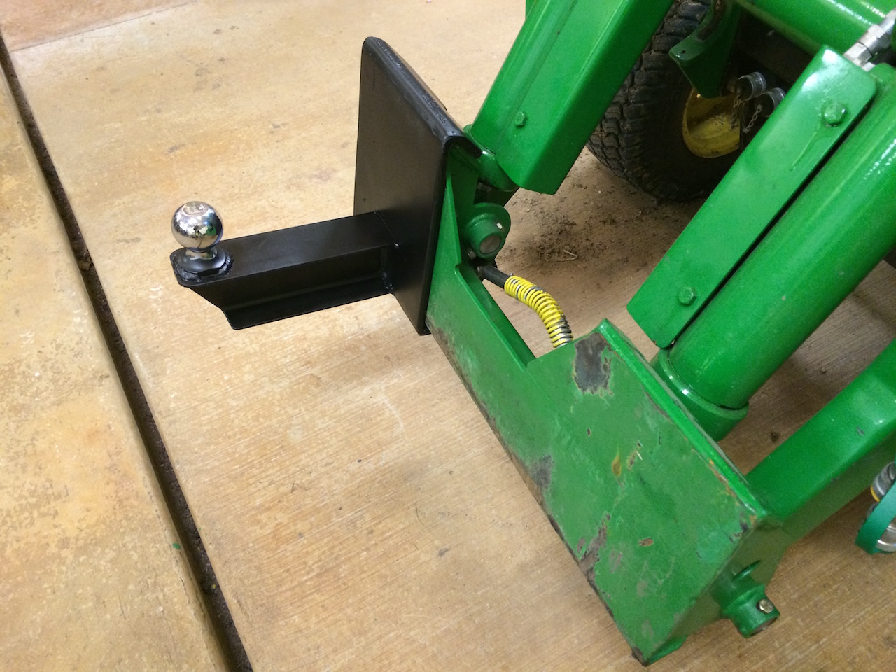

I'm with these guys. The main purpose of that tube is to resist twisting forces applied to the SSQA brackets. It's not designed to lift weight. Buy a blank SSQA plate and weld your receiver to that.

I had a feeling that's what everyone was going to say... it might end up in the bucket now.

I have a SSQA plate with a quick hitch welded to it. My 3pt trailer mover fits on that just fine. Moved my 16' tilting deck into the shop with it yesterday & am putting some stake sides on it to haul manure with it.

I too would not mount the receiver to the tube, as said above the slightest tweak of the torque tube will cause you to have issues with the ssqa. I would either build a ssqa receiver or incorporate it into the top of the bucket if you don't want a separate attachment. I have the same setup that fallen has a quickhitch welded to ssqa brackets and use the 3pt trailer mover.

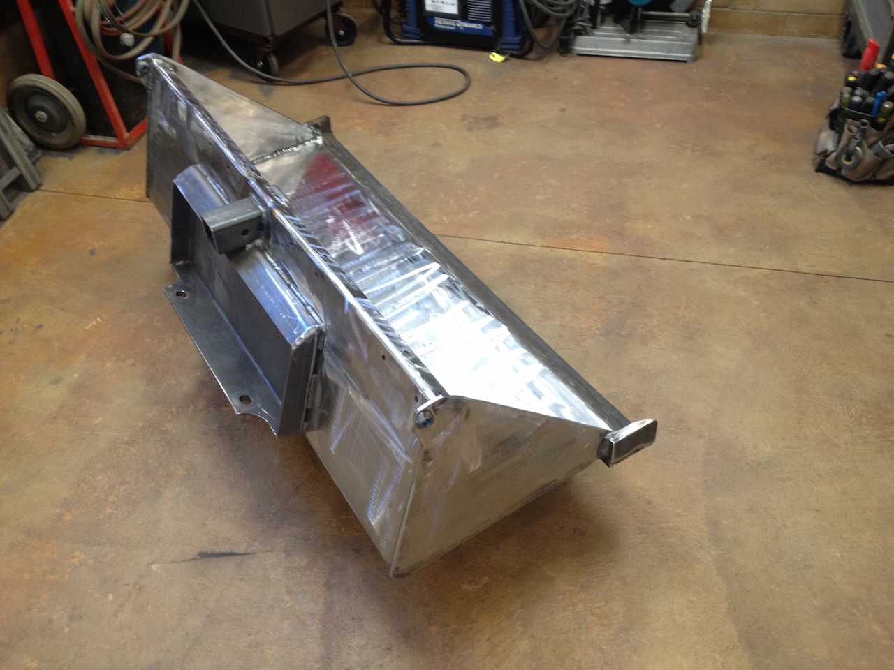

Here's what I did if you decide to do a bucket mount. I rarely if ever never even have to remove the ball mount. It's pretty much always there when I need it and I can change out quickly.

I would reinforce the top of bucket with c-channel prior to welding the receiver hitch.
Eliminate chance of top of bucket bending

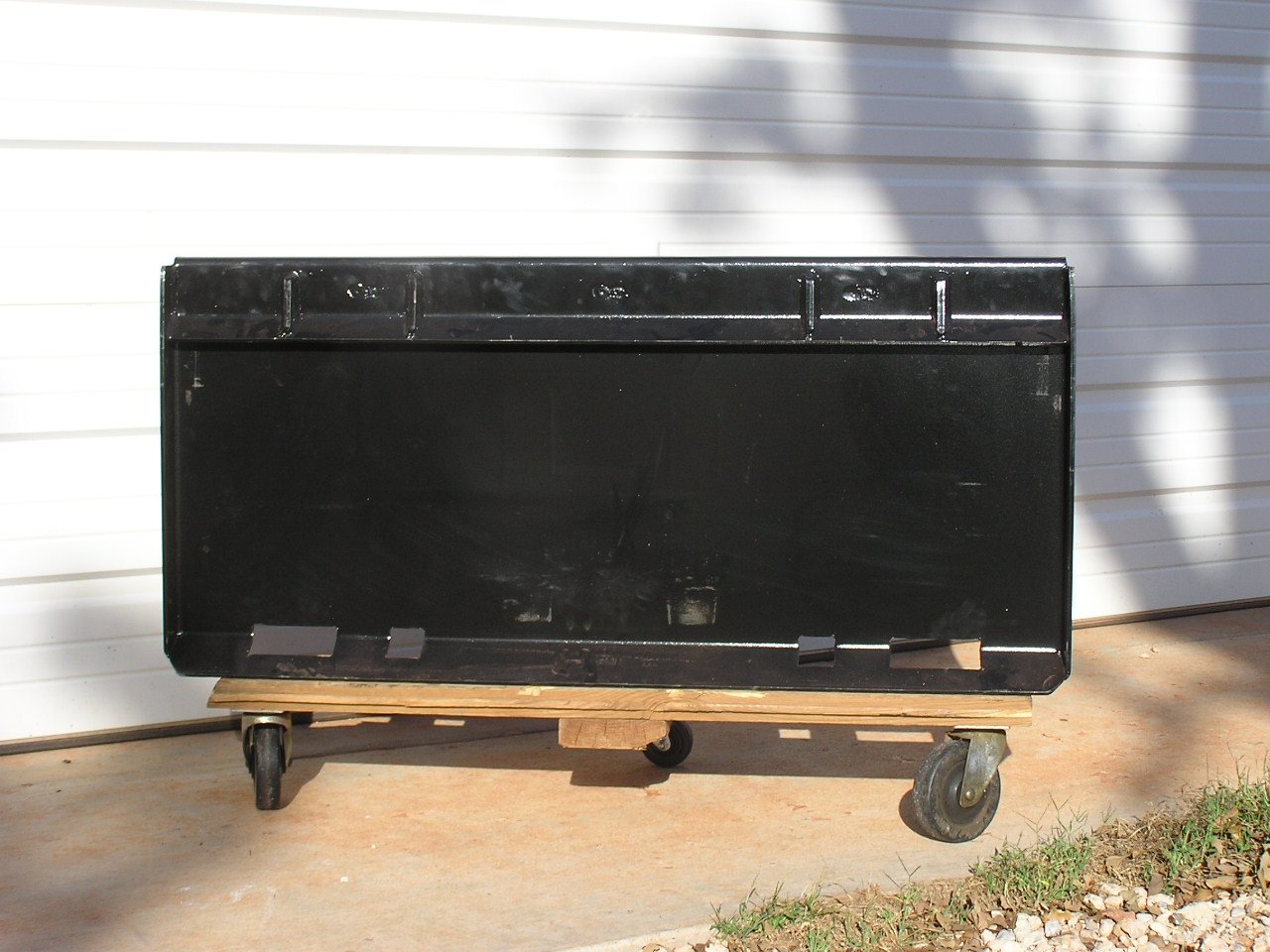

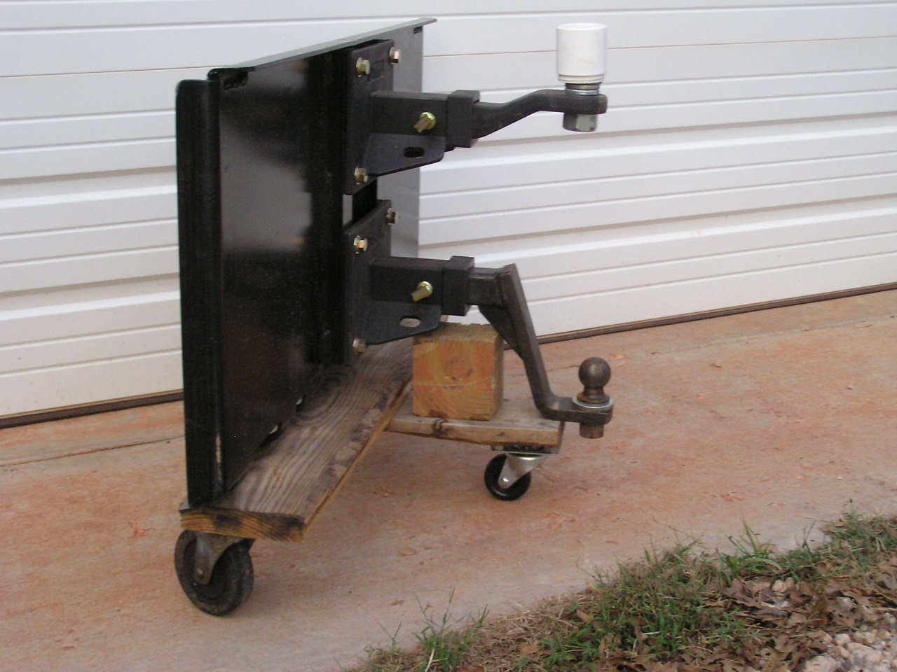

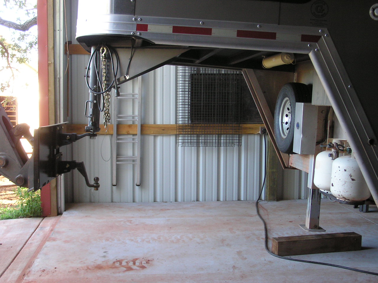

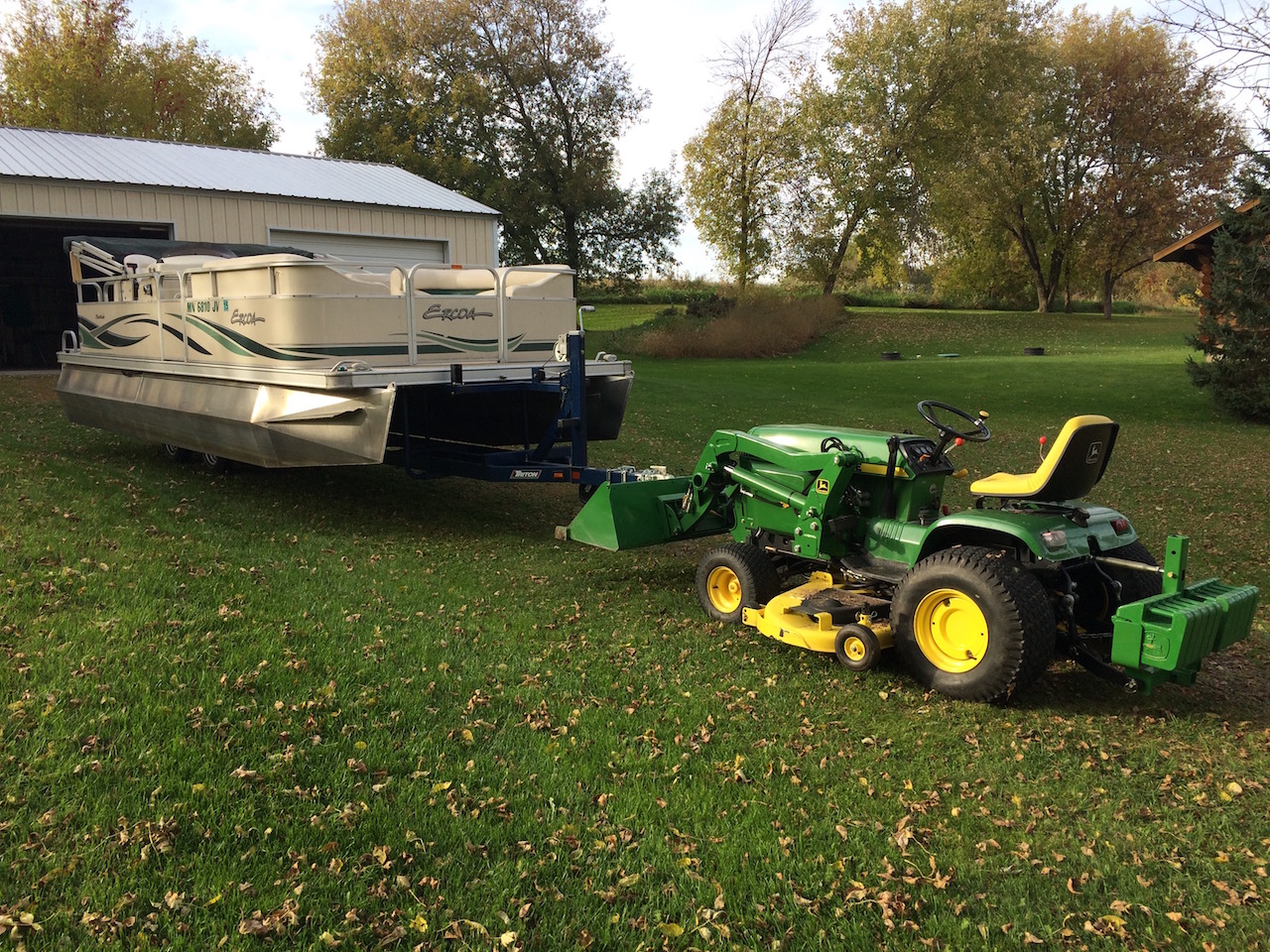

I followed conventional wisdom and built a receiver into the bucket on my baby GT. I found it hard to see around the hood and bucket to get aligned to a coupler. And then I had to be careful of the bucket getting hung up on the tongue jacks. I saw a picture of the offset ball hitch for the QD, made one up, and it works really well. I need to have a care about the offset. Jay

I have seen the clamp on hitches and gave them a thought. I did wonder how easy it would be to pull it off the bucket, but that would give me an excuse to get a cutting edge! I am going to take a look at Jlwoodworks thred.
