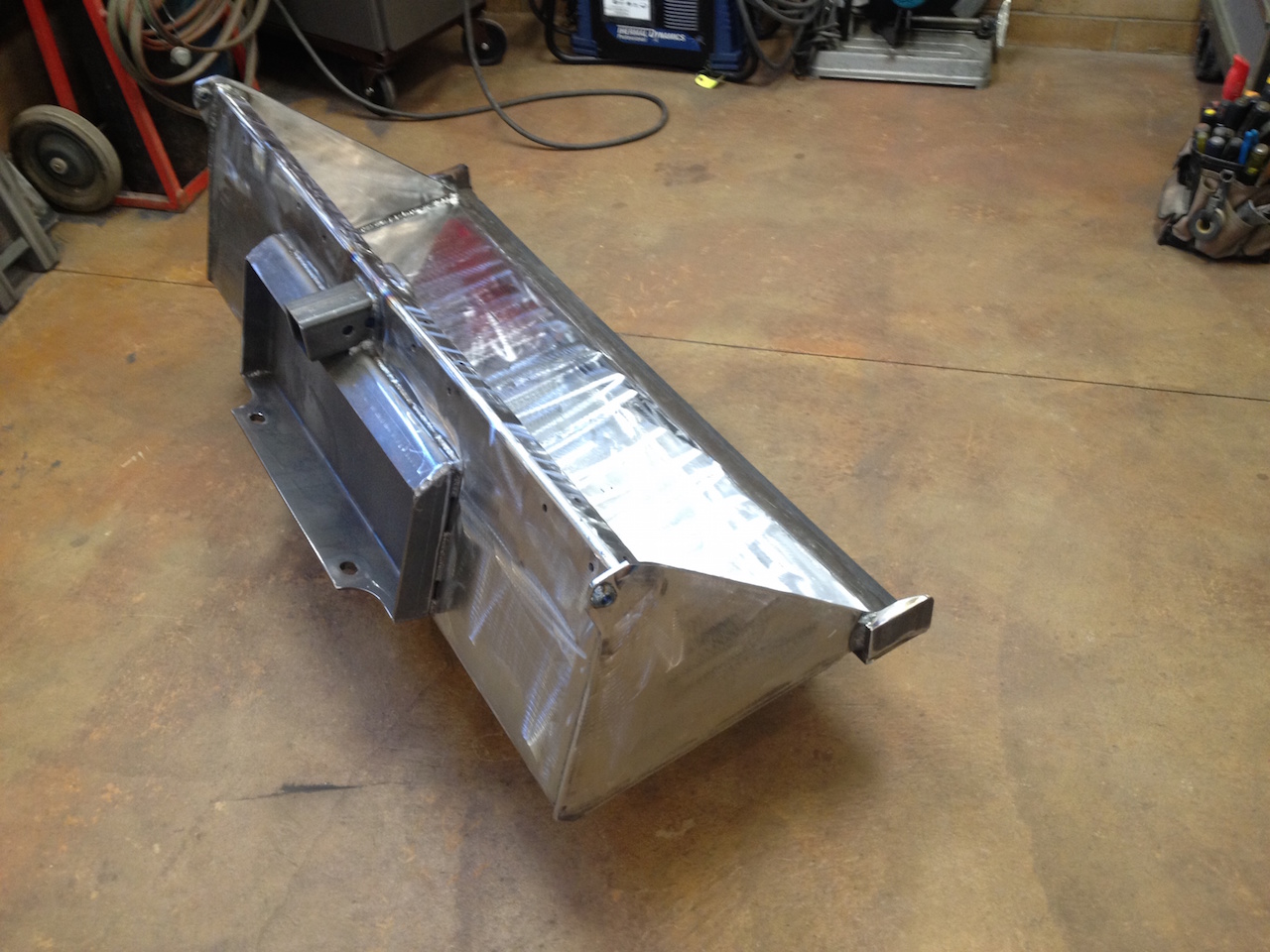

I completely understand, take a bit and look around on here and you can fins several posts on different ways people have mounted a tube to the buckets, Some look almost factory.

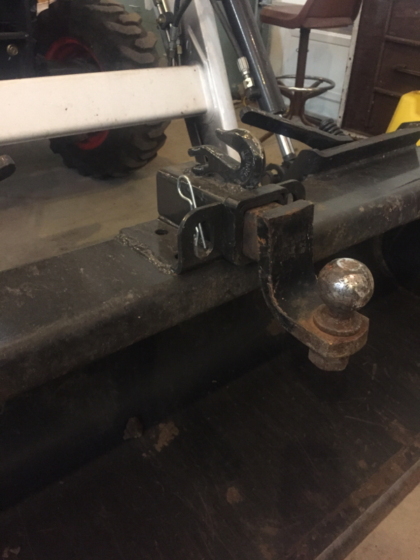

Here's what I did if you decide to do a bucket mount. I rarely if ever never even have to remove the ball mount. It's pretty much always there when I need it and I can change out quickly.

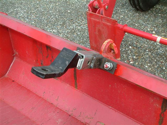

I'd just mount the receiver on the top of the bucket like this.
Two 5/8" or 3/4" bolts welded to the top of the FEL bucket and mating brackets welded to the receiver.
Good luck
   / Looking for some options on mounting a 2" receiver. #14
I would reinforce the top of bucket with c-channel prior to welding the receiver hitch.
Eliminate chance of top of bucket bending

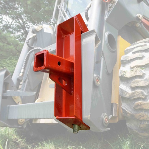

   / Looking for some options on mounting a 2" receiver. #16
If the top of the bucket is too high, you can get a clamp-on hitch that attaches to the lip. For example, one like this.
   / Looking for some options on mounting a 2" receiver. #17
That is precisely what I use
I also have chain hook on top of my bucket and use it for the safety chains just to be sure trailer can't get away from me
I added a cutting edge to bottom of my bucket and it adds a lip the clamp on can't get past
I like clamp in as it can be removed when not needed
I don't move my trailers around enough to warrant permanent fixture attached
Cutting edge eliminates chance of bucket lip bending

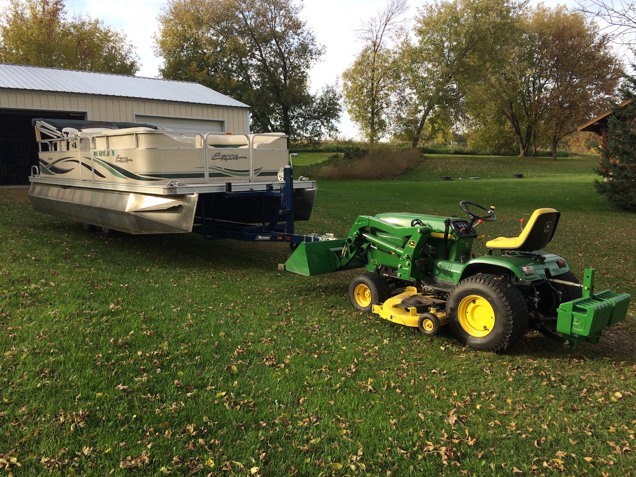

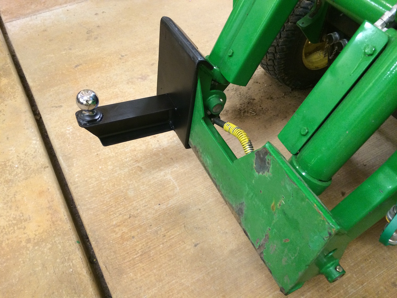

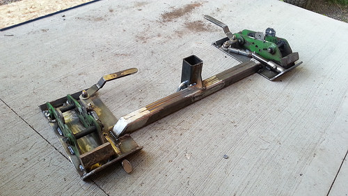

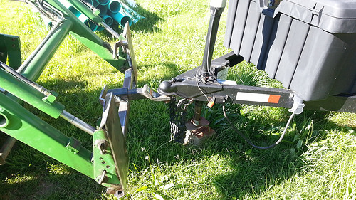

I followed conventional wisdom and built a receiver into the bucket on my baby GT. I found it hard to see around the hood and bucket to get aligned to a coupler. And then I had to be careful of the bucket getting hung up on the tongue jacks. I saw a picture of the offset ball hitch for the QD, made one up, and it works really well. I need to have a care about the offset. Jay
