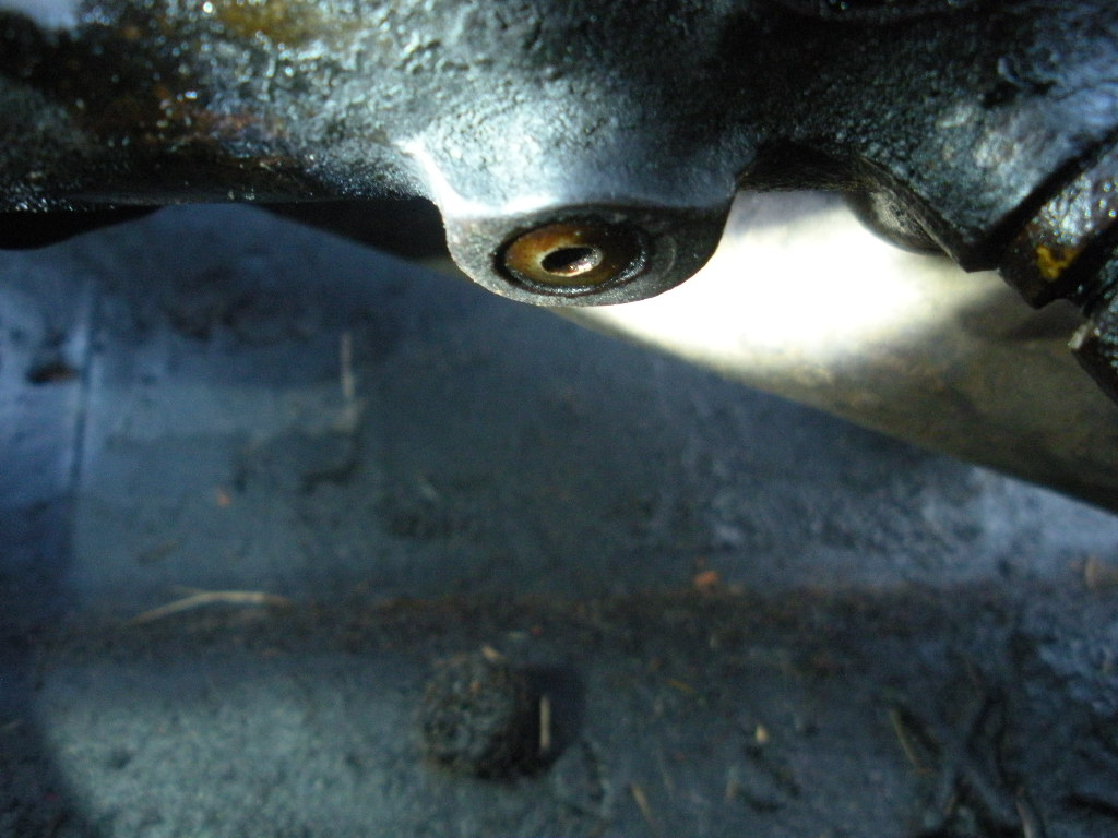

There's defiantly a whole in the bottom of that manifold, it's tiny, and appears to not be threaded, but looks like a brass insert is in there, maybe its actually a drain? to prevent flooding?
I mainly thought of that because I have an old rototiller with an updraft carburator and it has a drain screw in the bottom of the float bowl. That doesn't really mean anything, but it just kinda made me think that maybe it could have been a drain of some kind and had the plug missing.

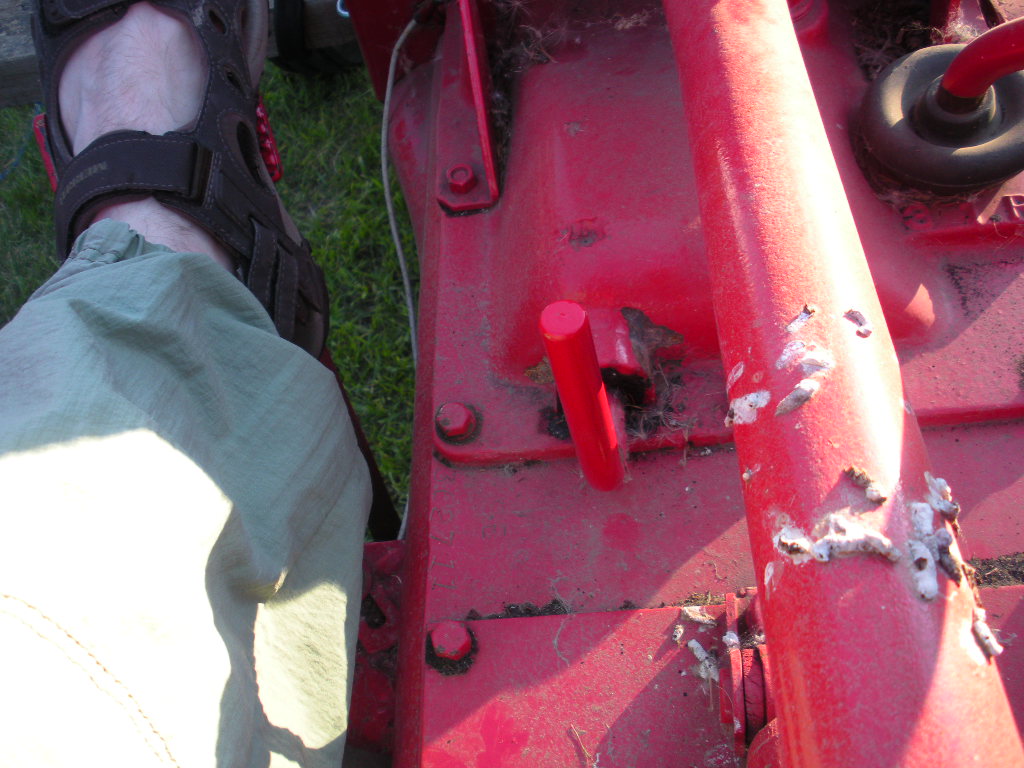

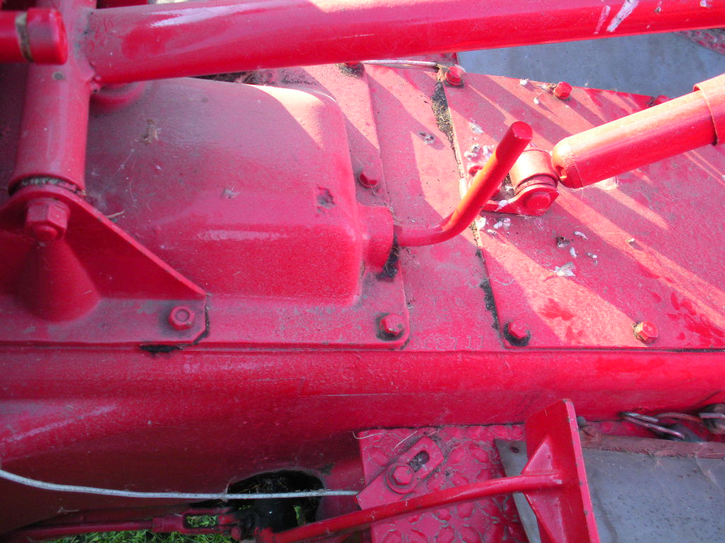

I replaced everything, put fresh clean fuel in, and gave it a test run. Drives great, occasional sputter (tune up soon as I can find parts) but it goes under its own power. Actually I was trying to figure out the gear pattern and found 4th gear, that little thing moves! All four forward gears and reverse go good. I actually couldn't get it to go into gear until I moved a large (1/2 to 3/4 inch thick) bar forward (see attached pic's) Oh, my apologies about the bird crap, it was in a pole shed the last 15-20 years :)
Gear just grinded until I moved it forward, then it went into any gear silky smooth. Any idea what the heck that bar is?
After looking at the pic in your last post, I wonder if that would be for engaging the belt drive which is absent on your tractor?
I'm thinking - put trany in gear then pull back on lever to change output from drivetrain to pully? Just a wild guess.

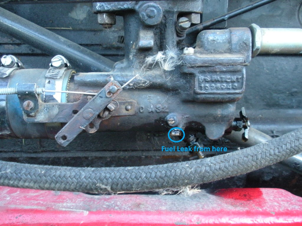

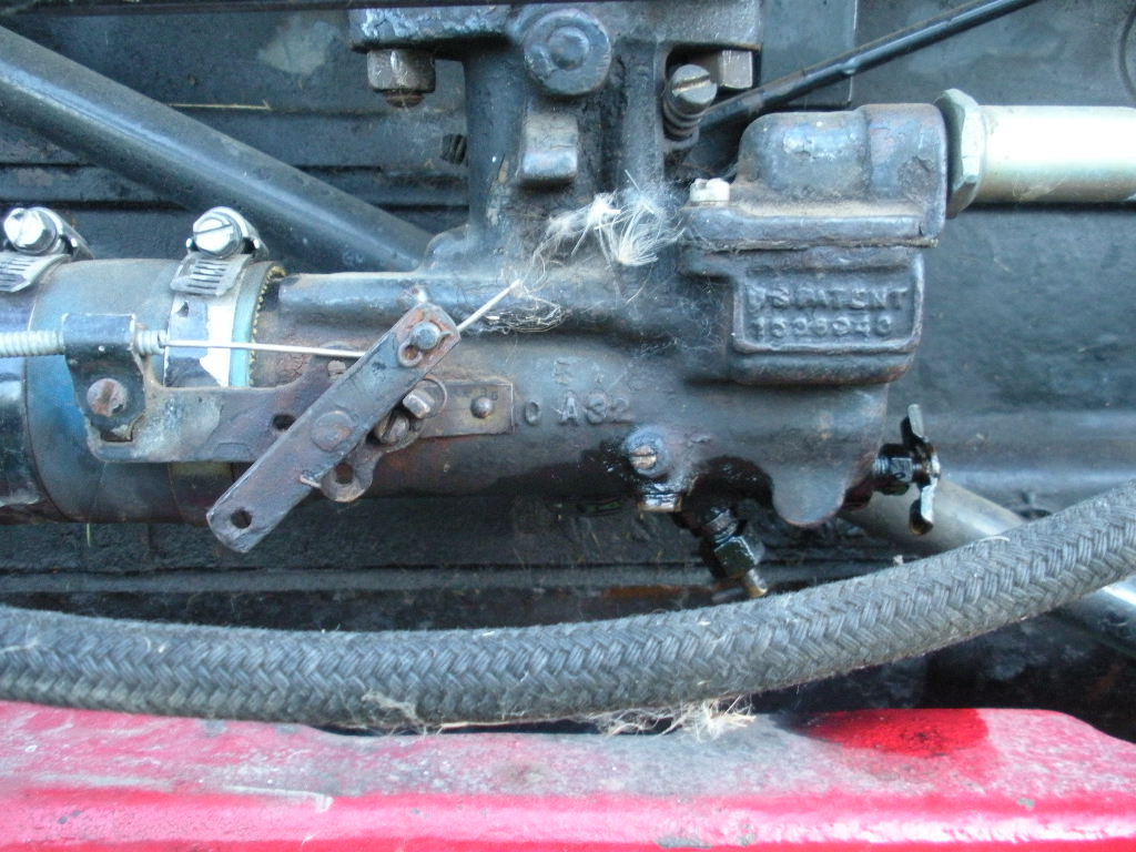

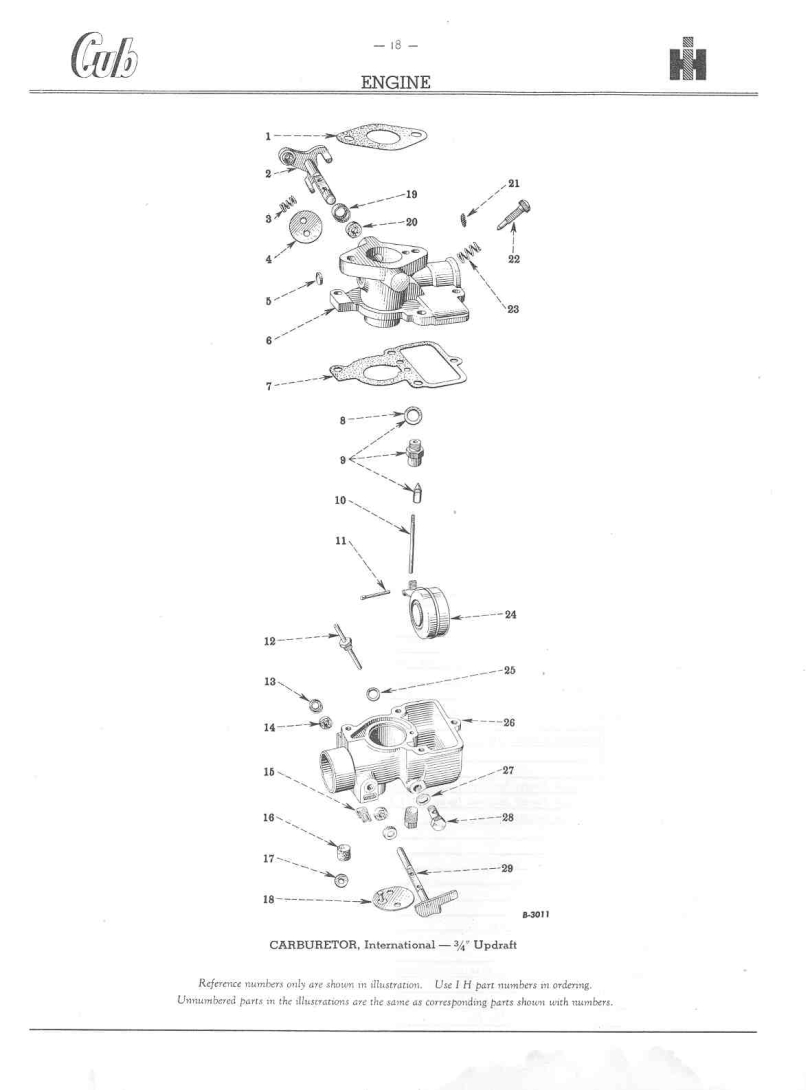

We had a '60 Farmall Cub and carb kinda resembled yours. If you flooded the engine the gas would drain out there, or if the float valve wasn't shutting off tight that is where the gas would leak out. If the float valve was only leaking a small amount, the hole would only drip gas when the tractor was shut off, but if passing badly then you would get a drip when the tractor was running. The drain below the float, that has a plug in it, was so you could attach a piece of clear tubing to see what level the float was controlling the level to. Here is link to what IH carb looked like. Farmall Cub IH 3/4 Updraft Carburetor
Here is parts list and it's called 'drip hole filler' item 16.
Donnie

Ah, cool thanks.

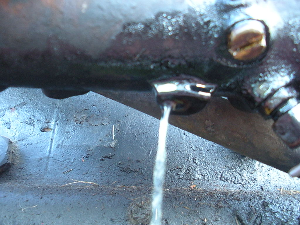

I'll print that out for reference. Mine leaks if the fuel tank shutoff valve is on, just from gravity pressure, so I'm thinking there's a gasket or seal gone, again, not a carburetor guy, so it will be a learning experience.

If the carb is gravity fed from the tank and leaks whenever the fuel tank petcock is turned on then I would first suspect a stuck float/float valve in the carb.
   / Looking for some info/advice on a tractor I Inherited (Massey Harris) #33
Or a float that don't float any more. Happens when it's fluid tight seal is compromised.
It should be somewhat light. If it has significant weight shake it to see if any fluid inside. If so, you must replace or if not available, drill, drain, and repair.
