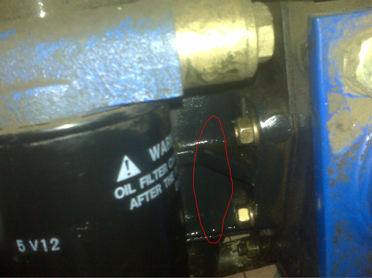

hi all, looking for others just like me that own a new holland that has a cracked block and or clutch housing. 4 year old tc 30 loader and backhoe 387 hours.

wow great post guys. well i didnt think i was abusing the tractor. as for what i was doing when the block cracked i was puting in a culvert. not hard digging. after looking at the tractor i have found that the crack in the clucth housing is on both sides. and yes nh wants nothing to do with it. as for how the bh mounts it has a bracket at the bottom of the rear differential and a sub frame that mounts at the bottom of the loader uprights. it also has an attachment on the 3pt tensinion arm. should not have affected the clutch housing in my opinion. mike

hi guys havent posted in a while..but did take the time to read all the postings and just wanted to chime in..I replaced the clutch housing on my tc30 and rewelded the block twice. it lasted for a year and im about to reweld it. I like my tractor and i do use it hard. im not happy with the way that the implements are mounted and the cast parts are expected to take a lot of abuse. we have been throwing around the idea of making some bracing to absorb the energy away from the block and clutch housing but its not been a priority. it would have been nice if new holland would have offered any help but i was completley blown off. so i cant say anything nice about them or the way i was treated. i would still like to find another block to replace this one with but im not spending 2000.00 for a short block. my local dealership offered to do the complete repair for 8000.00 last year when it originaly broke.
so i just keep making repairs and payments and a lot of cussing.

I guess I can now join the TC30 club as well. My TC30 block cracked on 6/10/2011 after spending $5.5K to replace the block and two days worth of work. The bell housing cracked this weekend 6/25/2011 while digging with the backhoe a hole to set a 4x4 post. Im expecting another $1.5k and two days tearing apart the machine.:mur::mur: 580hrs this should not be happening. I used my neighbors TC35 a few times with the same backhoe and there is a sub-frame on that machine to keep the stress off the block and bell housing... Bad design in my opinion or NH should not sell a backhoe attachment for this machine...
/ looking for other broken tc30's #19
Pictures of the engine crack, will get pics of the bell housing this weekend. BTW its $1,200 for the housing for a hydrostat SBA32011115.
