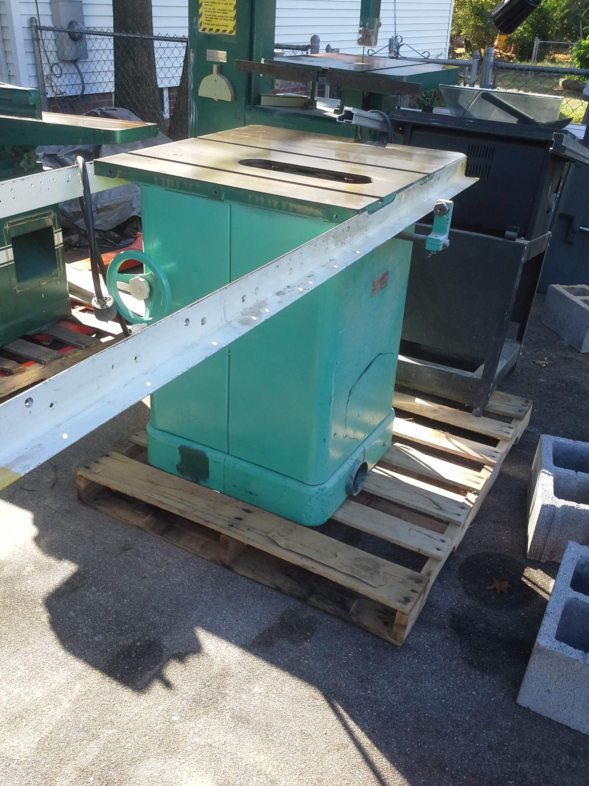

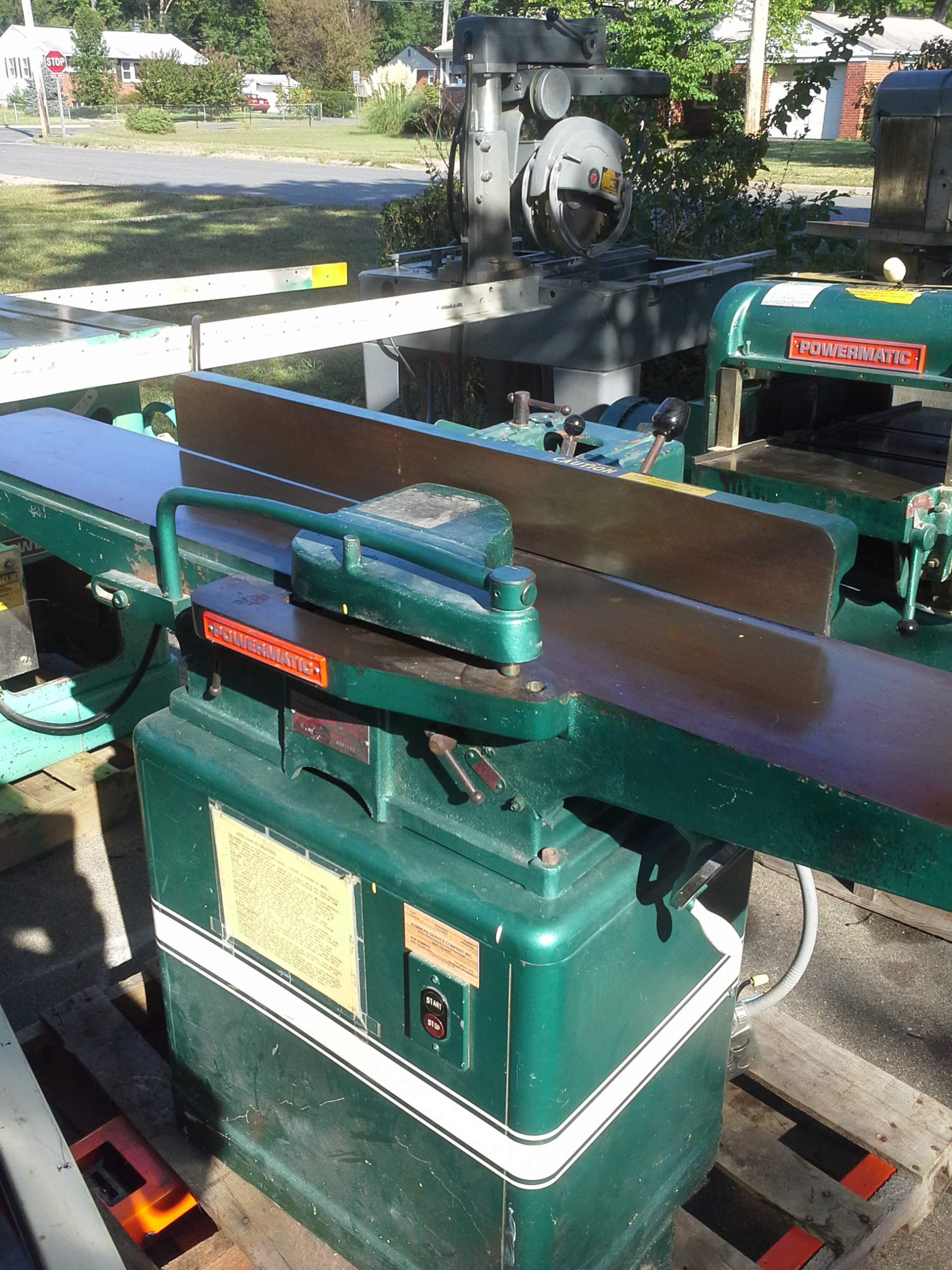

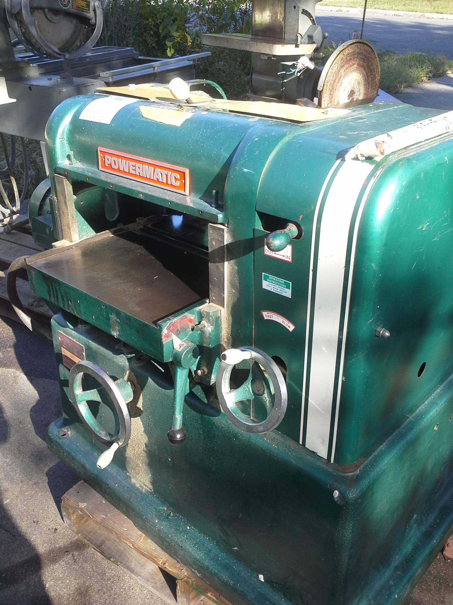

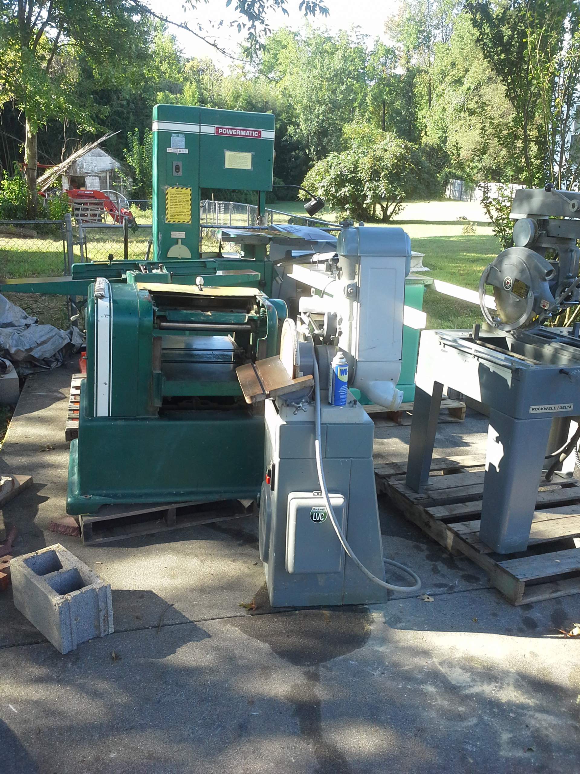

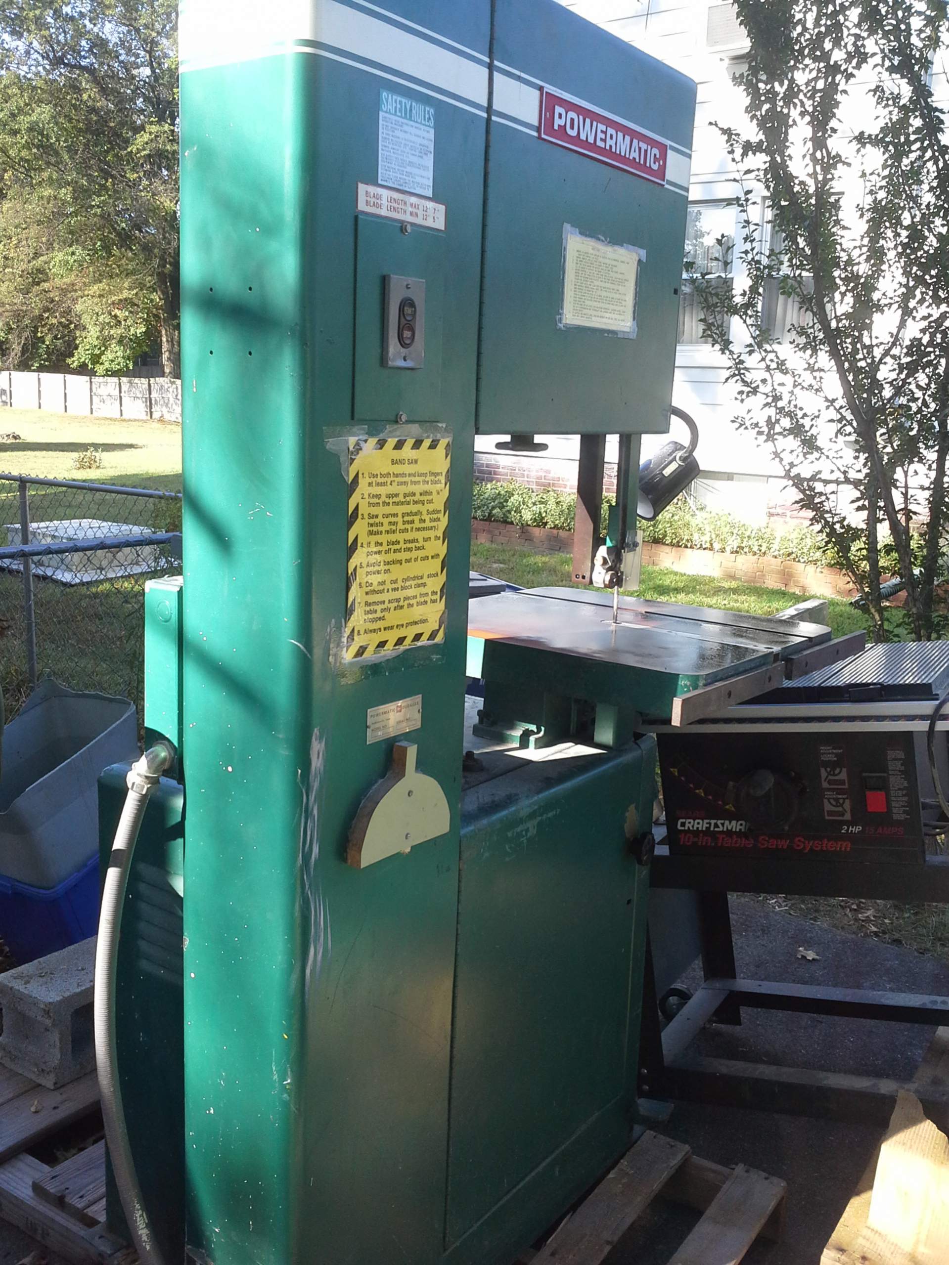

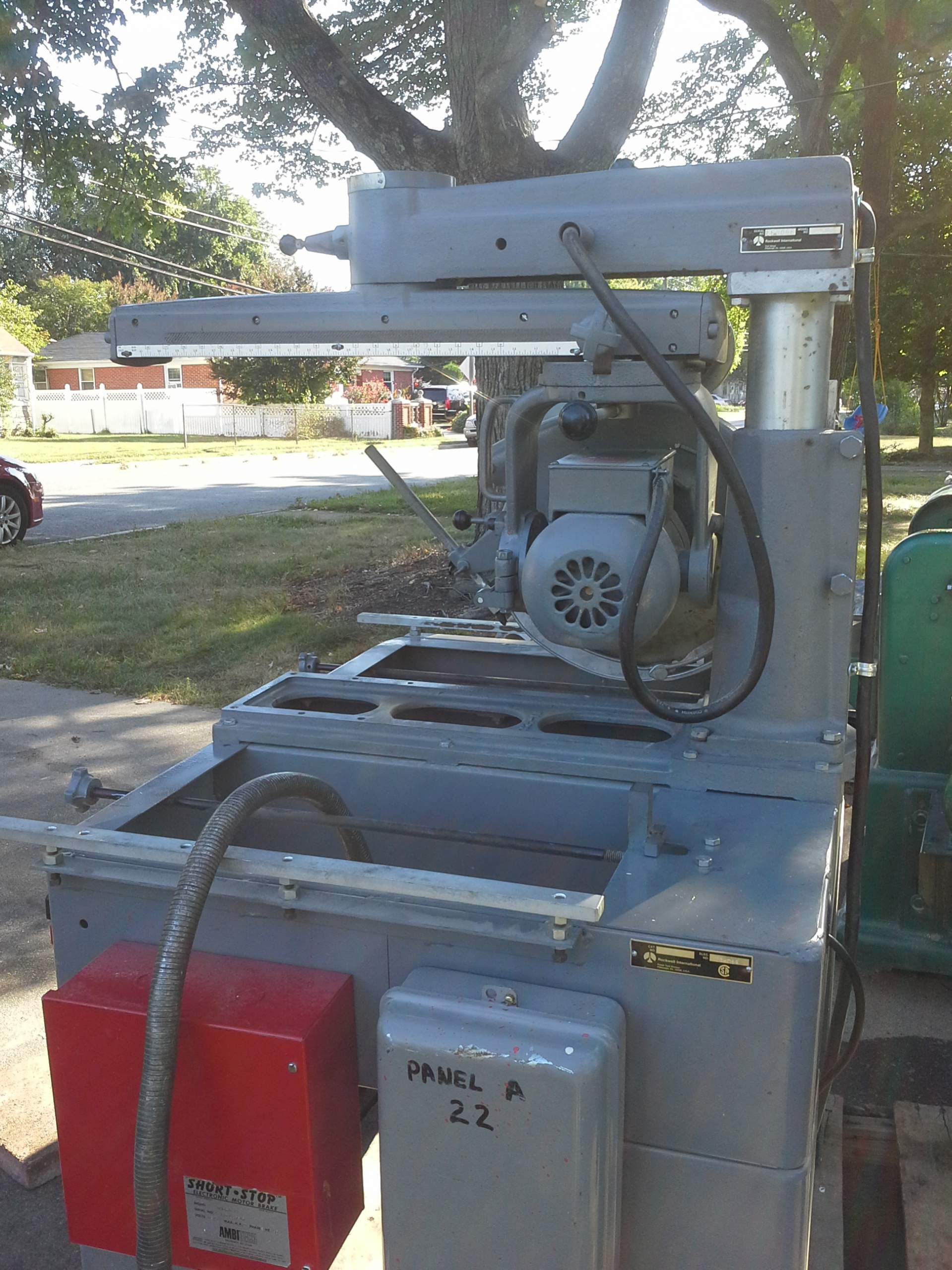

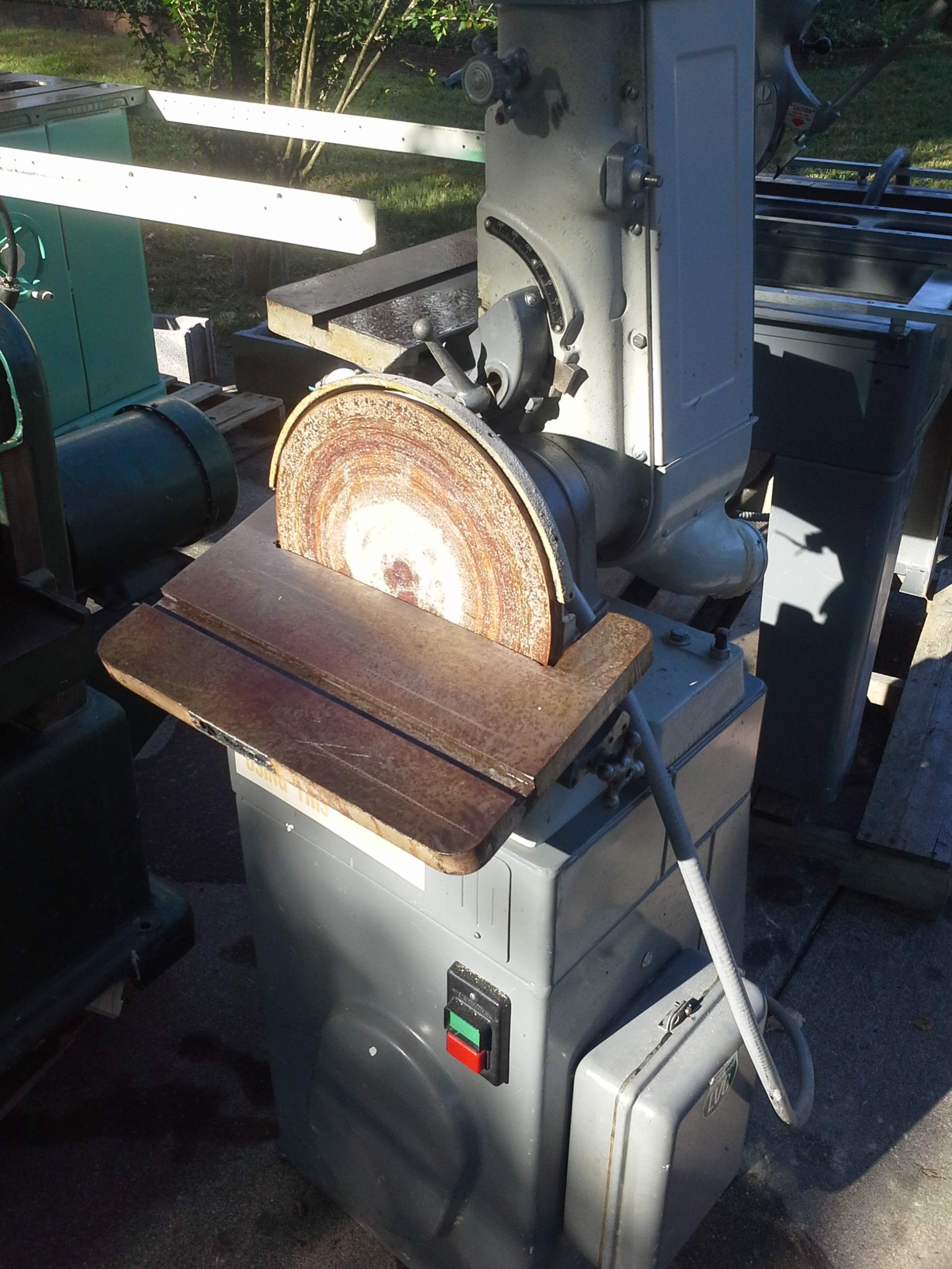

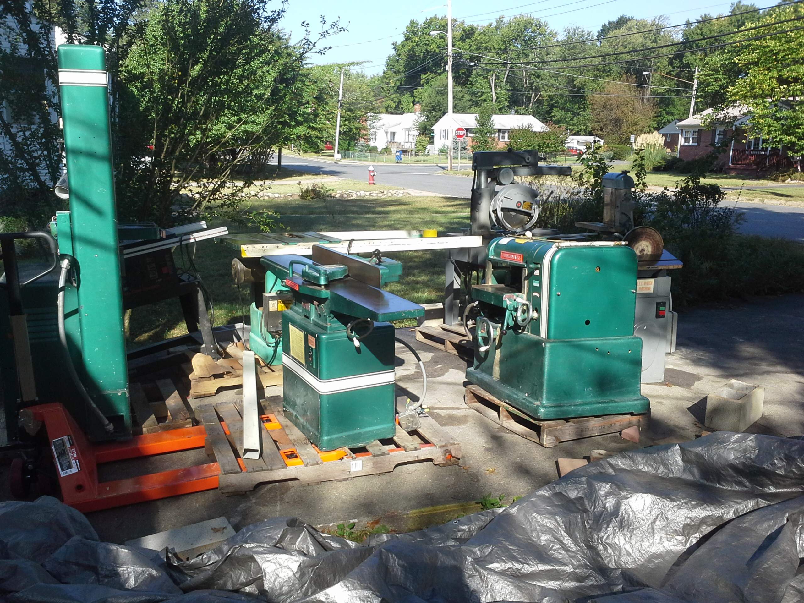

I just bought a few 3 phase tools to haul down to Mississippi. I have a 400 amp circuit breaker box with 3 or 4 220V lines, so I've got power.
But to get 3 phase will cost well north of $30K (I asked).
My most power hungry is the Powermatic 160 planar w/ a 5hp 3phase motor.
But I also bought a jointer, bandsaw, table saw, RAS, and sander so I figure I need to learn about 3 phase and the best way I can implement it.
The collection
Sander
RAS
Planar
Table saw
Jointer
Bandsaw
So I'm looking for some GOOD links on converters and DIY converters. I figure I'll want at least a 7.5HP system.
