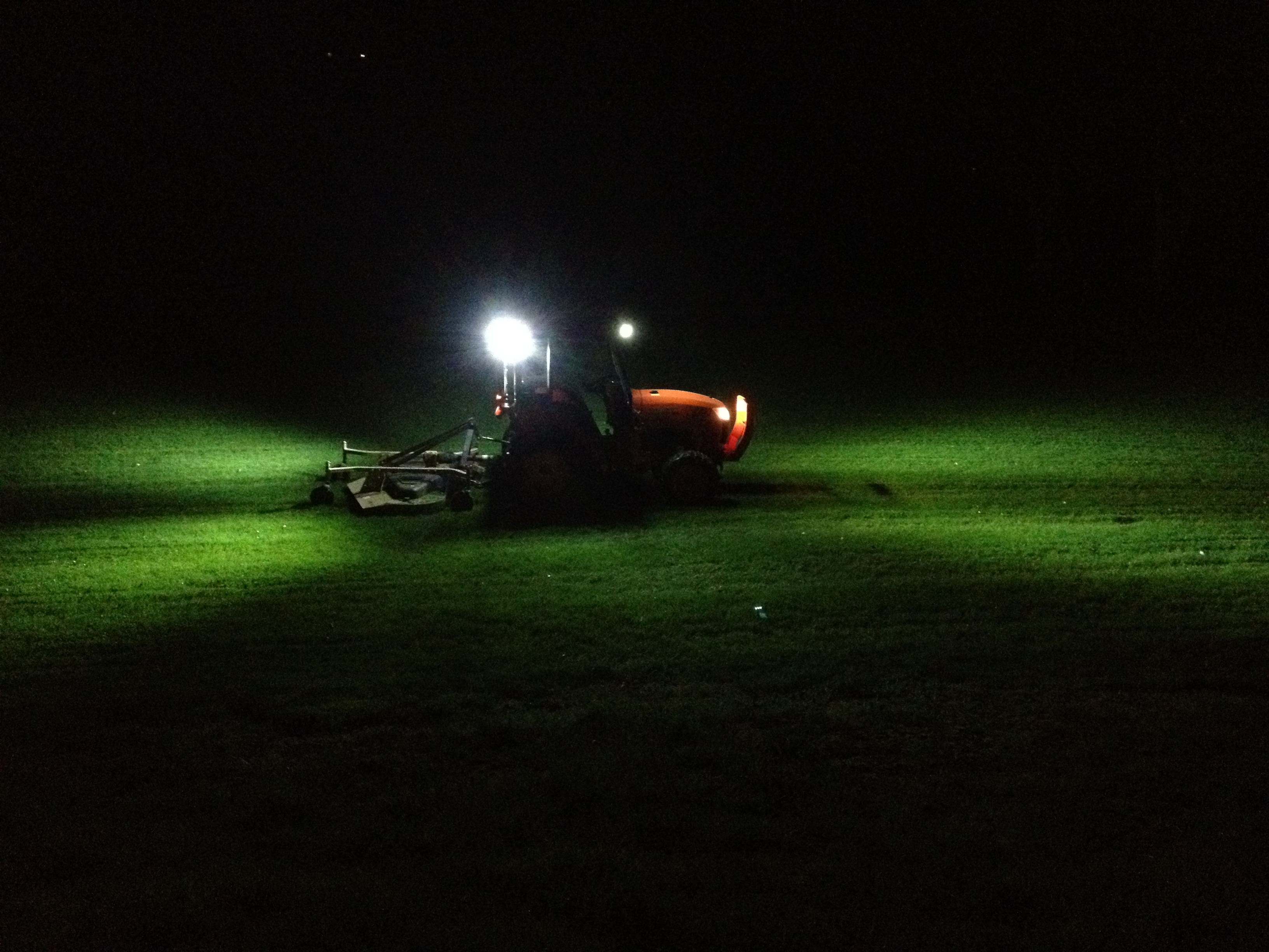

Maxxima MWL42 LED front and rear with small cubes in FEL mounting tubes:

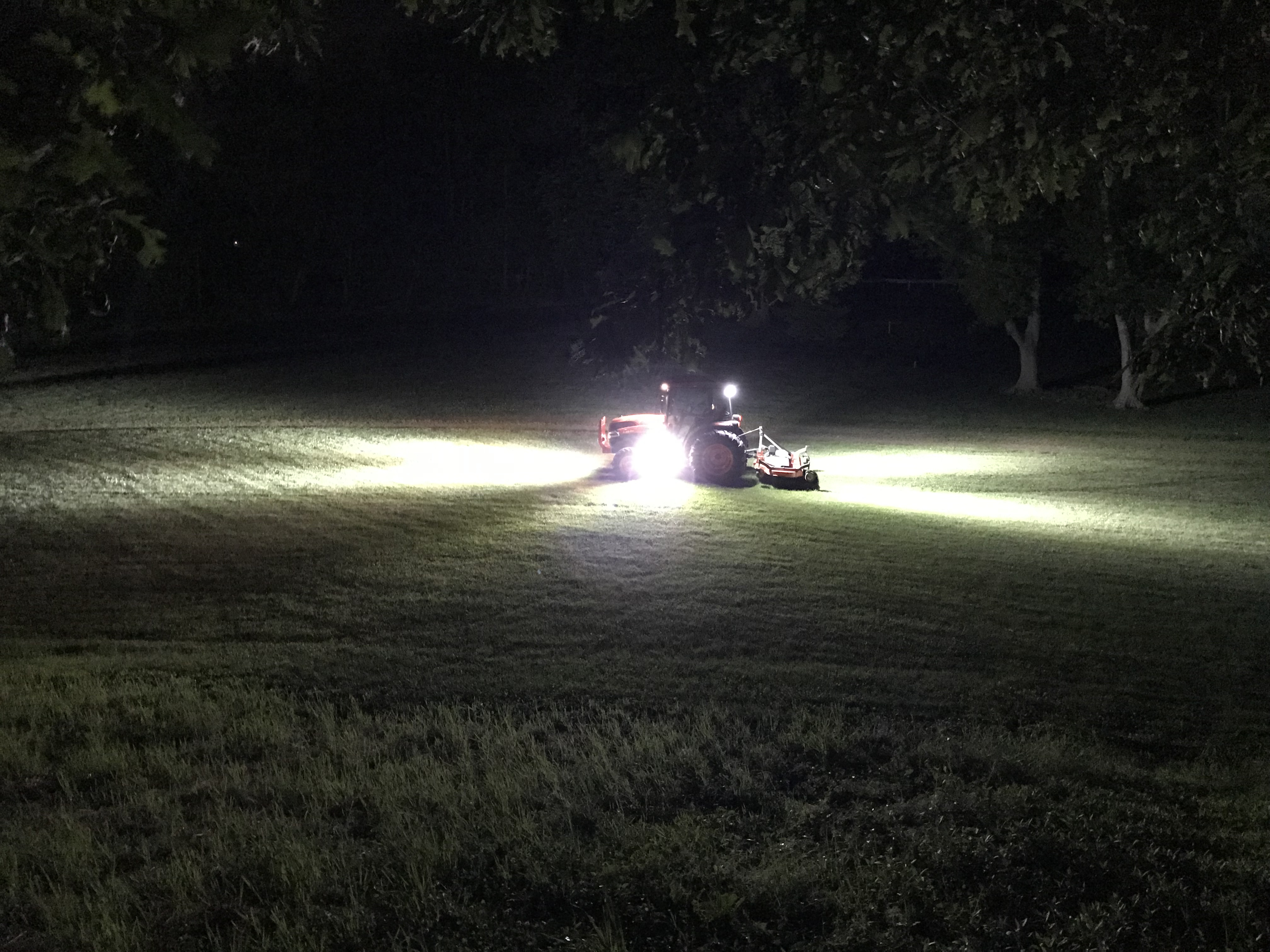

Grote 63191 (?) incandescent. The darkish stripe in front of the tractor is a grassed-over driveway to the sheds:
