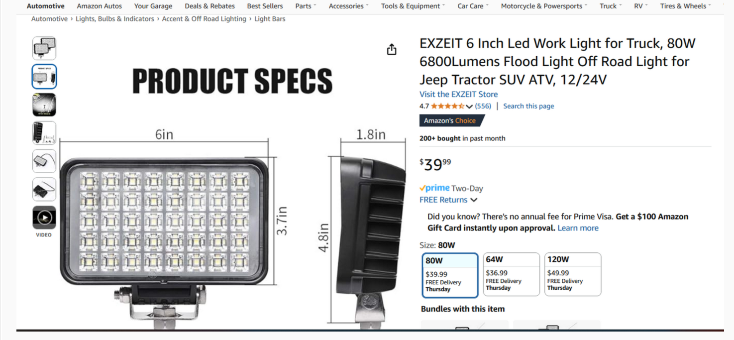

I am going to replace the whole housing. I can't see the amp draw listed on any of the lights. My fuse for the lights I'm changing is 10 amp so I need to keep it under that. Where do I find this or how is it computed. I know draw is low on LED.
They tend to list the incandescent equivalent wattage for LED lights, and not the actual wattage. I added lights on my tiny truck, and used the stated wattages, to calculate Amp draw, and that to size wiring. Once I had them hooked up, I checked the amperage draw and it was about 25% of what it would be if they actually drew the wattage stated in the descriptions.
To calculate the amperage the equation is: Volts X Amps = Watts. Use the nominal 12-volts, not the 13.6-Volt fully charged battery state. Personally, just to make the math easy to do in my head and add a safety factor, I use 10-volts.
Hint, look at the factory wires coming out of the light, and they are too small if it were actually drawing the watts they state in their descriptions. Most lights have 20-Guage or smaller wiring, when if you looked at their listed wattage the minimum would be a 14-gauge.

Just for kicks I checked the specs on four different LED work lights. It only made me more confident that my assumptions that either errors or skullduggery are a large part of the ratings just may be correct. The wattages listed/wattages calculated were 70/19.2 - 85/85.2 - 40/26.4 and (no wattage listed)/28.8. In the same order, the Lumens per Amp at 12V were 5250, 1725, 1818 and 875.
Although improvements are being made along the way and some degree of difference can exist I find it difficult to believe that an 8400 lumen light draws 1.6 amps while a 2100 lumen light draws 2.4 amps. Regardless of the games being played, just about any LED light is obnoxious when looking at it.
   / Looking for LED lights to replace older 3x5 or 4x6 halogens #29
The ratings run the gamut, and they are generally probably optimistic. A quick look at Amazon, they kinda run about 100ish lumens per watt. LEDs are obnoxious to look at, but great to work under.
