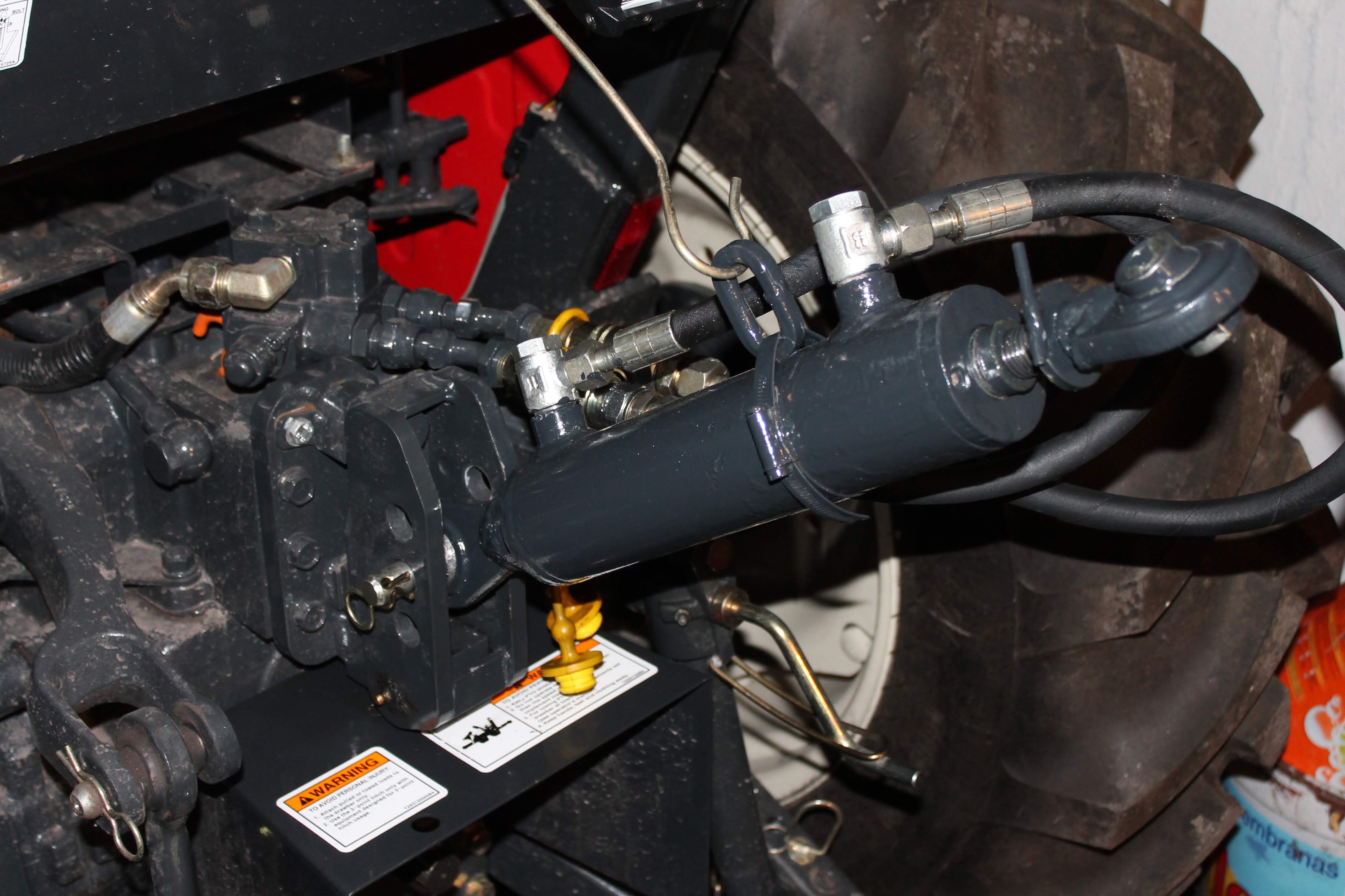

This was my solution. A link from an old chain and a hose clamp. The hook is the original top link holder. It's been holding perfectly. I think I've since rotated the chain link so it sits horizontal though.

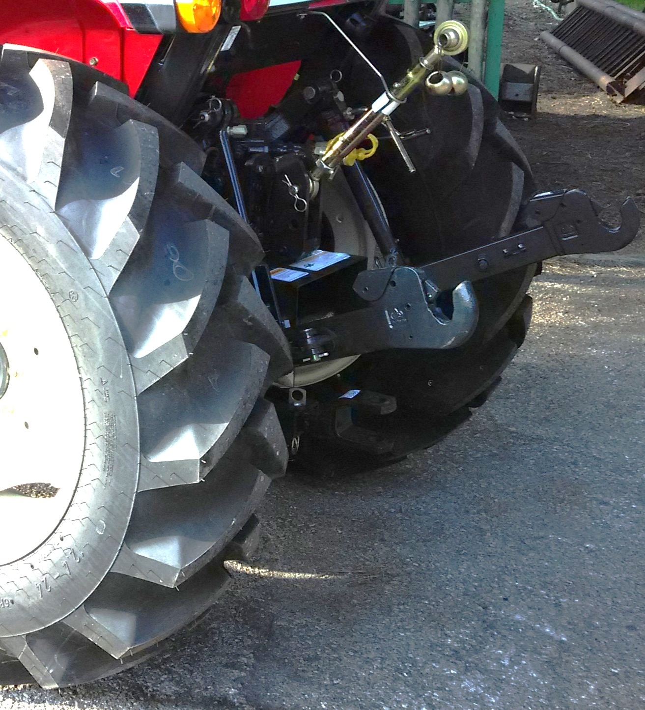

I just use a quick hitch.

It took me until the pic from @ptsg to figure out what a "winky wire" was.
Maybe this gives a better idea on the "winky wire". Don't mind my tractor's balls just hanging out in the wild. 🙃
