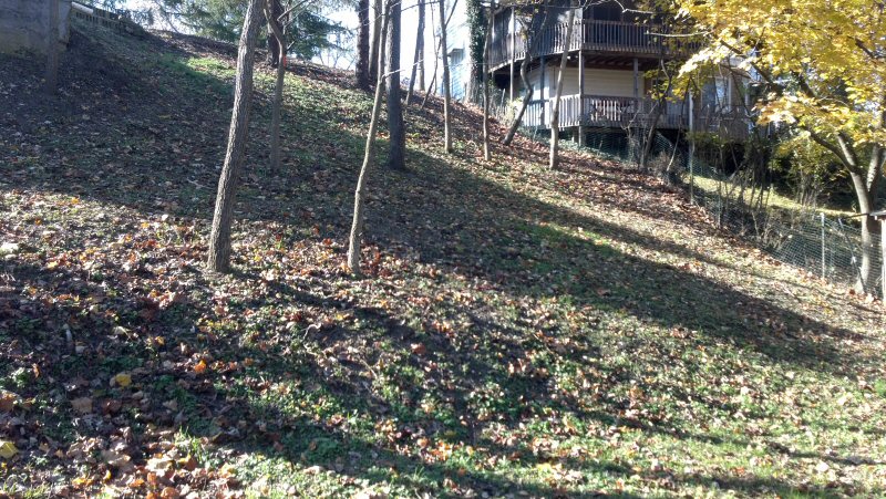

That looks like free-fall territory to me. Be careful!!!
A lot more of the saplings will be removed. My 210lb ballast on the seat makes a difference on a small tractor like the lx178. These 1000~ 1500lb subcompacts are a different animal. I have worked larger tractors years ago, and the most important thing has been knowing the how the tractor rides on that ground. I will have to have a demo at the house to be comfortable with a purchase. Both dealers that I am talking to have good reputations. Sadly one lost his Deere dealership and now sells mihandra and simplicity and ventrac.

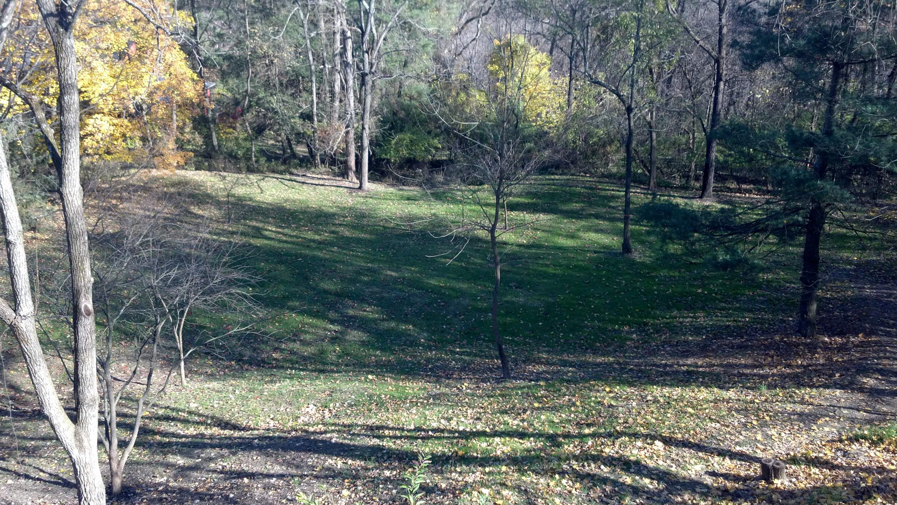

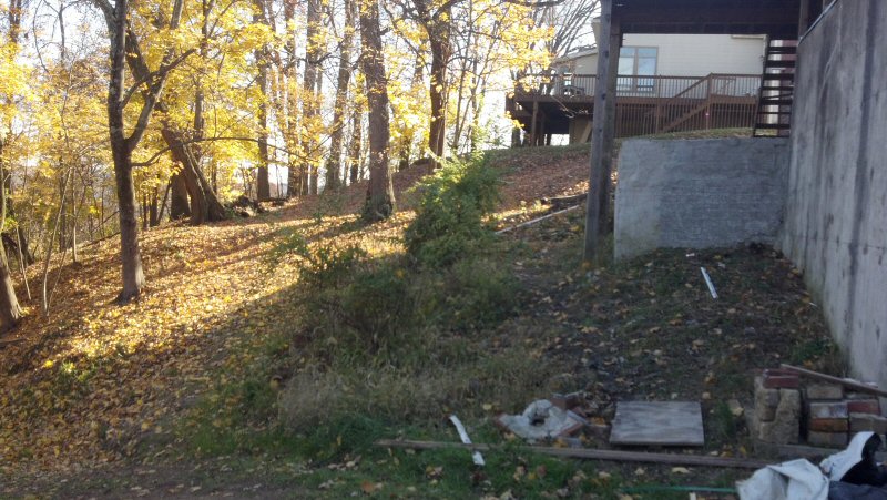

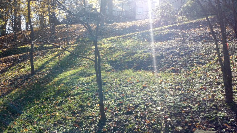

...Whether its me or the tractor that gets broke on the slope is another question. ...
A lot of 20 degree slopes and several 25 and 30 degree sections....
Those pictures tell a story. First thing I notice is you aren't trying to keep a manicured golf course lawn on a hillside. That's good. You can be a little more flexible about when and how you mow it. No doubt you only mow when it's fully dry. Any mower would be sliding all over if it was wet. And you can mostly go up and down, probably not a whole lot of side-slope mowing, which is also good, because those slopes are steep enough that they are really in Steiner/Ventrac territory if mowed sideways. Your place is also compact enough that if there are a few really inaccessible spots, you could handle them with a few minutes of weed eater or push mower time.

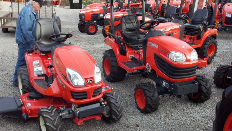

If you go for the tractor like the BX models, which I tend to prefer, keep in mind that the heavier weight means your body won't make that much difference in keeping all 4 wheels on the ground. The thing needs to be stable on its own, not because you're hanging off of one side.
One reason I favor the sub-cut type tractors is the much more robust drivetrain, particularly the transmission. They'll have a low-range for heavy pulling, such as when you're lugging stuff up that grade. Just my opinion, but that would probably mean they'd tolerate those hills over the long term somewhat better as well. At least with the sub-cut type of equipment, many people regard the hydrostatic transmission as an advantage on hills since there's no shifting or clutching, which can lead to loss of control.
