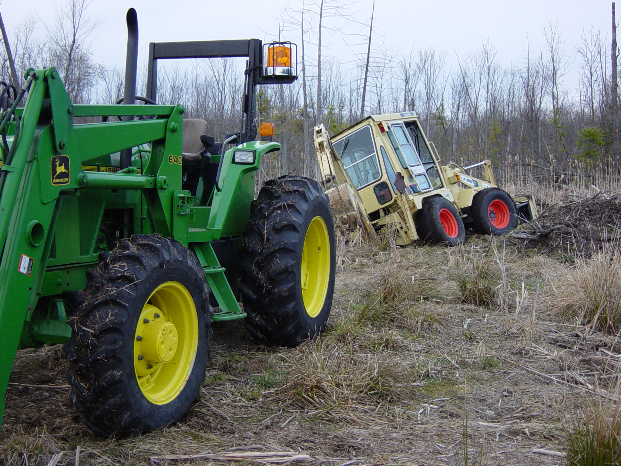

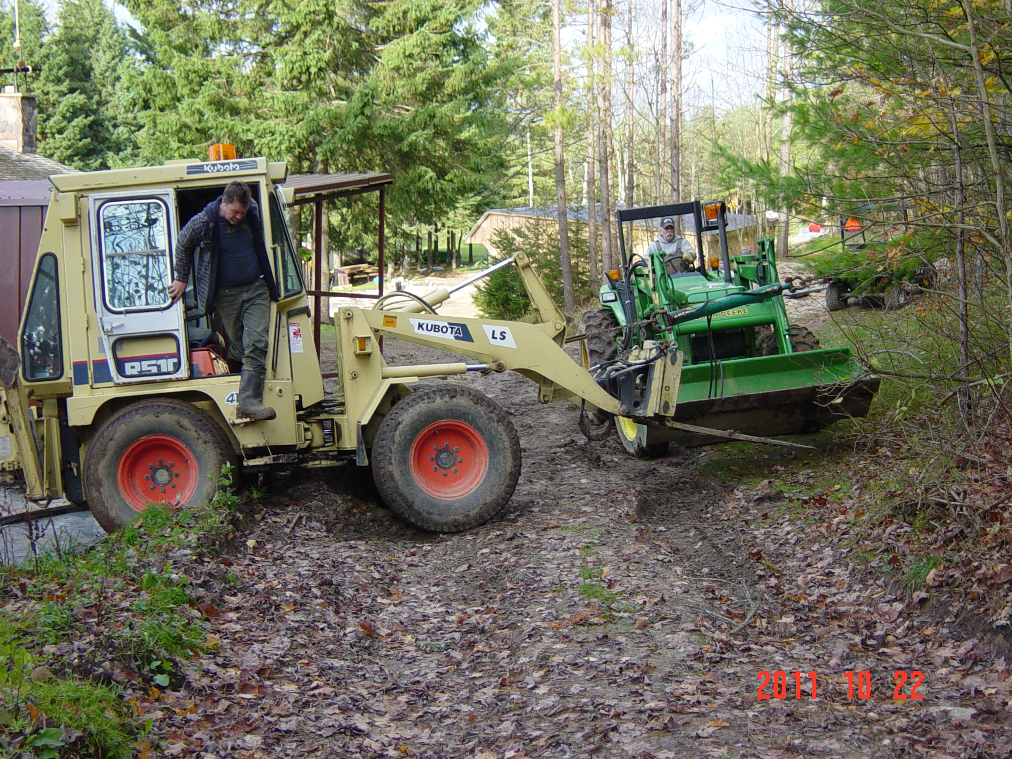

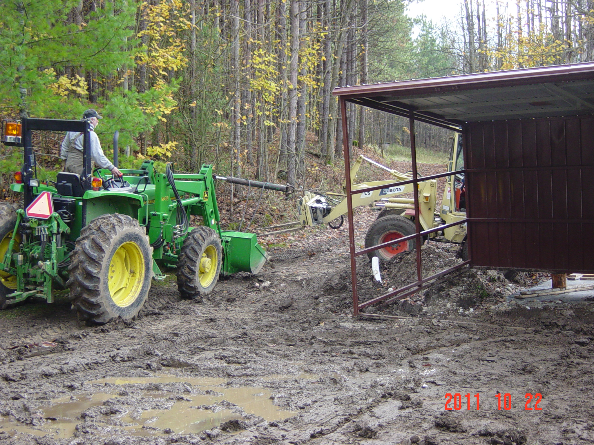

You have great control over a cylinder. I have used it to straighten bent equipment, and even move a small concrete foundation that wasn't quite poured in the right spot.
After moving this building, I boxed myself into a corner and the turf tires were useless.
The good thing is, if you don't really care what size a cylinder is, they are easy to find used.
