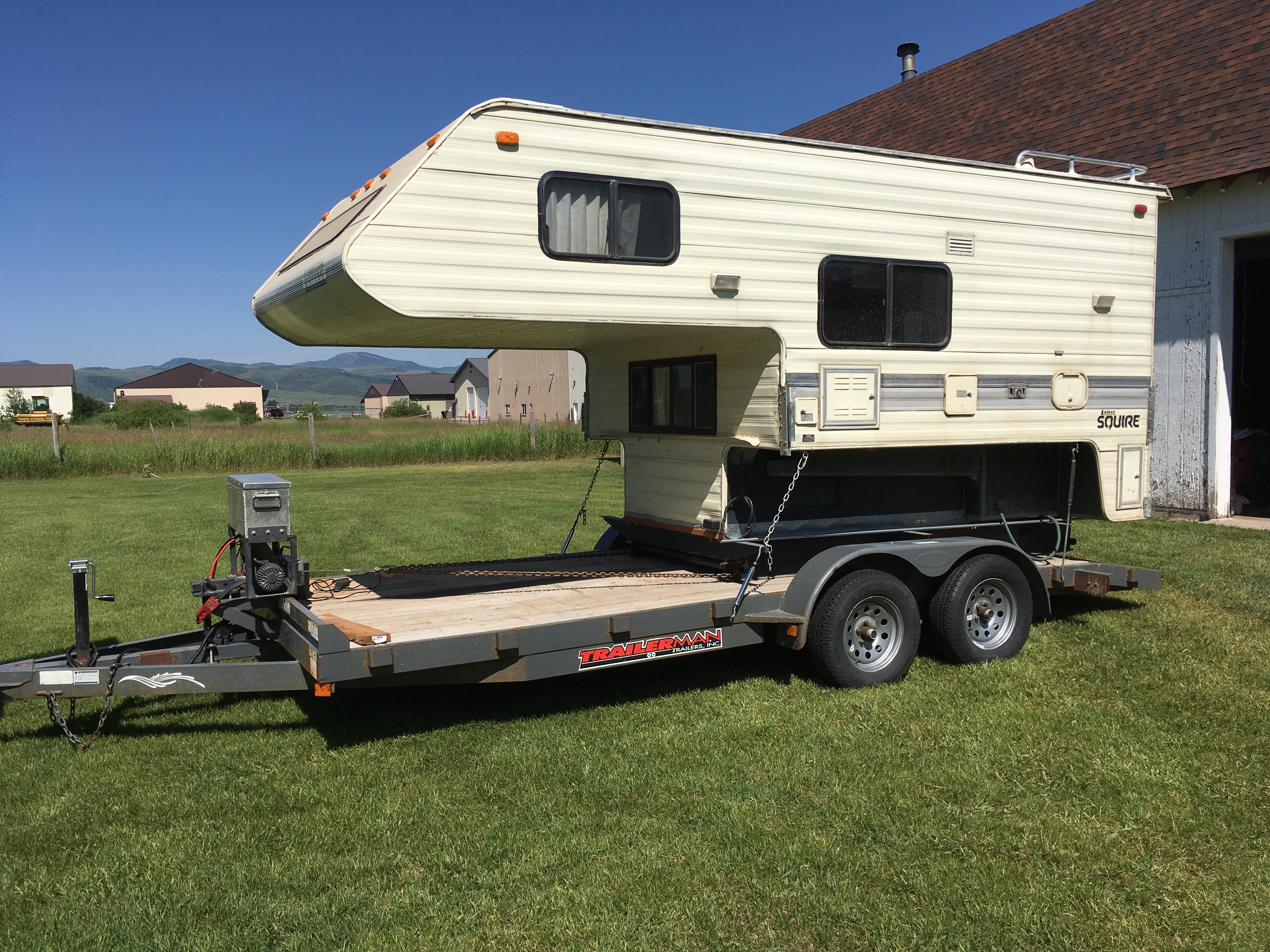

When I built my setup it was mainly to load a cabover camper on my car hauler trailer as shown but I also wanted it portable so I could move the winch to my pickup or tractor or even to loan it out without loaning my pickup/trailer/tractor out with the winch. I choose the Warn 9000# winch due to it would still pull 7,000#'s with 4 layers of cable on the drum and it handled at least 100' of cable which was plenty for my anticipated needs. So far I haven't had to double the line.
Once you decide what size winch you want just watch around for used ones coming up for sale. I bought mine for $600 which included the winch, cable and roller fairlead then I built the carrier and battery box so it fit my needs. Good deals are out there if you watch for them.

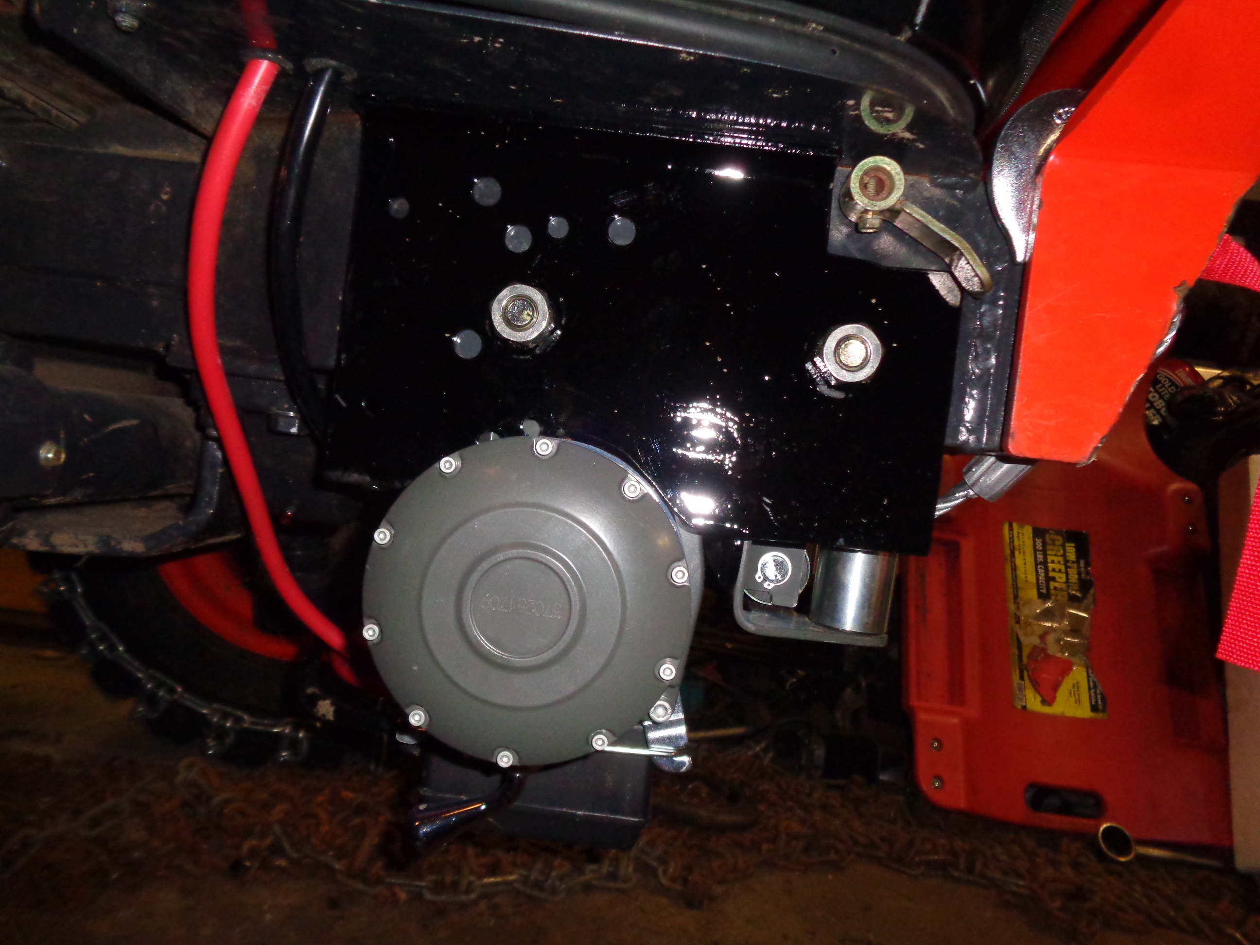

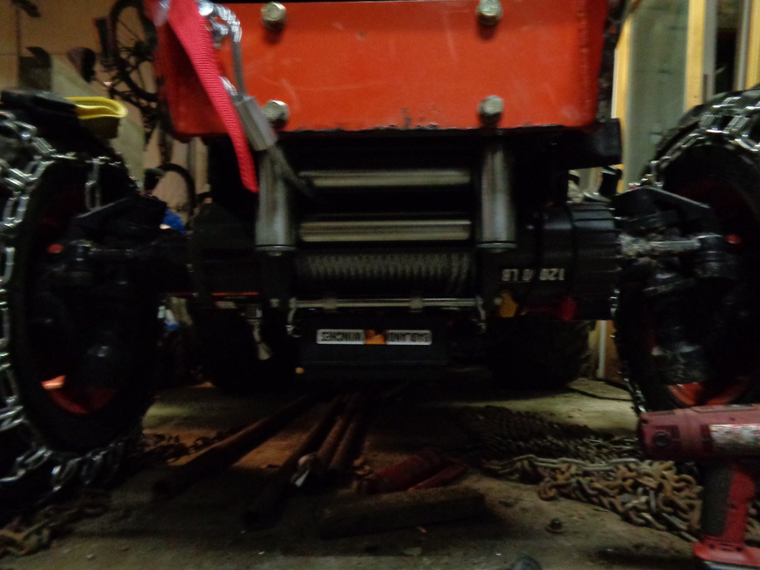

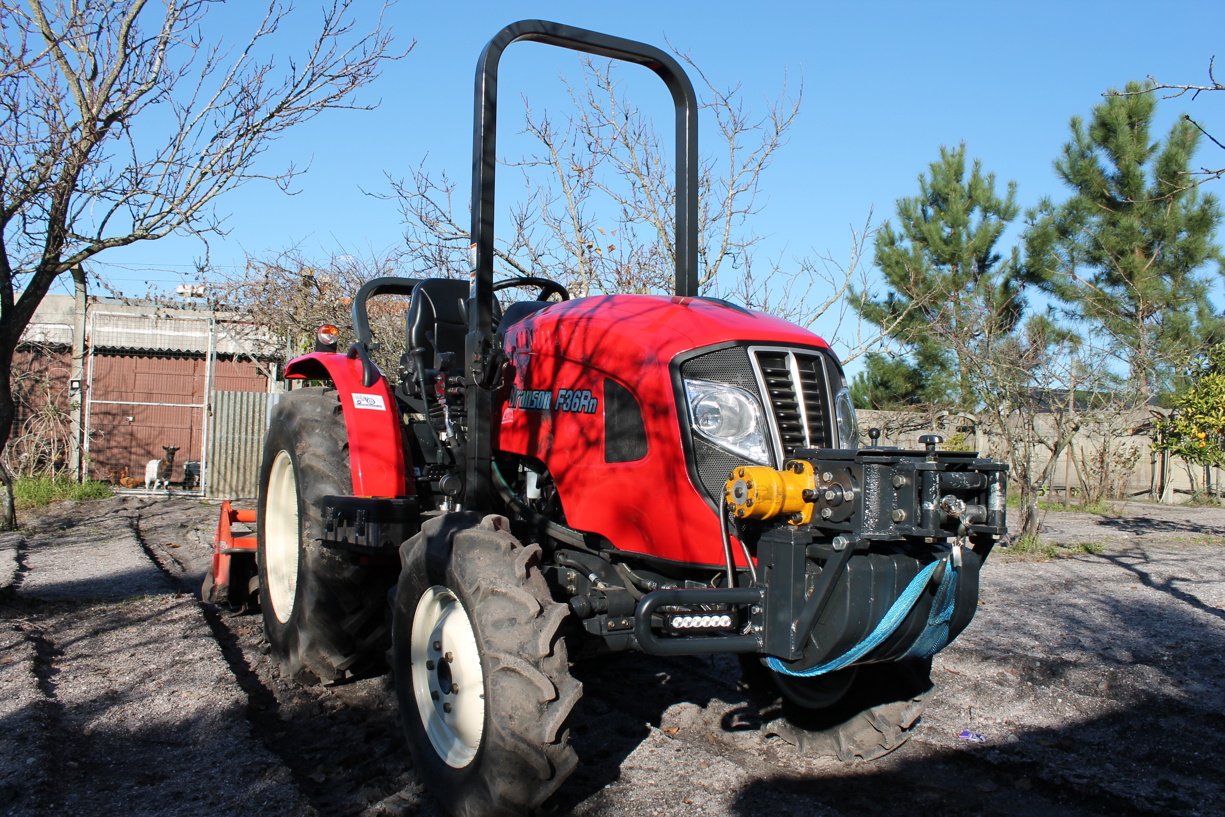

Here's my front 12,000 pound winch on my NX4510HST. The mount is a standard pickup truck mount from Harbor Freight that I modified to fit the side mounting holes already in the frame on my tractor.
Looks like a nice installation. I assume the battery is up front on your Kioti, which makes for nice short cable runs as well.
Are you finding you need to guard it to prevent debris from poking at it, or does it have enough ground clearance that that is not an issue?
   / Looking for a winch for my tractor #59
My battery is right above the winch. I do need to build a guard for the winch. Right now I am being extra careful where I go. I have 10 inches of ground clearance right now. This summer I hope to move the lower control box to a much safer location. That will give me another 3 inches of ground clearance. Then I will build a suitable guard for the winch.
