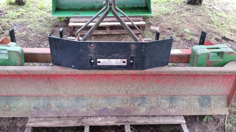

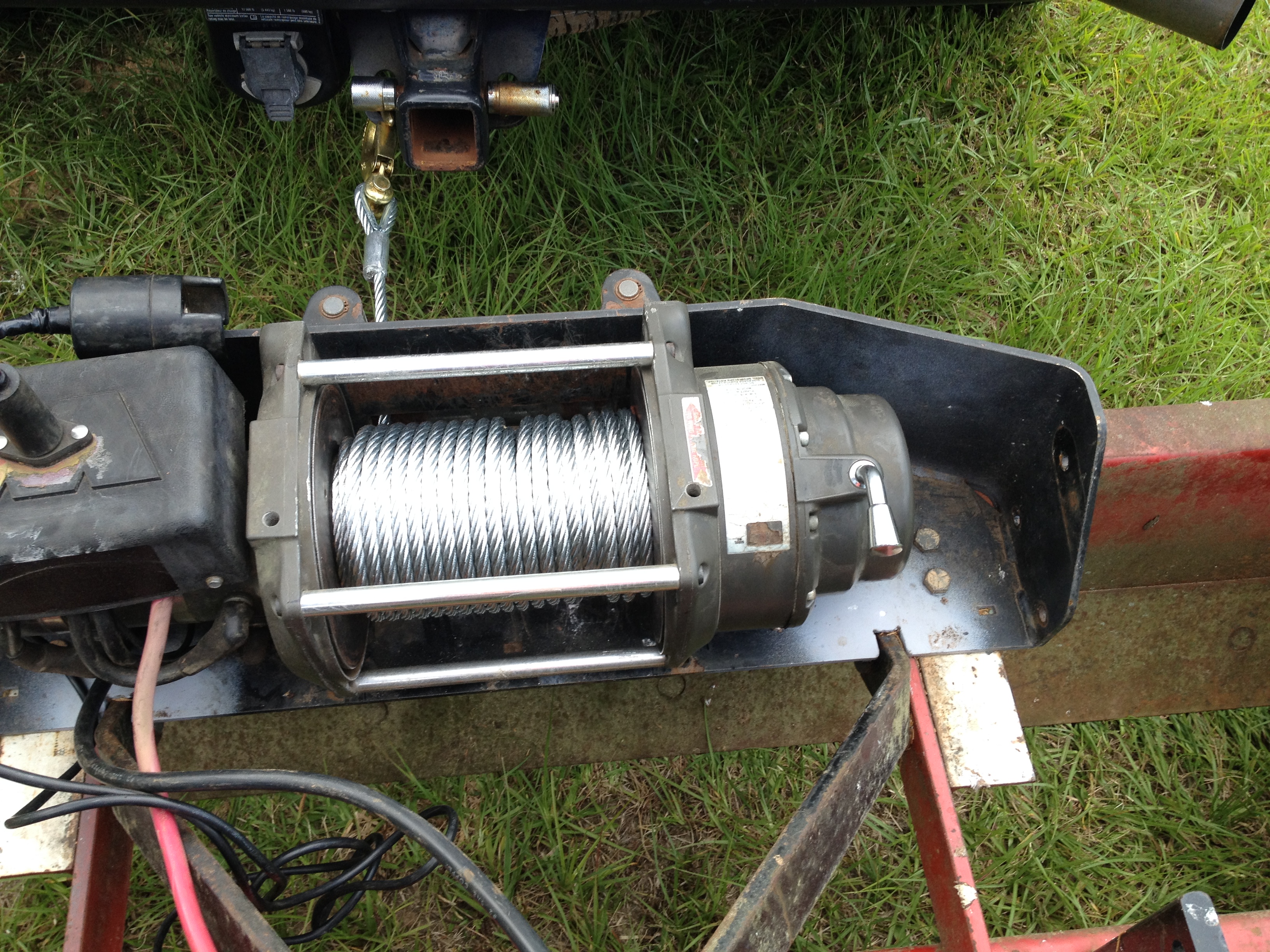

I used a Warn M1200 Electric Winch and Bumper mount and attached it to my box blade which hardly gets any use. It is a beast, with the box blade tilted and on the ground it will pull my 8K lbs crew cab up a slope with the tractor in neutral.
:laughing: Just occurred to me this solution won't be of much use if you do not already have it mounted before you get stuck. It does make a good ballast.
Good Luck.
