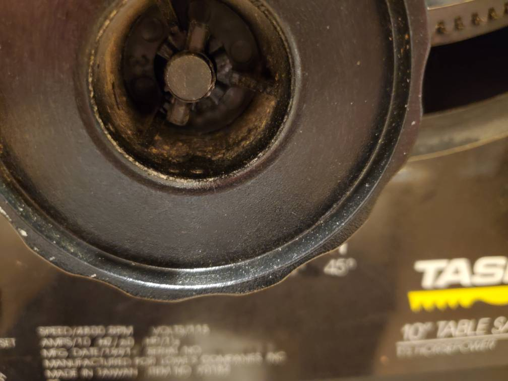

The first photo shows the blade height adjustment. To raise the blade a spring pushes the wheeI' back so that the roll pin catches between the little bumps around the shaft and spins a threaded rod that raises the blade. The bumps have worn down or broken off and now I can just pull the wheel back enough to make it work. I might rebuild the bumps with some liquid steel type product but think building a crank to fit over the roll pin would be more of a sure thing.

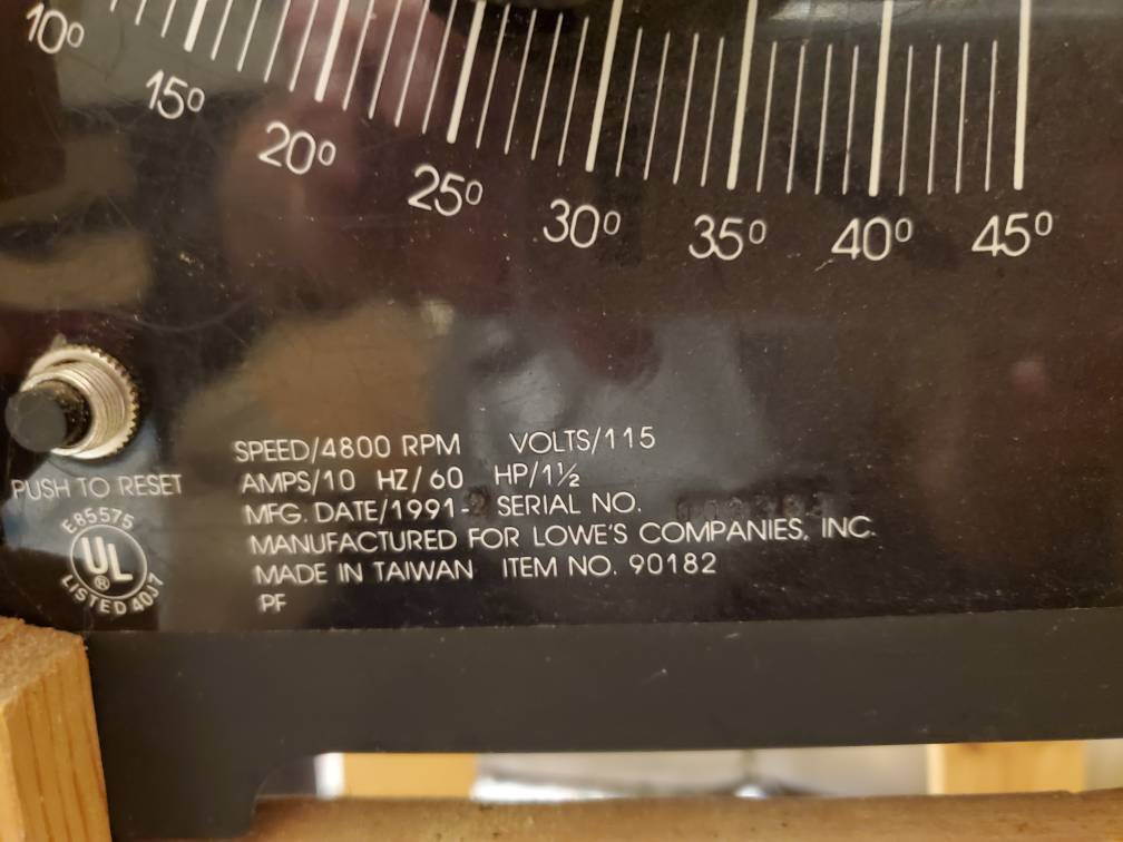

Peter,.
The additional photos are only because you seemed interested in the mechanism. The model number could be hidden under the homemade legs. The wooden "knob" on the wheel works fine, the center hole is probably too big because I was in a hurry and used whatever bit was handy.

Thanks! That really helped. I was having trouble visualizing the dual functions of your knob, but I understand it now.
I can't find a parts source for it, sorry. Your idea of liquid steel seems like a good interim fix. If you are really attached to that saw, our could consider finding a knob that you can cut a slot in for the pin, and source a gear that you can weld/pin to your knob. Alternatively, you could drill out the existing pin engaging lobes and press in a new steel part with lobes or slots to match the pin. (Like half a Lovejoy coupling)

Two good ideas! I hadn't thought about drilling out a slot. One would probably do the job and could probably be done without removing the wheel. That roll pin looks like some disassembly will be required to punch it out.

Searching for that saw number about the only thing I can find is people buying that saw used, then asking where to get parts or manuals. No luck for any of them.

Looking at your photos, I was guessing (hoping?) that the rod comes loose somewhere inside, unless you can press the knob in enough to get the pin to clear the knob, which seems awkward. It is a rare machine that is designed for service and repair in my experience.
