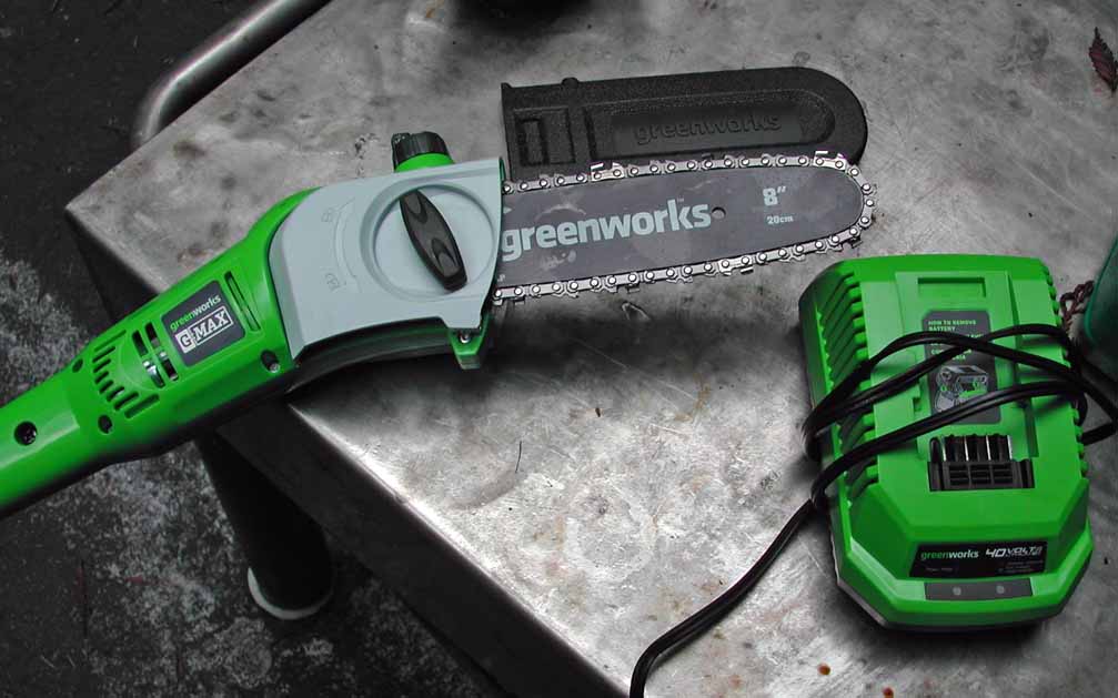

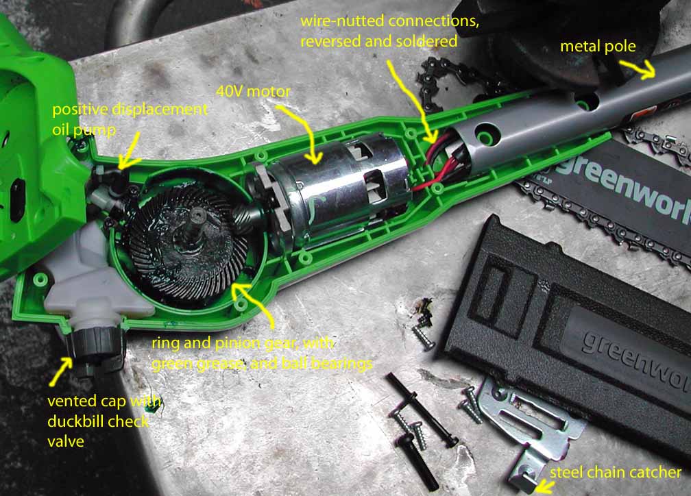

However, I did have a problem right out of the box! It ran backwards. Not one to return things
easily, and wanting to see inside anyway, I opened it up and reversed the wiring. I decided to
open the motor end, as I knew I could reverse the wiring in there, even if that was not where
they got crossed up. That could have happened inside the trigger end, or inside any of the
pole segments. The pole segments are riveted together.

Here is what the Greenworks 40V polesaw looks like inside. Overall, it seems well-made.
I like the use of ball bearings on both ends of the ring gear shaft, and a decent amount of
green-colored grease. The pole is metal, as is the chain-catcher. The only nit I see is
that the power wires are twisted together with wire nuts. I reversed and soldered them
before replacing the wire nuts.
So far, so good. I hope the ring and pinion gears hold up. They look OK and mesh well,
but I do not know the quality of steel used.
