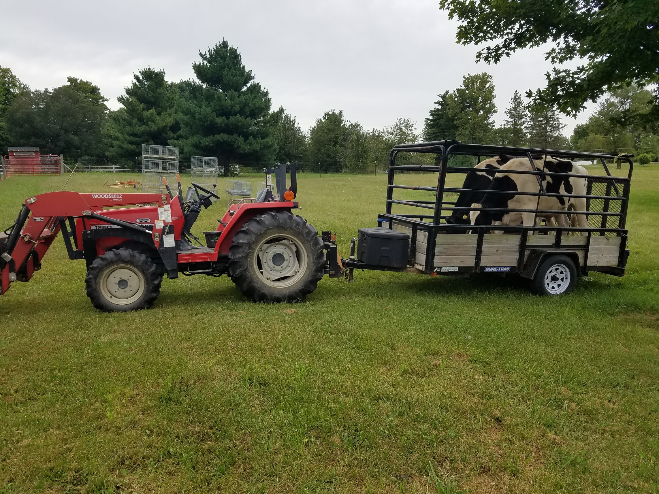

I-69 Trailer Center is a retail shop fur Sure-Trac trailers. They'll custom make a trailer for you from the factory. I have a stock 5'x10' with high sides (it wouldn't dump like you need), that I've used about once a week for 7 years with no trouble. I have a cage that I use on the trailer to trasport livestock (normally sheep). I use it for moving anything that I don't want to put in the family van. We annually take it on 2,000 mile vacation trips... no problems. I push it around in thedriveway by hand.
I plan on replacing it with a single axle tilt bed equipment trailer with stake sides. Single Axle Tilt Bed Equipment Trailer

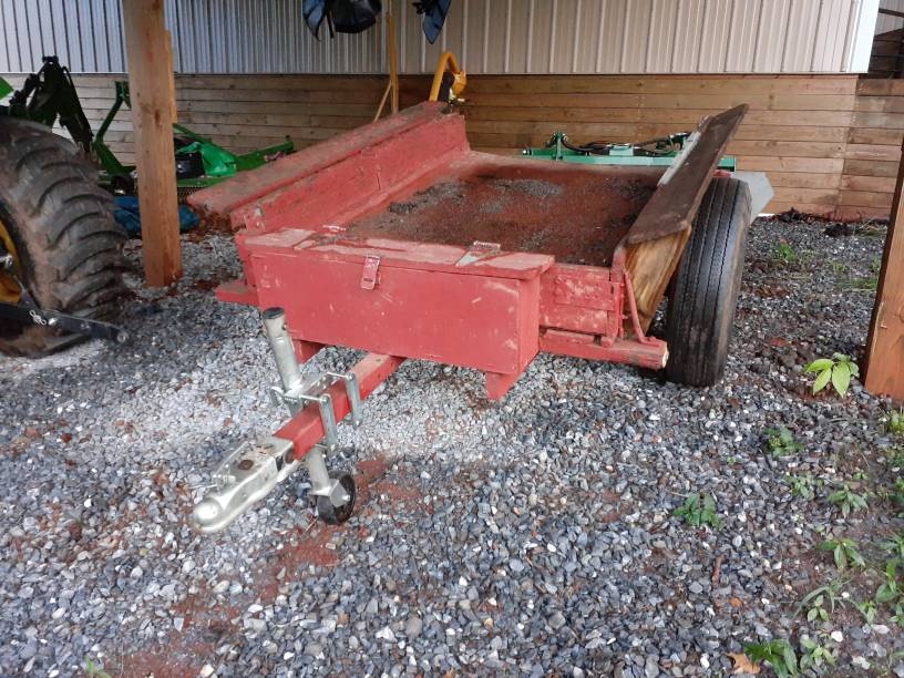

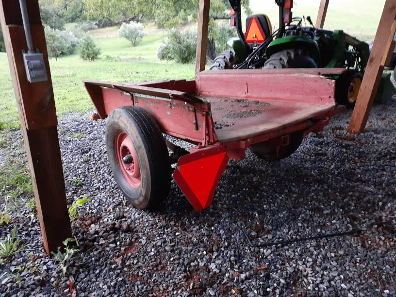

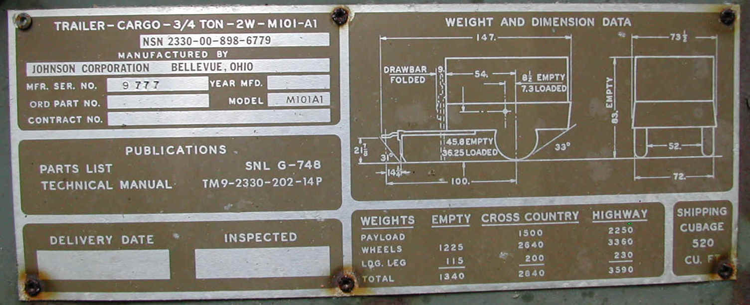

Army trailer?
Solid metal sides would contain a ton of stone.
Self contain surge brakes.
Separate mechanical brakes helps on farm.
Lunette hitch for better off road articulation.
Sideboards and canvas enclosure option.
I dump with the tractor. Some folks modify to dump mechanically.
Tow nicely on the road. Handles a full load of mulch to top of sideboards. Brakes are important.
Cheap. $500 years ago with 4 sideboards and full enclosure canvas. No rust. Had to wire for lights.
HD 16” wheels.
Some models have aluminum beds and run flat tires.
I was under the impression that these military trailers have a built-in dump feature achieved by setting the wheel brakes and then backing up to tilt the bed and dumping the load.

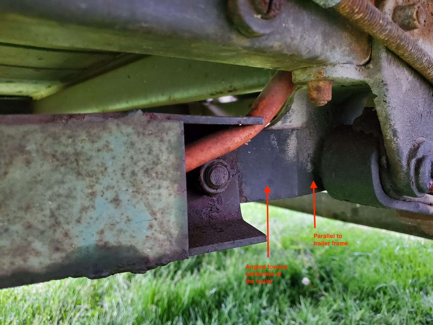

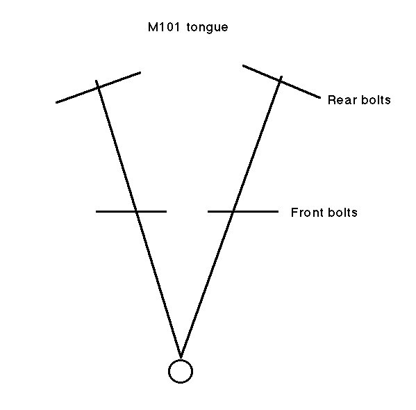

They have a folding tongue to reduce shipping size. It gets unbolted at the rear of the tongue at the spring hanger, then pivots upwards at the front of the box.
The "dump" feature, unbolts the tongue at the front of the box and pivots at the rear of the tongue. But the bolts at the rear of the tongue are not in line, and dumping twists the tongue or the spring hanger. One will eventually break.
Bruce

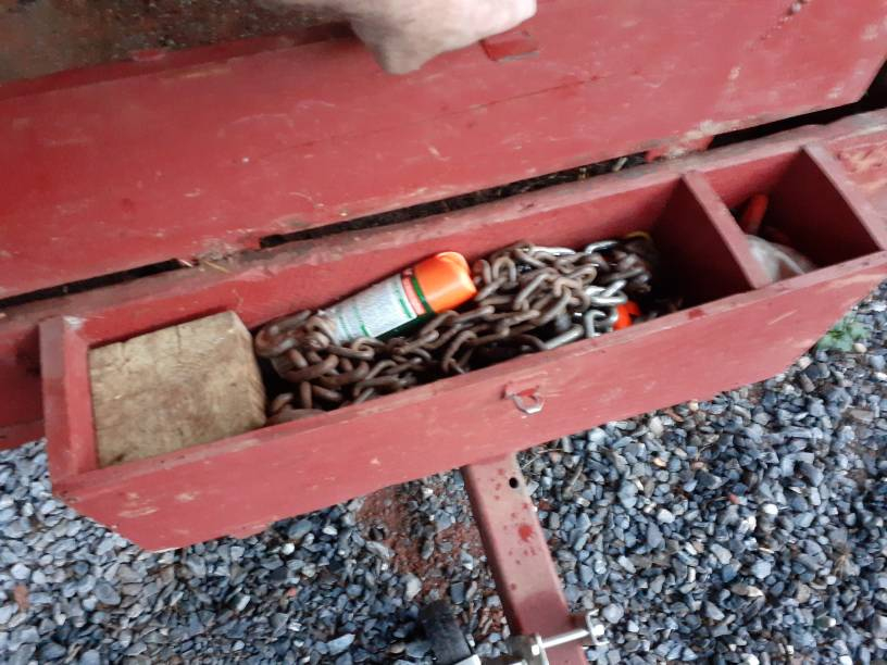

Using the FEL to tilt or dump the military trailer works for us. Don’t think a regular trailer with ball hitch would survive long.
Having brakes on a off road trailer or farm trailer just makes sense. Can move to a pile of compost, mulch, or firewood, set the brakes and disconnect. Use the FEL to load. Reconnect and go. No chocking required. Can move lot of materials fast. Use the trailer brake to lock a wheel to skid a trailer tire when negotiating slope terrain. Pushing the trailer down hill instead of just relying on the tractor brakes to hold back.
Having the trailer out front helps getting in/out of tight places.
The wheels maybe the same bolt size as my truck for a spare?? Never tried. Like the larger tires for the farm.
Had to study some to get a model that had the surge brakes, mechanical brakes, side boards and swing down crank jack stand options I wanted. Added armored led taillights to withstand farm, woods and dumping use.
