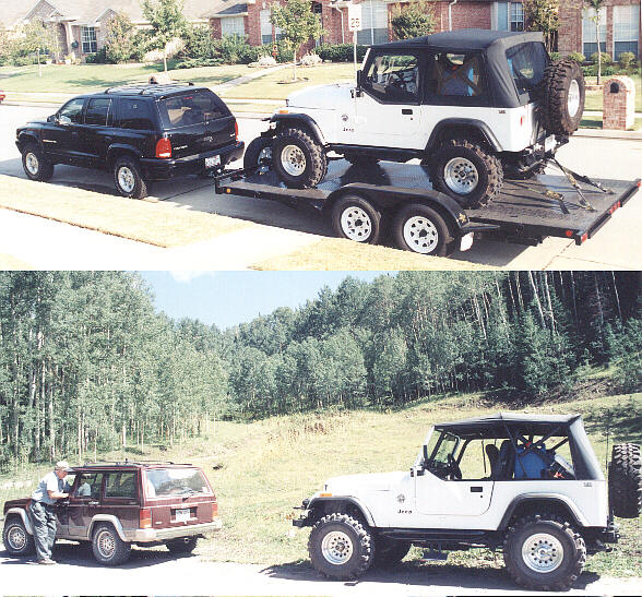

That is similar to the one I just bought. Mine is a 2001 I bought used for 1,000 bucks today. It has a steel deck and is very heavy duty.
